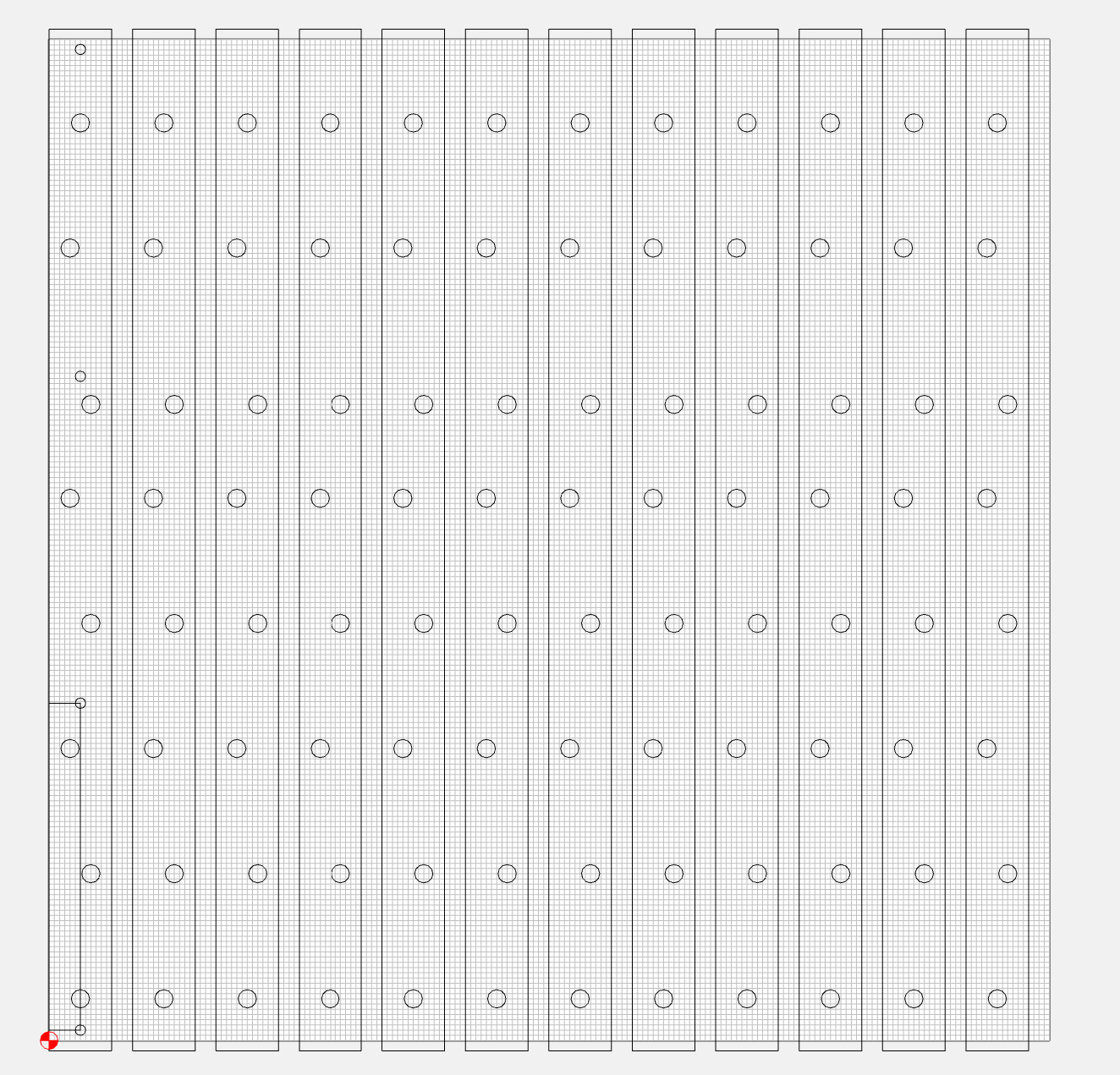

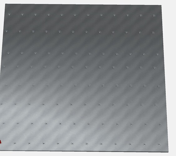

OK…I put 96 M6 T-Nuts into the underside of the slats (8 per); staggered the configuration, so that there’d be a variety distances. Simple procedure of flipping over the 12 slats, attaching them upside down with M6 30mm bolts, running the job, hammering in the T-Nuts, and reinstalling them right side up.
Now my hybrid table has an additional 96 attachment points for clamps - a true hybrid. Very happy with the outcome.

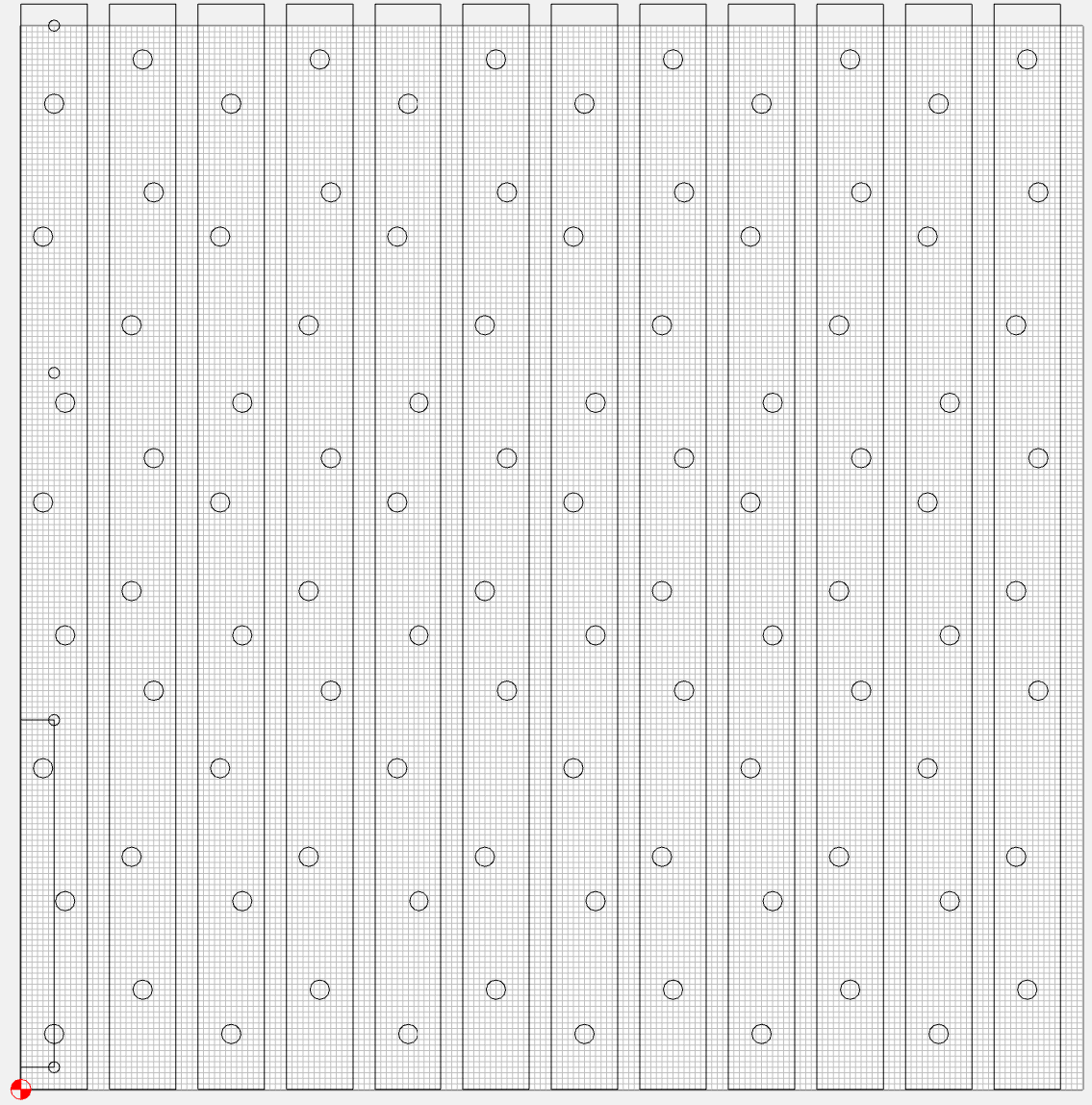

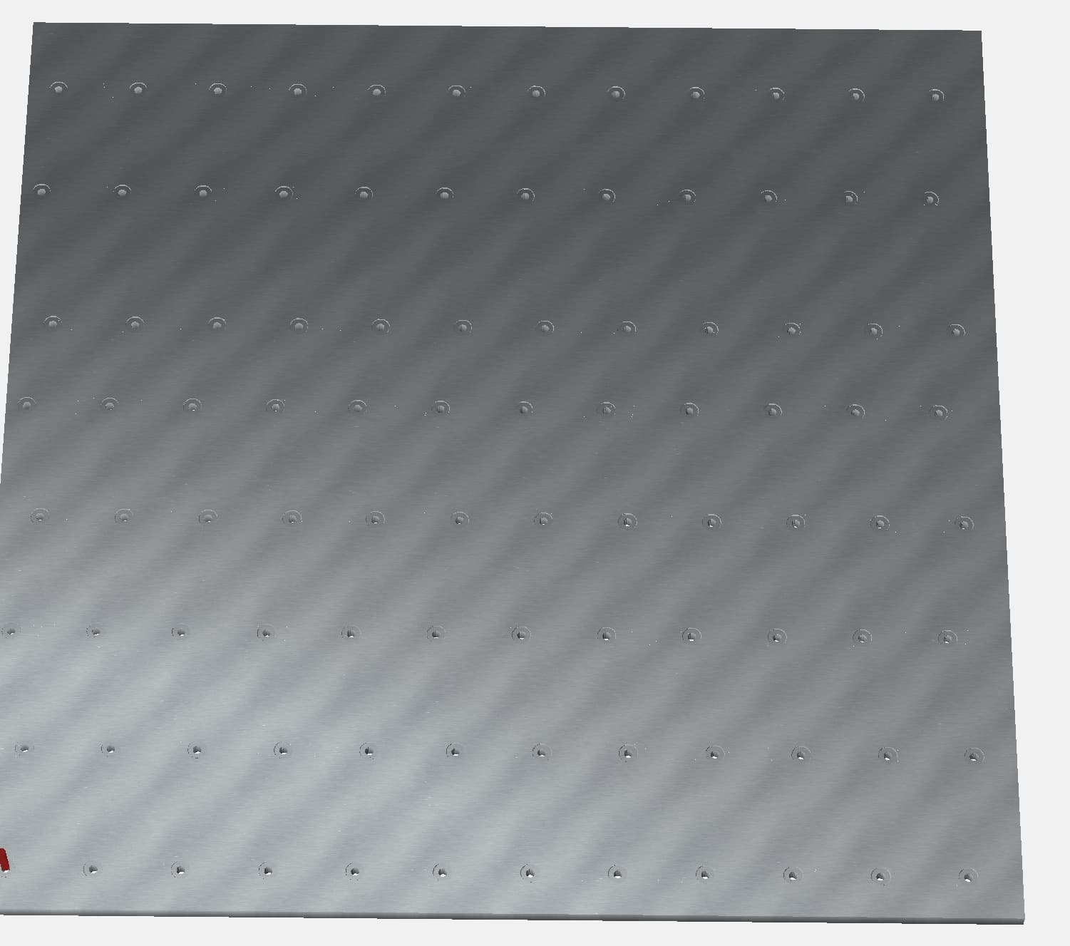

FYI: I actually ended up orienting the slats by alternating them top to bottom - this way the offset holes would provide more distance options. So it looks like this now:
Kind of looks like a hodge-podge…but it’s proving to be extremely functional this way.
