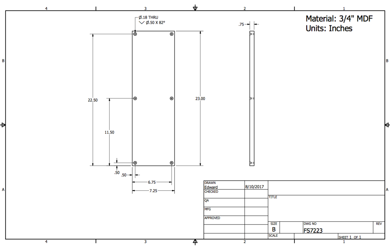

So - perhaps a crazy mash-up, but has anyone created a Myers Wasteboard layout specifically for the Carbide T-Track Kit for those of us who want the best/worst or both worlds?
Baring someone else being that crazy, are the t-track set design vectors anywhere?

Here is the specs from the site: https://docs.carbide3d.com/assembly/t-tracks/
They have zip files for the different sizes in the above link.
I did the Myers Waseteboard on my XXL t-track system. I unscrewwed the three main panels, flipped the three pieces. Make sure to do a full flip as if it were one piece. This means left flips to right and right flips to left and middle flips in the middle. I then measured out where the t-tracks would be and eliminated two columns of thread holes. Once it was all carved, i put the t-screws in and flipped back to the correct places. It then gives me the best of both worlds. T-tracks work, and t-scews are there.
