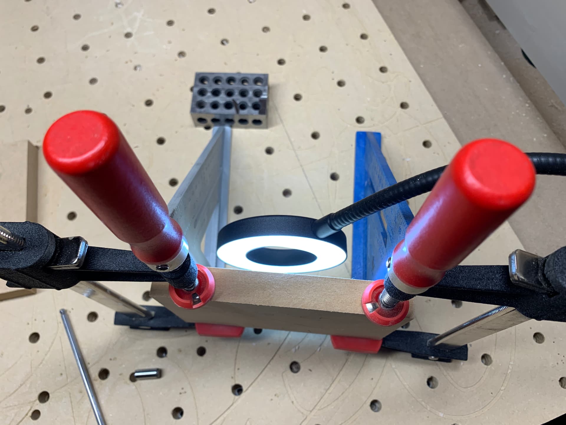

Hi - I hope this isn’t a repeat; I’ve not been able to find exactly what I’m looking for in the forum.
I’d like to cut 1" thick hardwood with narrow (1/8") contours, along gently curving paths (see example photos). I’m planning on making projects that match different stock with the same curves, and the pieces mate more accurately the smaller the diameter of the end mill. I’ve managed to locate longer end mills but recently have seen cautions against making these types of cuts.
If anyone could please let me know how to go about this prudently, I’d very much appreciate it.
Fyi, these pieces were made using the Shapeoko pro, and using the 1/8th inch Carbide3d end mill. This stock is about .7 inches thick beech, but will end up using 1" thick pieces in the finals.

If you’re shooting for a high tolerance fit, then make 2 shapes with the same curve copied.
Relying on the width of the cut, you are getting an offset curve on the other piece no matter the size of the tool. With an 1/8" cutter you could get away with cutting a ~3/16" groove and the pieces should bit a lot better.
If this is the shape you want to cut
Copy the curve and place it 3/32" on either side of that curve. MOVE it 3/32, don’t offset it.
Now you can cut the center line to full depth, with smaller DOC. This is your roughing pass for both sides. Then contour/profile the other 2 curves at full DOC. Your only removing 1/32" (0.031") so you should get a nice smooth cut. And you’re only losing another 1/16" of wood.
You could even join the ends & cut it all at once.

Ok. I get that if you’re using a bandsaw. I’m a Visual person so I had to test out my thinking. I made two identical boards and labeled the left and right. Made
my toolpath and offset it 0.025” on either side for my rough and finish passes. As I said before as long as the inside radius are larger than the radius of the tool being used they should fit together. Here are some photos of my findings. To me they fit together pretty darn good.
Here are the remaining photos
Thanks for sharing that test; it brings up a good point which is I’m really new to this whole thing, and I’m still trying to get my head around it. If you don’t mind, does the pink line represent a rough cut and the blueish line indicate a final cut? Is the process you used similar to that shared by Tod1d, such that the vector is duplicated and moved over rather than offset? Sorry, but I’m really just getting started, so this is all probably pretty basic for most folks. Thanks in advance.
I think what tod1d is suggesting is if you are trying to cut one board in half with the curved line and put it back together. Maybe I’m wrong idk. The pink lines are the the actual contour I want the machine to follow and with an offset not a move like tod1d said. The blue lines are what side the endmill will go on. When you see the blue line on the right it’s actually cutting out the left blank and vise versa.

Yes. If I understand what Paul is saying. He has 3 curves. the original center curve is the design curve, and the tiny offsets to either side are for the roughing passes. For the left piece he uses the right rough curve, and the center curve to finish. Then for the right piece he uses the left curve for rough, and the SAME center curve for finish.
The caveat here is he needs to move the right piece after cutting the left piece, or start with 2 separate pieces. Whereas WP was trying to cut both halves from the same board with as little loss as possible.
If it helps, think of it this way, cutting each side independently, but without moving anything.
So for each side I rough using the pink curve, and finish to the black curve.
Now just move them closer together to reduce the gap to just a little bigger than the tool width + rough stock. i.e. 1/8" tool, 1/32" rough stock. Total width 3/16"
