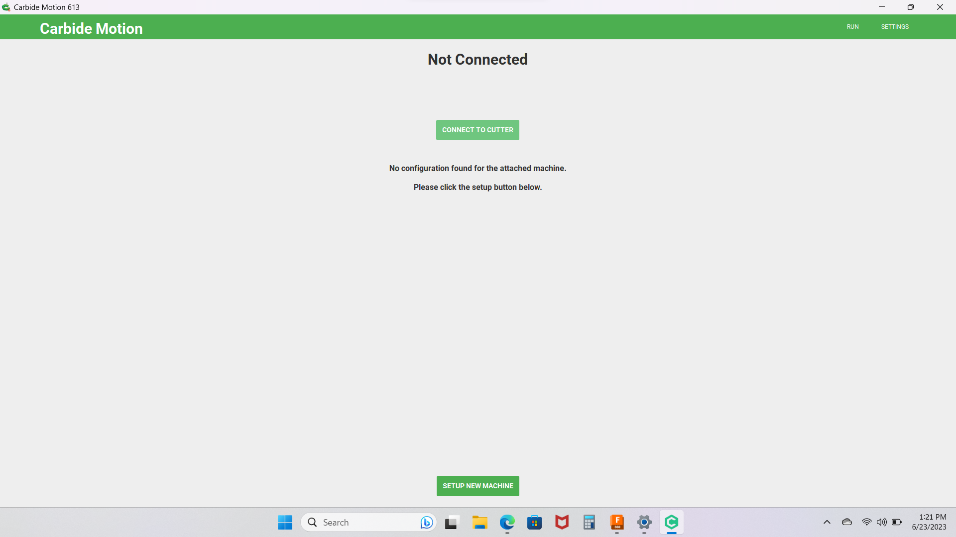

Need earlier version of Carbide Motion (pre 613) for Nomad 883 on Win 11
Carbide motion 613 does not work with my nomad 883 on my win 11 machine. After the initial setup, I get a confirmation that setup was successful, but on selecting “finish”, I have to do setup all over again. It’s stuck in this loop.
I need to get some prototypes done TODAY. Does anyone have an earlier version of CM that I can try? Or suggestions to get 613 to work? I’ve already upgraded this machine to GRBL 1.1, so the V3 of CM will not work.
Here’s 582:
https://carbide-downloads.website-us-east-1.linodeobjects.com/cm/stable/582/CarbideMotion-582.exe
This worked perfectly! Thank you. Will this file remain available for future forum users? I spent quite a while looking for this file before posting… I can’t be the only one!
