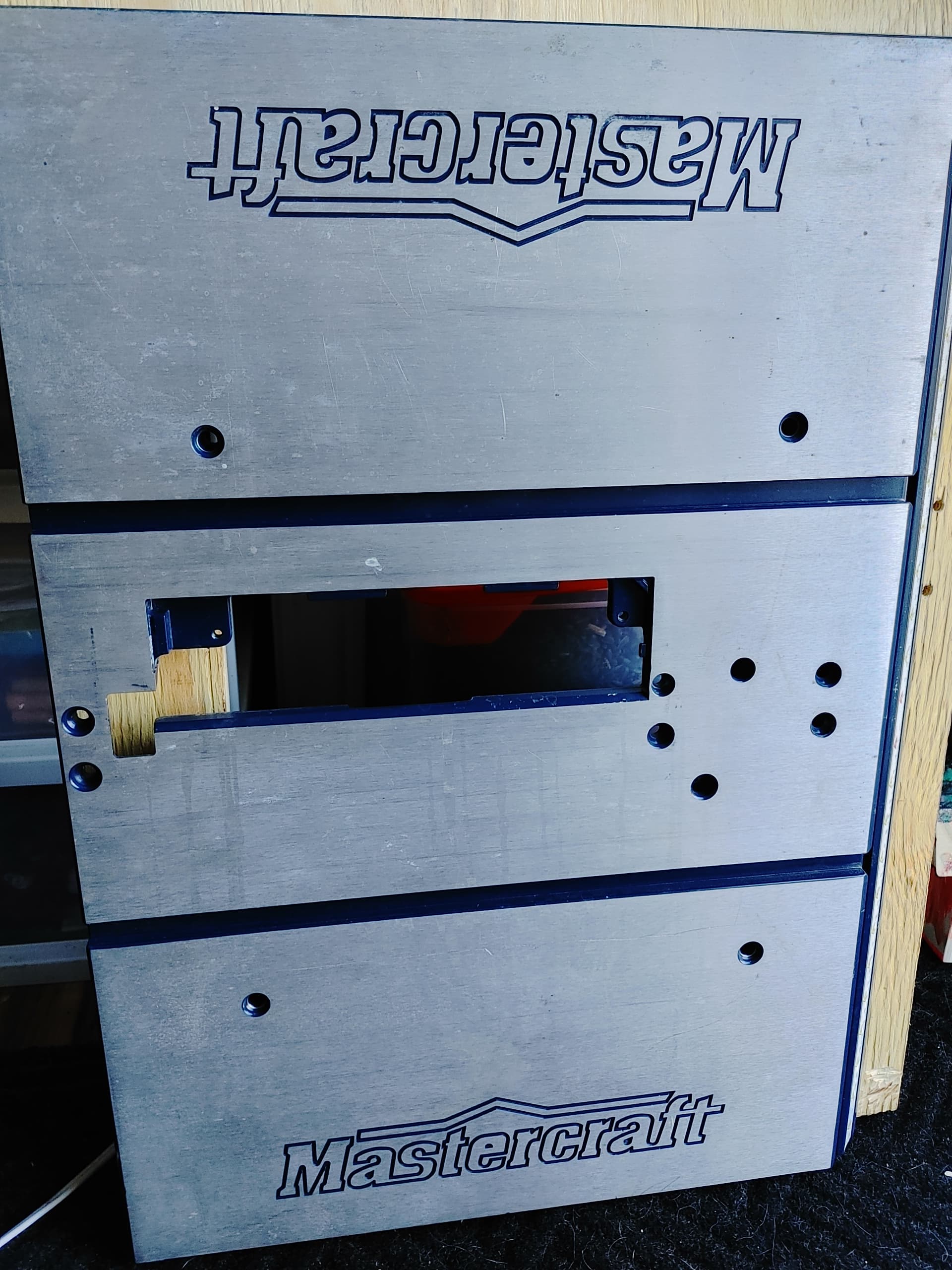

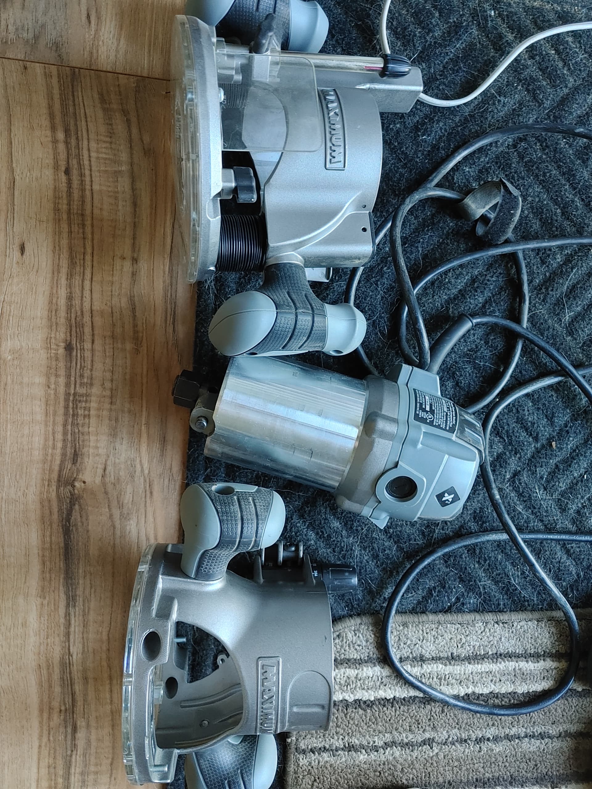

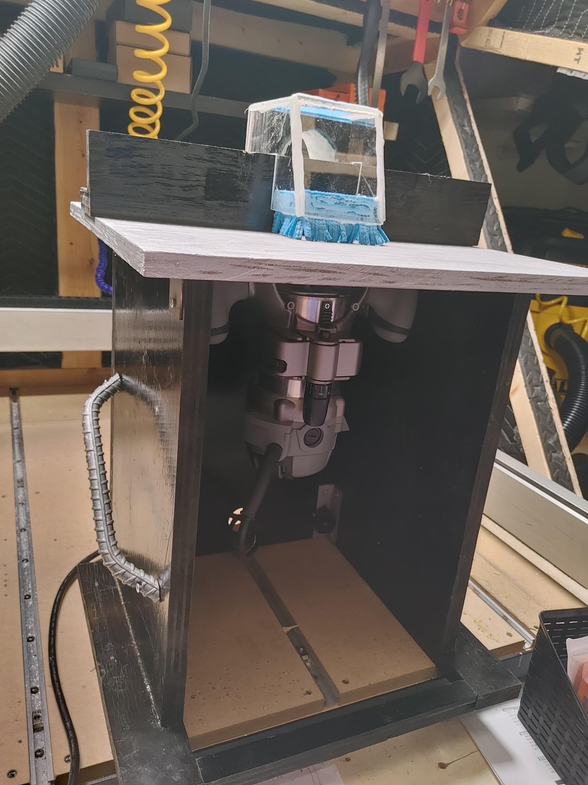

Appreciate you sharing your experience and insights, genuinely helped me a lot in making a decision. I strongly considered the variable speed 2 1/4 HP Dewalt router, that seems to be my best option but it’s $300 and I figure it’s going to be upside down having aluminum dust falling into it all day (might break fairly quickly) so it’s best to buy a cheap used one while I figure out my setup. I found myself delaying and researching too much and had to pull the trigger on something…
Sooo I bought a comparable used Mastercrap Maximum 2 1/4 HP router for $70, it sells new for $230 and looks lightly used, it’s a decent deal. Generally I don’t buy anything Mastercraft, it’s a terrible brand but the router actually looks like it might be ok. The RPM range is 11-20k which seems good. I’ll need to figure out a way to keep aluminum out of it when it’s upside down.
I’ve got a used table saw top that I’m going to try to convert into a router table. I’ll try to get it finished tonight. The nice thing is it has some threaded holes already for mounting but it’s not meant to hold the weight of the router so I might need to mod it and put a new top or something, not sure yet.
What you mentioned about tilting the router and doing a side plunge was actually a major concern for using that adjustable jig I linked. It made me reconsider if it will actually work well. It made me realize if I want to try that setup I 100% NEED the plunge attachment.
I think my best bet is to stick with templates for now, it’s not the end of the world to cut out a new acrylic template. Pretty fast actually. Eventually I’ll try out the jig but for now I’ll stick on the proven path.
Thanks for the bit recommendations, I’m going to place an order tonight. This bit in particular looks interesting: https://www.infinitytools.com/mini-mega-flush-trim-router-bits
Yea you’re right its designed for pockets but I figure if I leave an extra 3-4mm of material and try to center the workpiece, clamp the jig around it, then plunge and hug the outside edges of the jig it should give a good result. I’m not sure though, I’ve actually never used a router manually before :sweat_smile:
I’ll pass on the jig for now since I’d be inclined to make one and it’s a huge time sink. Gonna use templates it seems they get really nice results.

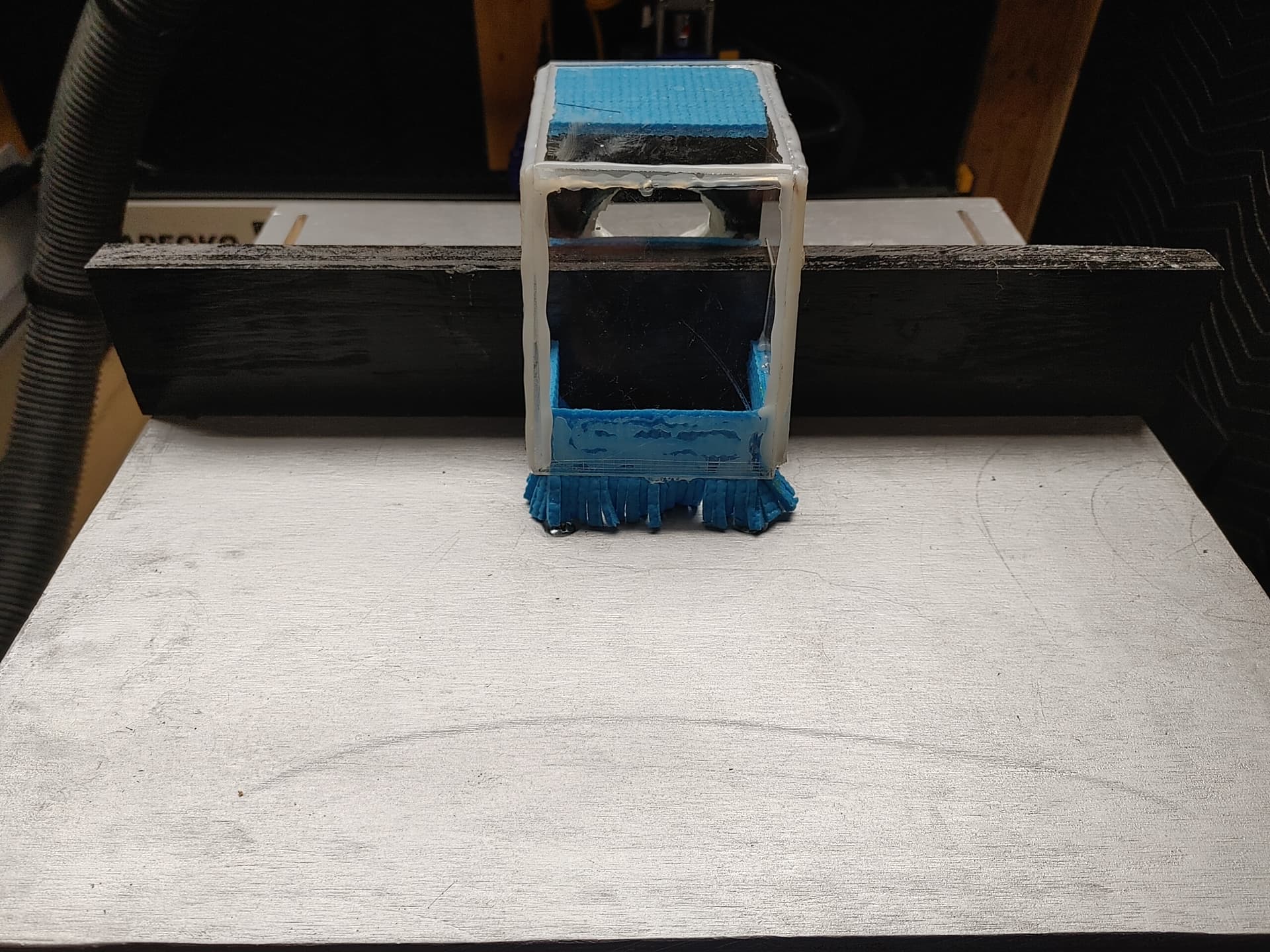

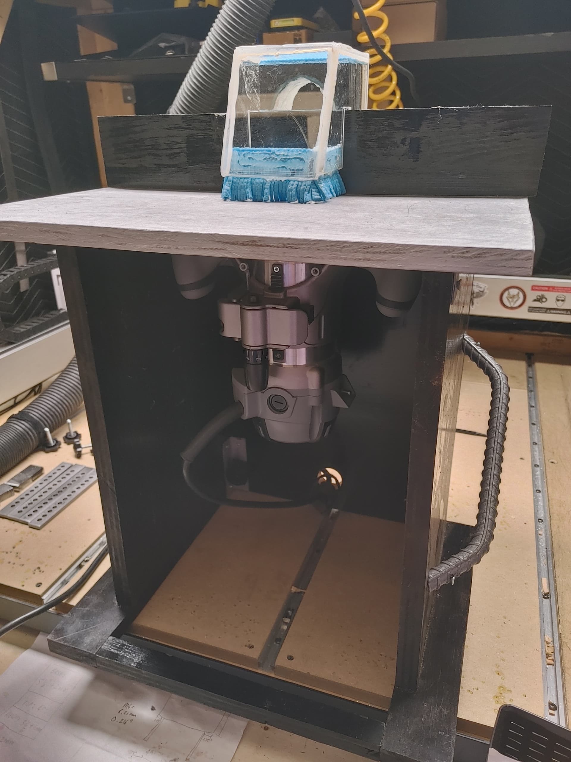

Here’s the router table I made. I’m going to make either a steel or 420 stainless steel surface plate and stick it to the wood with embedded magnets. The vacuum works well. Going to wedge a piece of foam in the hole with a slot for the end mill to go through, that should handle any dust issues.
Overall pretty happy with the setup except I made the table too high :sob: need to modify it and drop it down 6" to be able to comfortably use it in the shapeoko enclosure.
Good luck with the dust collection. Routers are notorious for spewing dust every where. Let us know if your solution works. The router has air flow from the top to the bottom of the router from the internal fan in the router. Some dust and chips still get into the router internal body but it is made for that. So between the air flow of the router and the dust collection it might work pretty well but over the many years the best laid plans of mice and men go awry.
