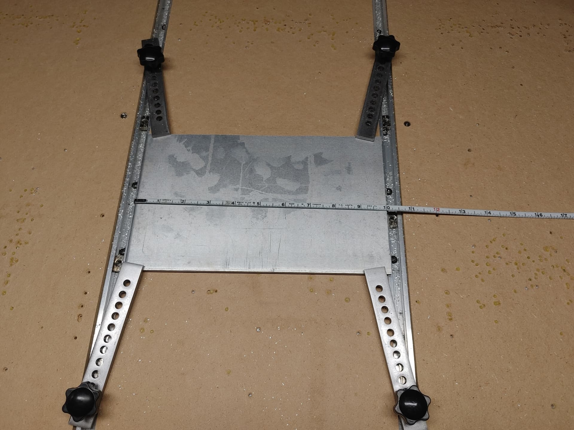

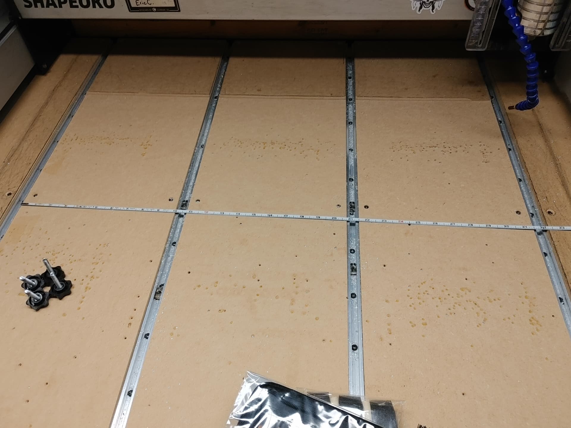

The second issue is fixturing them down securely. This is my current setup (pics attached). The clamps get in the way of the process. Should I use the super glue and tape method directly on the wasteboard? Should I make an aluminum wasteboard (slightly larger than my project piece) and secure it to that?

I wouldn’t tape directly to MDF though. You’ll end up ripping chunks of MDF up.
Use a sacrificial waste board if this is the case.
FYI, When you use hold down clamps, you want the screws as close to the workpiece as possible.
You are getting very little leverage in that picture above.

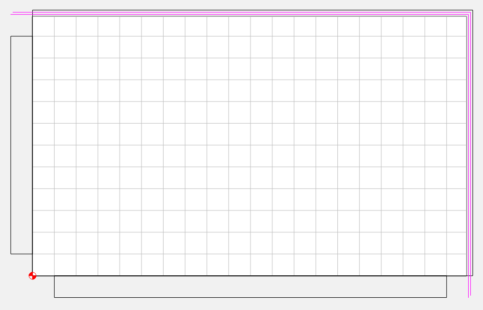

Make a fixture that is 5.950 x 9.950, with a fence on the front & left side. Cut a scrap piece of something rigid to use as a hold down on top of your workpiece a little bit smaller, say 5 x 9, and clamp that from the front & left.
Make a contour path that cuts the right & back edges down to 6.050 x 10.050.
THen flip the part 180° and use another path the cuts it to the finished 6.0 x 10.0.
Cut all your pieces to the 6.050 x 10.050 size so you keep using the same program. Then cut them all to the finished size.

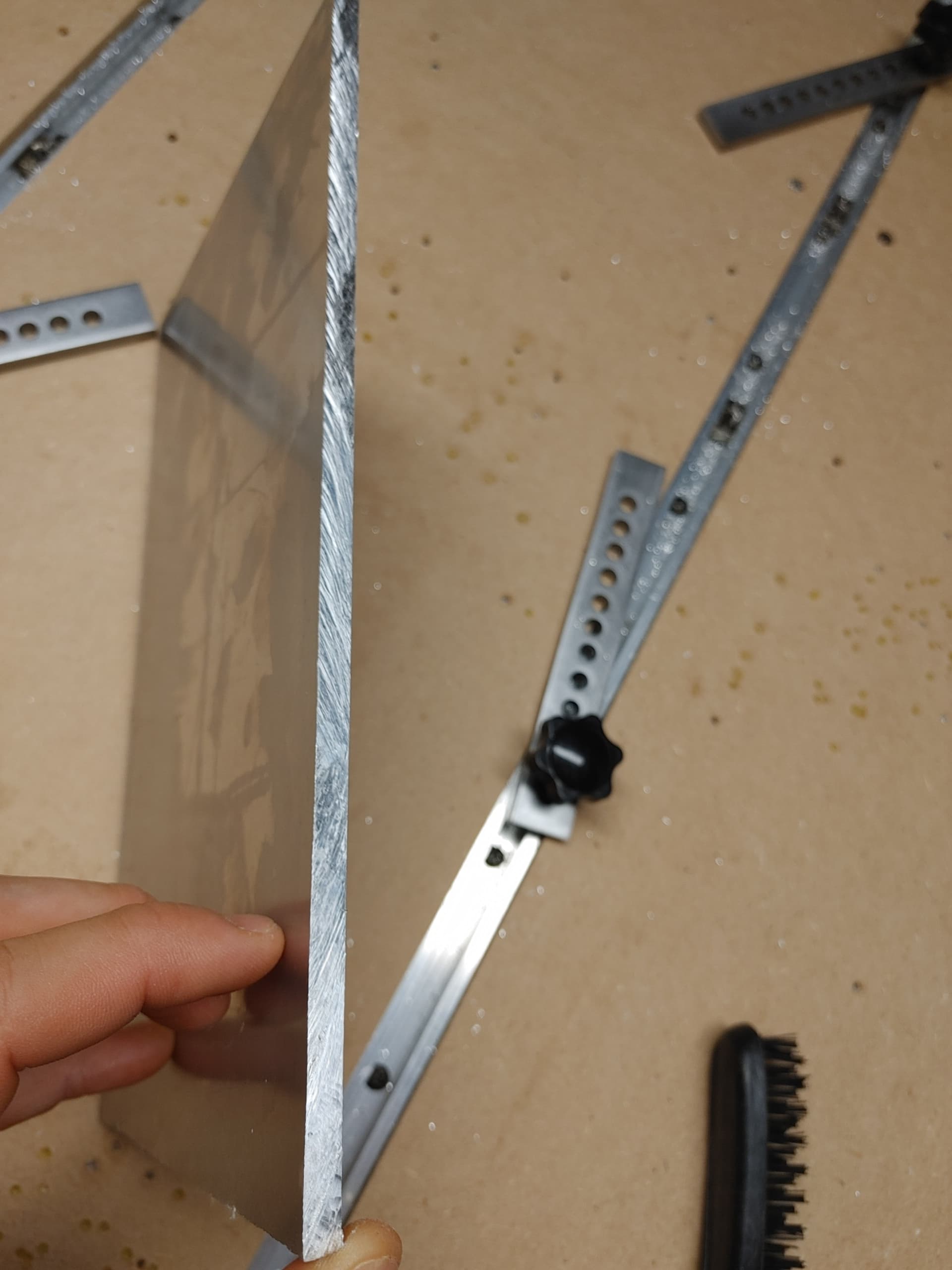

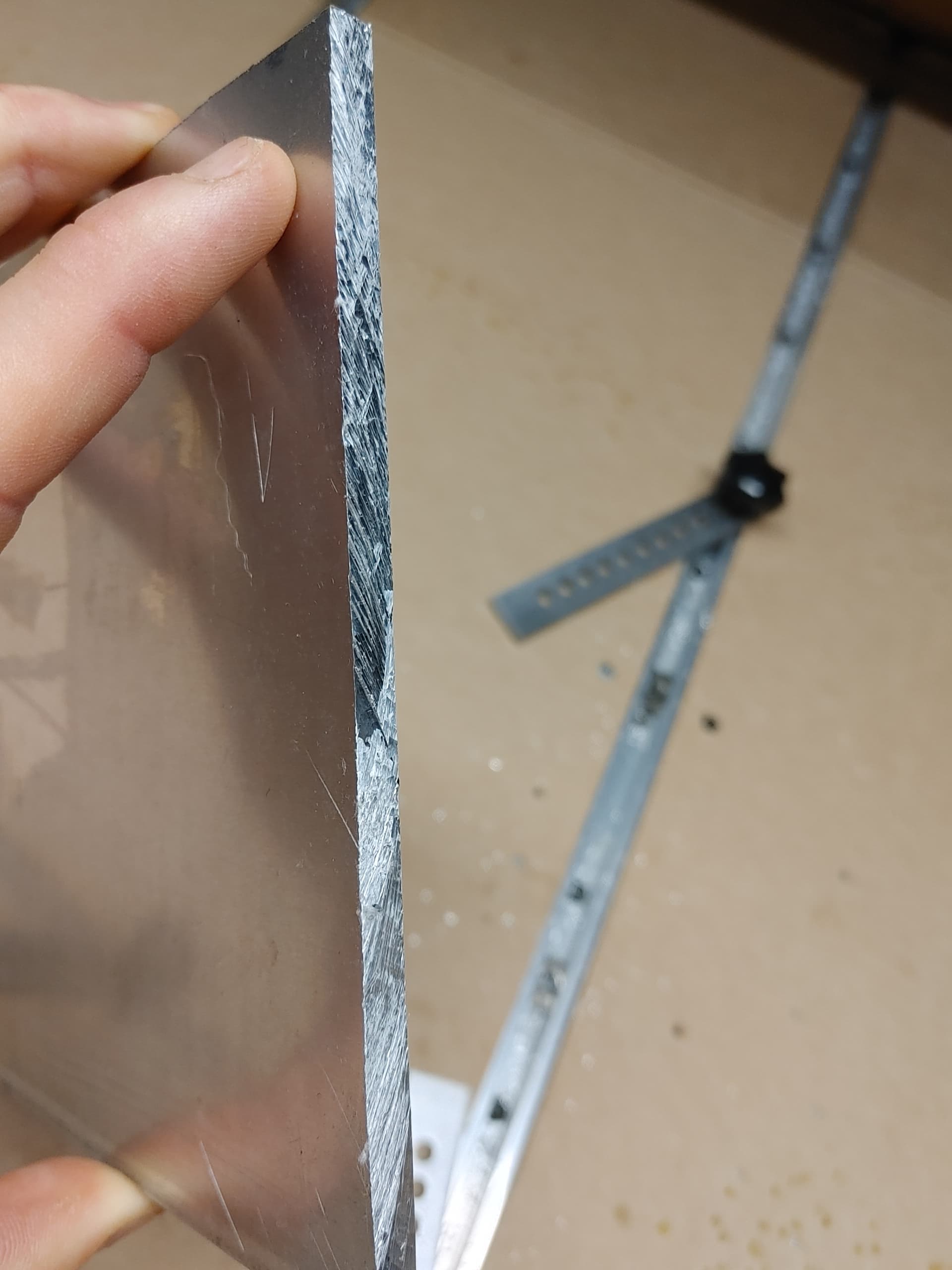

Not too bad. I’ll include some pics. They don’t tell the full story though. If I hold up a straight edge to it there will be small bumps and valleys around 1mm. That could throw things off I think. Generally it’s just a bit messy and needs a cleaning. My aluminum plate originally got cut by a plasma cutter to fit it in my car and those sides are the worst (not pictured).

If the edge has 1mm of variation, then the part should be at least 2mm larger than the finished size if it’s square. A bit more if it’s not very close to square.
You have 4 corners that will fit into the fences. Flip it around for the best fit and adjust the cuts to take off just enough stock to clean up the first two side. Once those sides are flat & square you flip it around & it should fit snuggly into the fixture.

At first I couldn’t quite wrap my head around it, but I played around with a mockup in photoshop and what you’re saying makes perfect sense to me now. Leave some excess, trim the sides opposite the fence to get a perfect 90, then once flipped, trim again for another perfect 90. This seems like a really good solution!

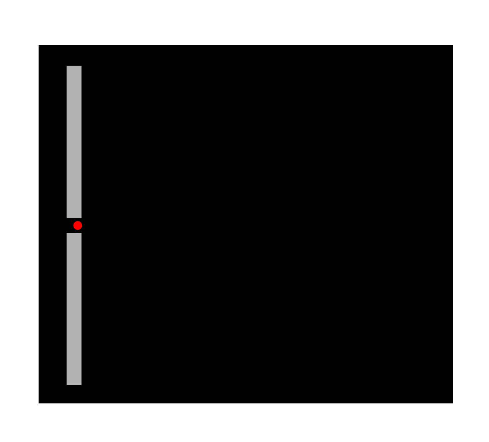

What do you guys think of this idea? I was looking into router templates for 5 minutes and thought up this table / fence system:
Black = table
Silver = fence
Red = router bit
I could run my sides of the workpiece along the fence and it would trim off small amounts of material, and potentially do the chamfers this way as well.
Interested in feedback, especially critiques and downsides. In my mind it actually wont work. Because there are inaccuracies in the work piece when I trim each side individually it won’t end up perfectly square.
You would want to use a 6.000 x 10.000 template with the router table, and a follow bearing on the router bit. Make the template on your cnc machine. You don’t really need the fence on a router table when using a template, but it is a nice safety feature that gives you something to rest the edge of the part while feeding into the blade.
