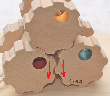

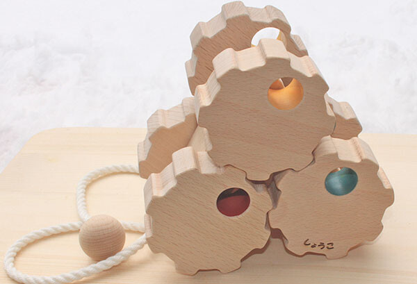

I’m trying to recreate a wooden pull toy similar to the one shown in the reference photo. The wheels have an 8-lobed “gear-like” profile and are intended to rotate together as the toy is pulled.
I designed the wheels in Carbide Create and machined them on my CNC. The individual wheels came out well, but when I assemble them, they don’t rotate together. Instead, the lobes bind against each other and the wheels get stuck.
I’m wondering if I’m missing a basic design principle.

Move the center to center distance of the bottom two wheels, so they do not touch.
As now, they lock.

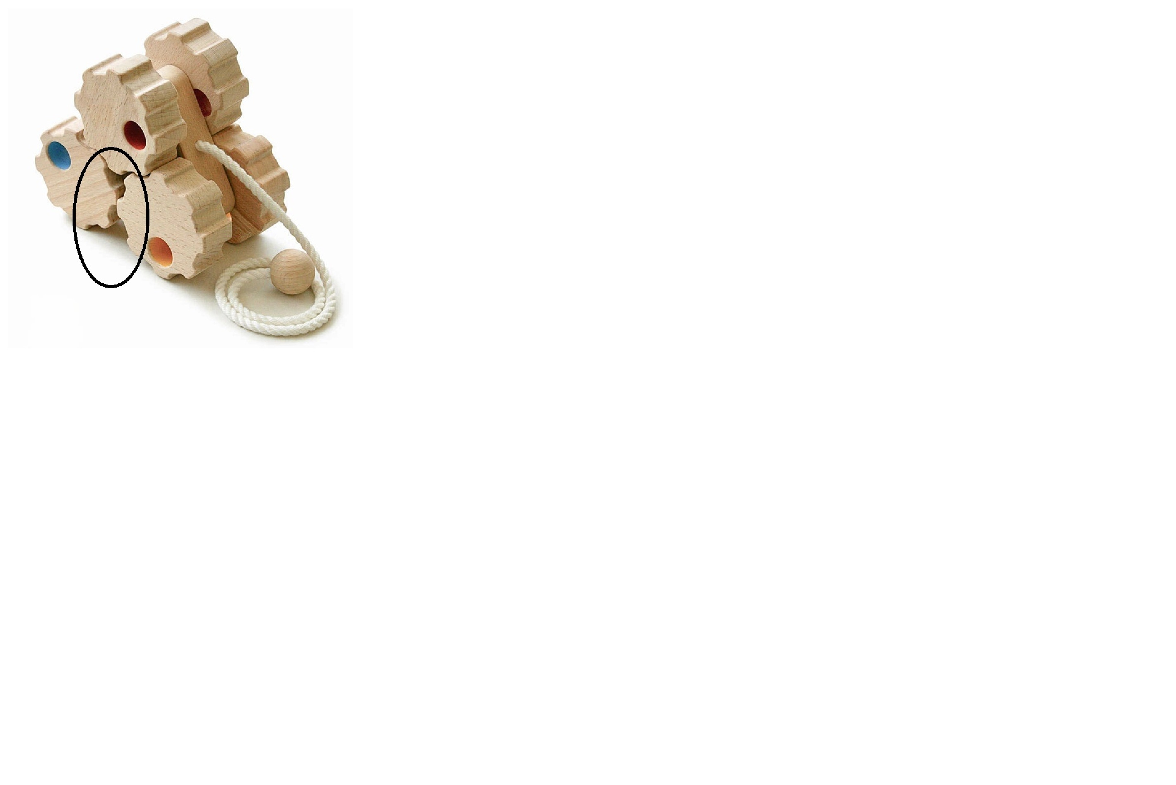

No, its a different design. here is the one i am working at
http://www.avis.ne.jp/~g-k-toys/toys/g003.html
The image on that page seems to show that the bottom two wheels do not mesh (as was pointed out before) which will then allow things to rotate as expected.

There is a fundamental gearing geometry problem. You cannot have a trio of meshing gears that turn. With the “red” and “blue” gears in mesh they are constrained to rotate in opposite directions
which will bind the “yellow” gear. The only way for this to work is to space the “red” and “blue” gears a little farther so they do not mesh. I think that you are right in that they just designed a lot of slop into the wheel axles. In fact, in the video on the Japanese webpage, you can see one point where the wheels are locked up right before the user “unfolds” the mechanism again…

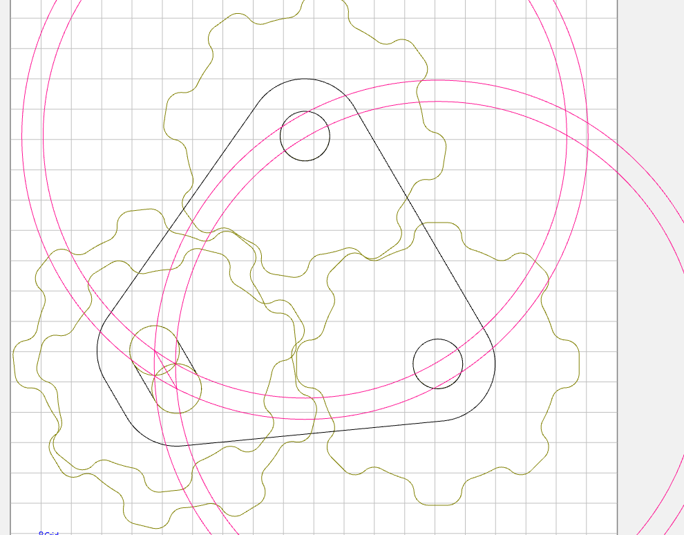

Try something like this… Assuming the rope pull is upper-right, (red circle)
This will allow the lower left wheel to mesh with either of the other two wheels, but clear the wheel that’s on the ground.
Prototype.c2d (168 KB)

I just drew arcs at engaged & clearance distances & connected the intersections…

You have hit on the core requirement, John. The two wheels in contact with the floor cannot be meshed, no matter which two they are. But we want the “upper” wheel to be in mesh with the other two (or at least one of them to be driven). In the Japanese video(specifically the g007), this is not a triangular fidget, but it can be unfolded to be linear with all three wheels on the ground. In that case, none of the wheels can be meshed. I stick by my theory that it depends on a lot of slop in the axle fits and the frame pivoting, and even then is not guaranteed to not lock up. The g003 variety is triangular but they keep in in a single orientation (with the properly spaced lower wheels) for the whole video.
I went to the site referenced and the picture I see the bottom two gears do not mesh together.
The blue and orange gears do not appear to mesh together.
Looking at the website there appears to be multiple versions of the toy.
