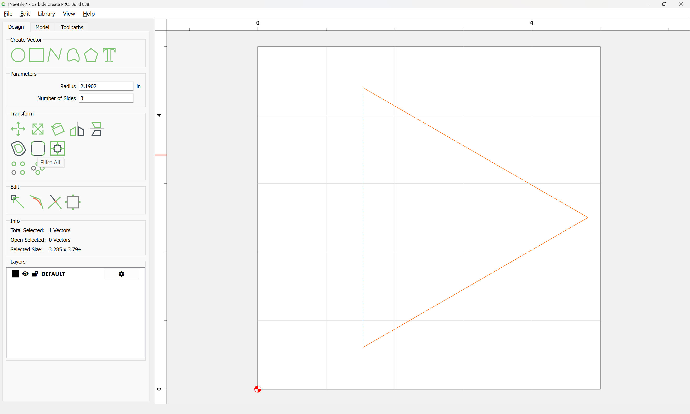

Need help rounding corners on triangle

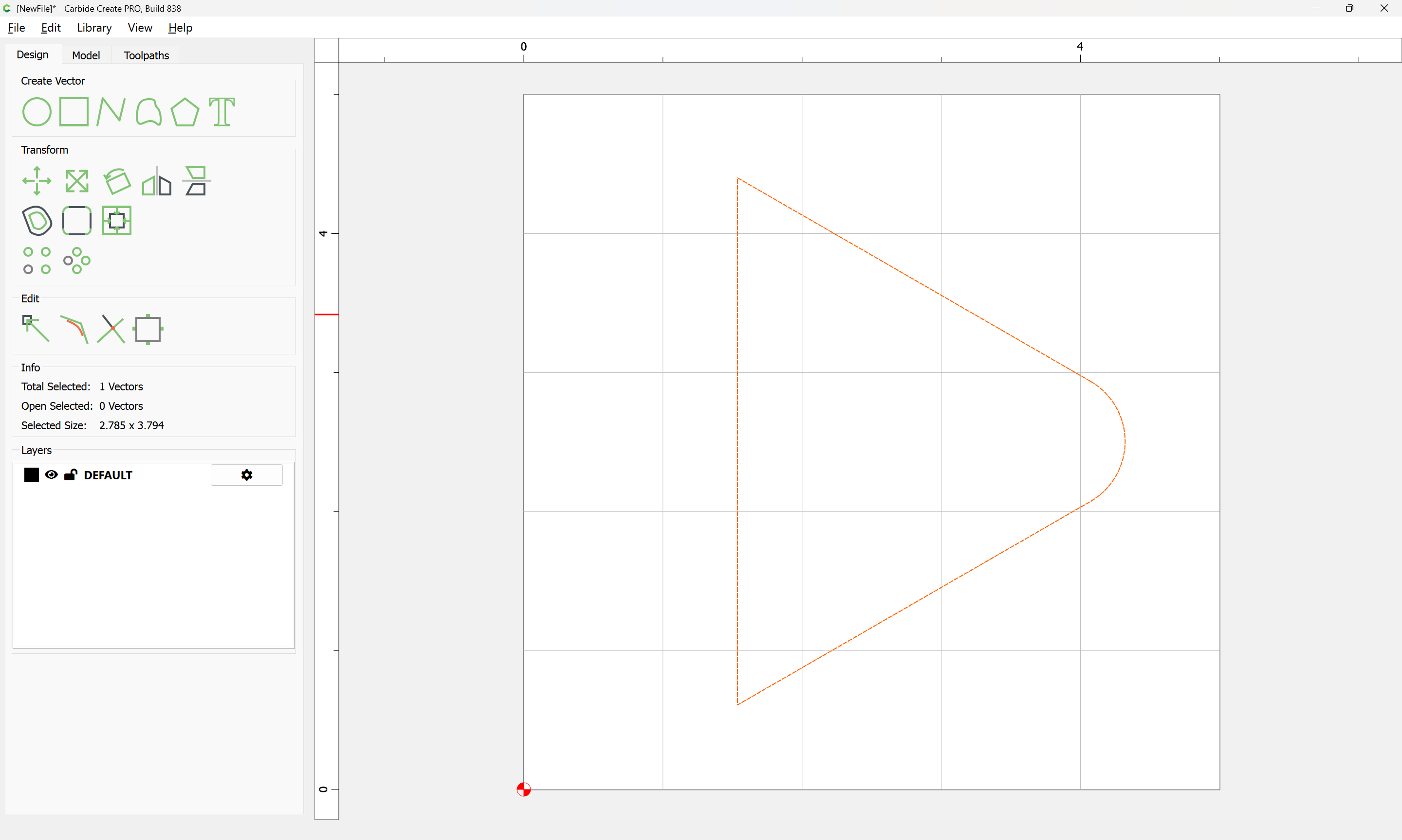

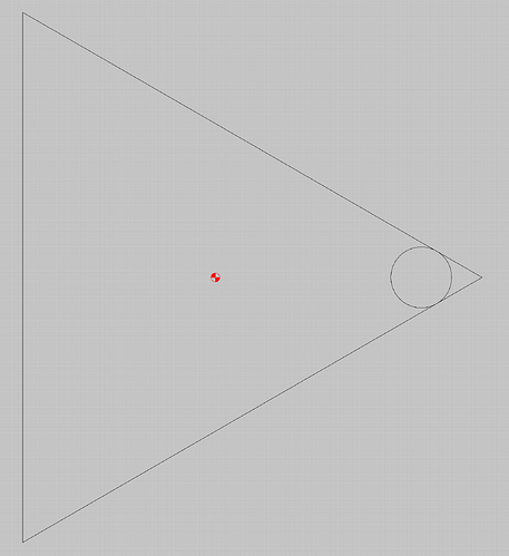

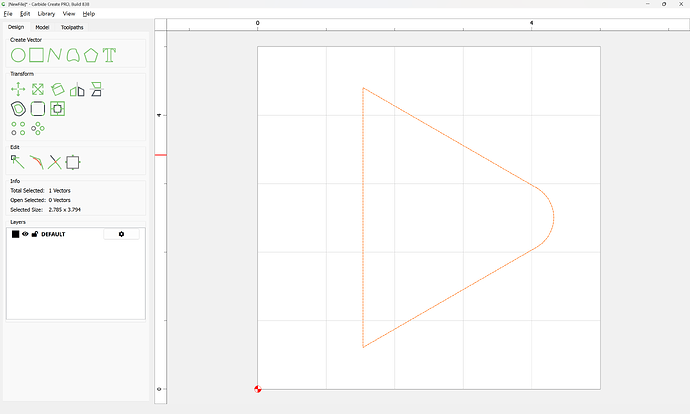

I’ve seen numerous comments and instructions regarding Boolean functions but I can’t get the desired effect I’m looking for. I’m looking to round the pointed corners of a triangle. I added a circle and intersected it towards the tip of the triangle, clicked on the triangle to highlight it, held down shift and clicked on the circle. I selected Boolean subtract and these are the options I get. It’s my understanding that the blue lines indicate what the fininshed figure should look like but as you can see that is not what I get. What am I doing wrong?

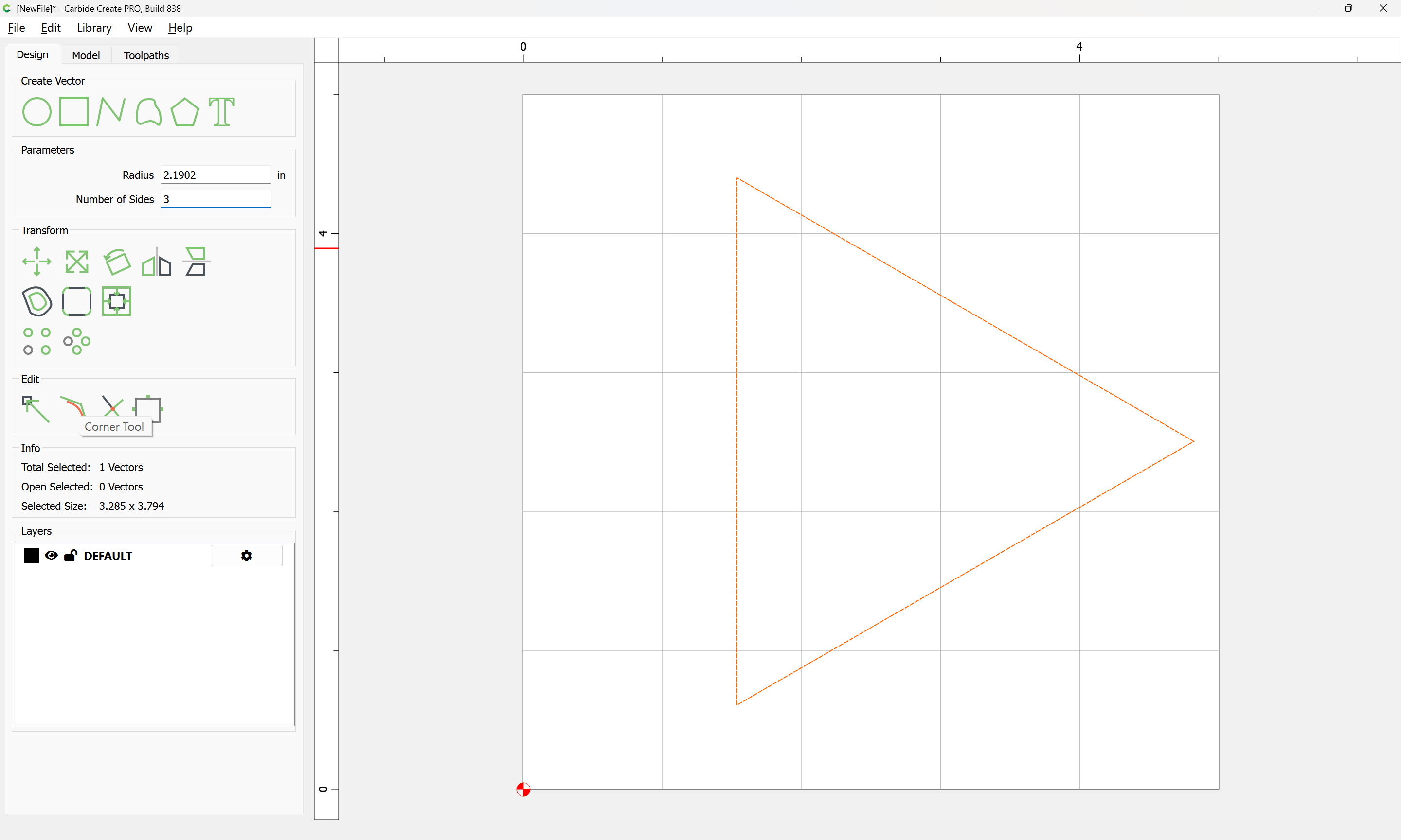

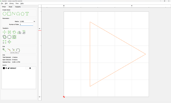

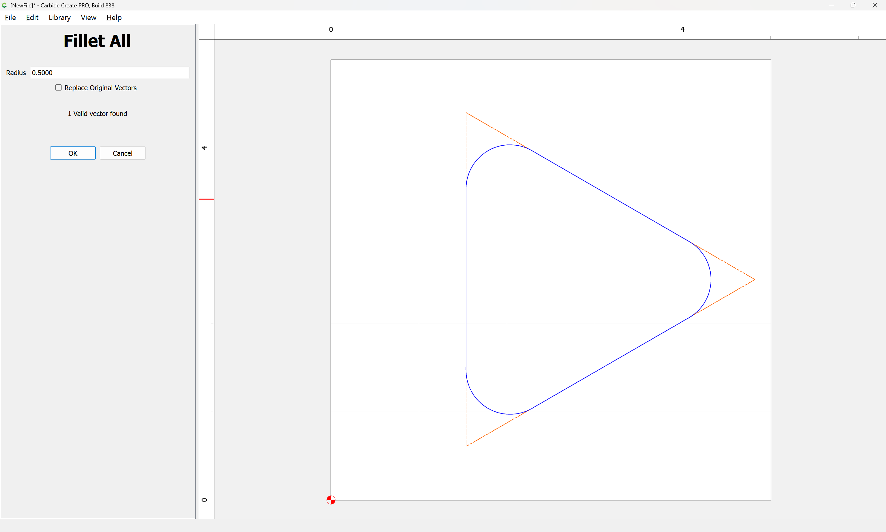

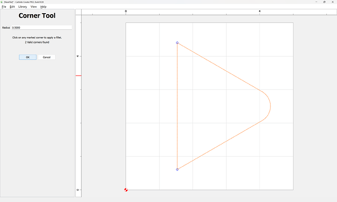

There are two tools for this:

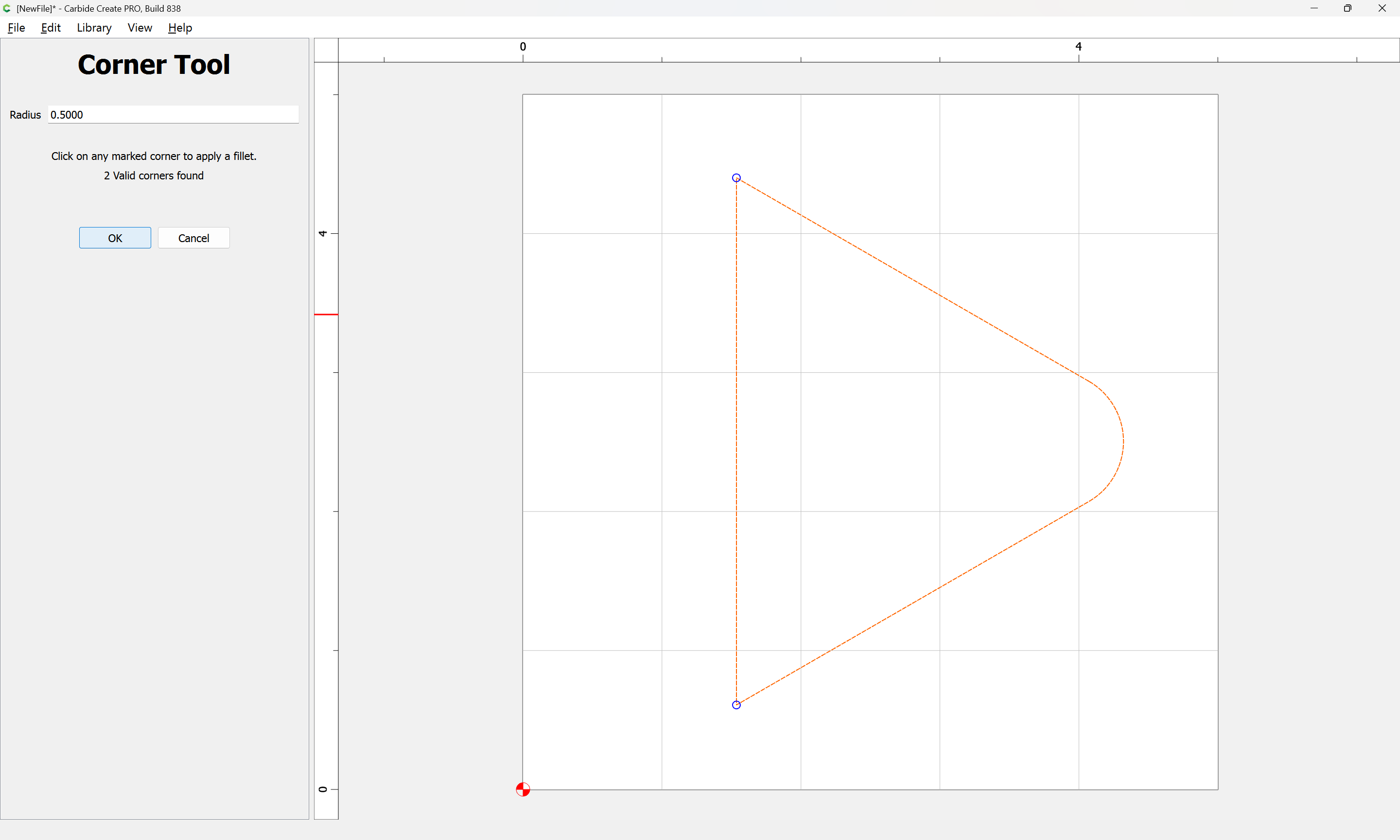

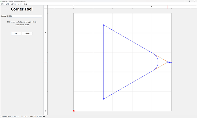

  • Corner Tool
OK
and
  • Fillet All:
OK
If you still have difficulties, upload the file.
Great! Thanks for your help.
