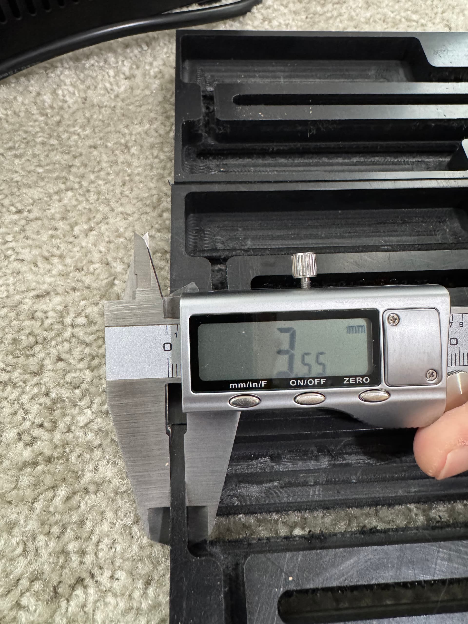

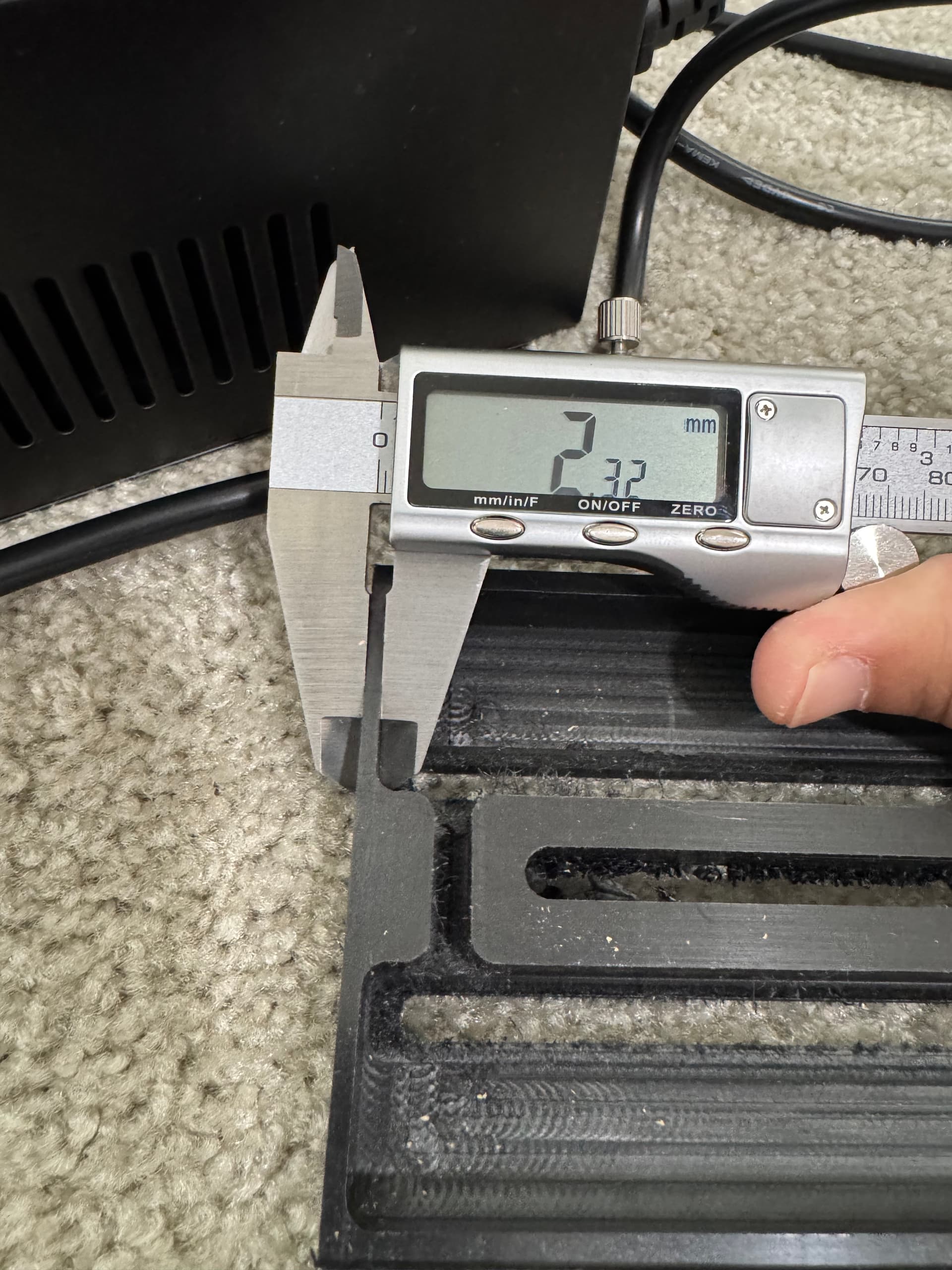

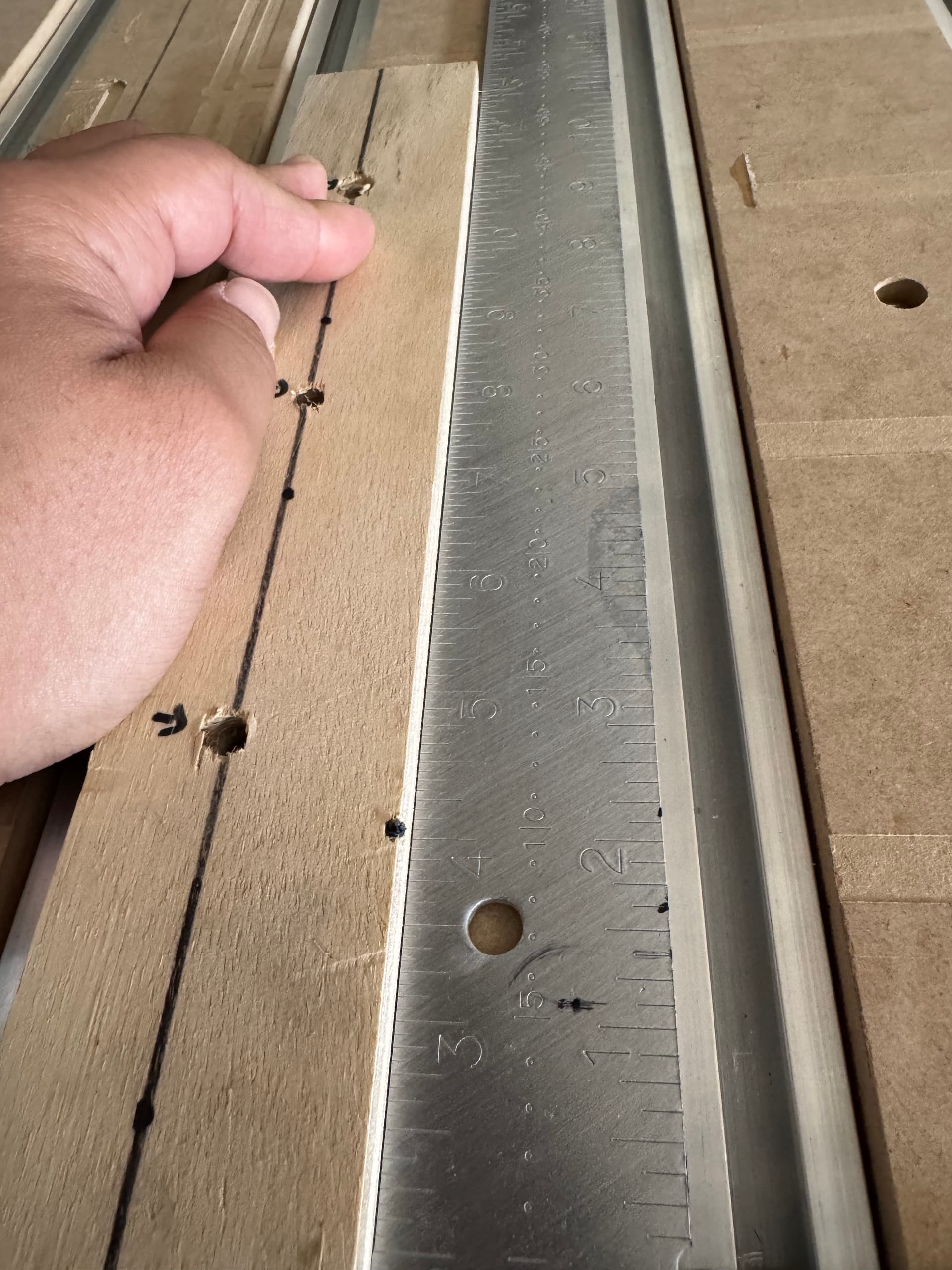

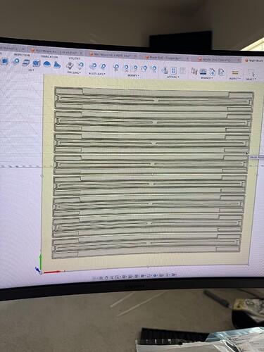

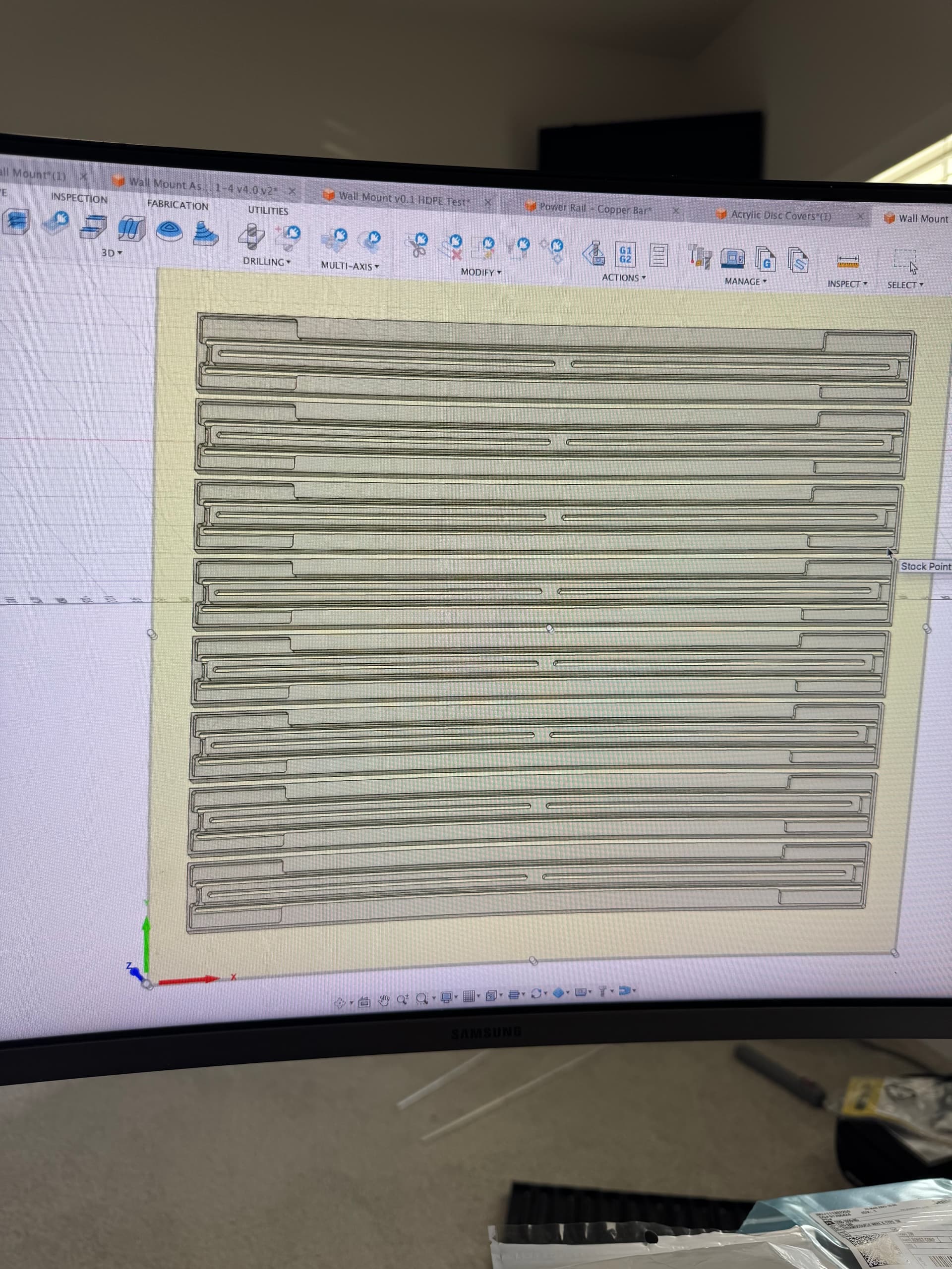

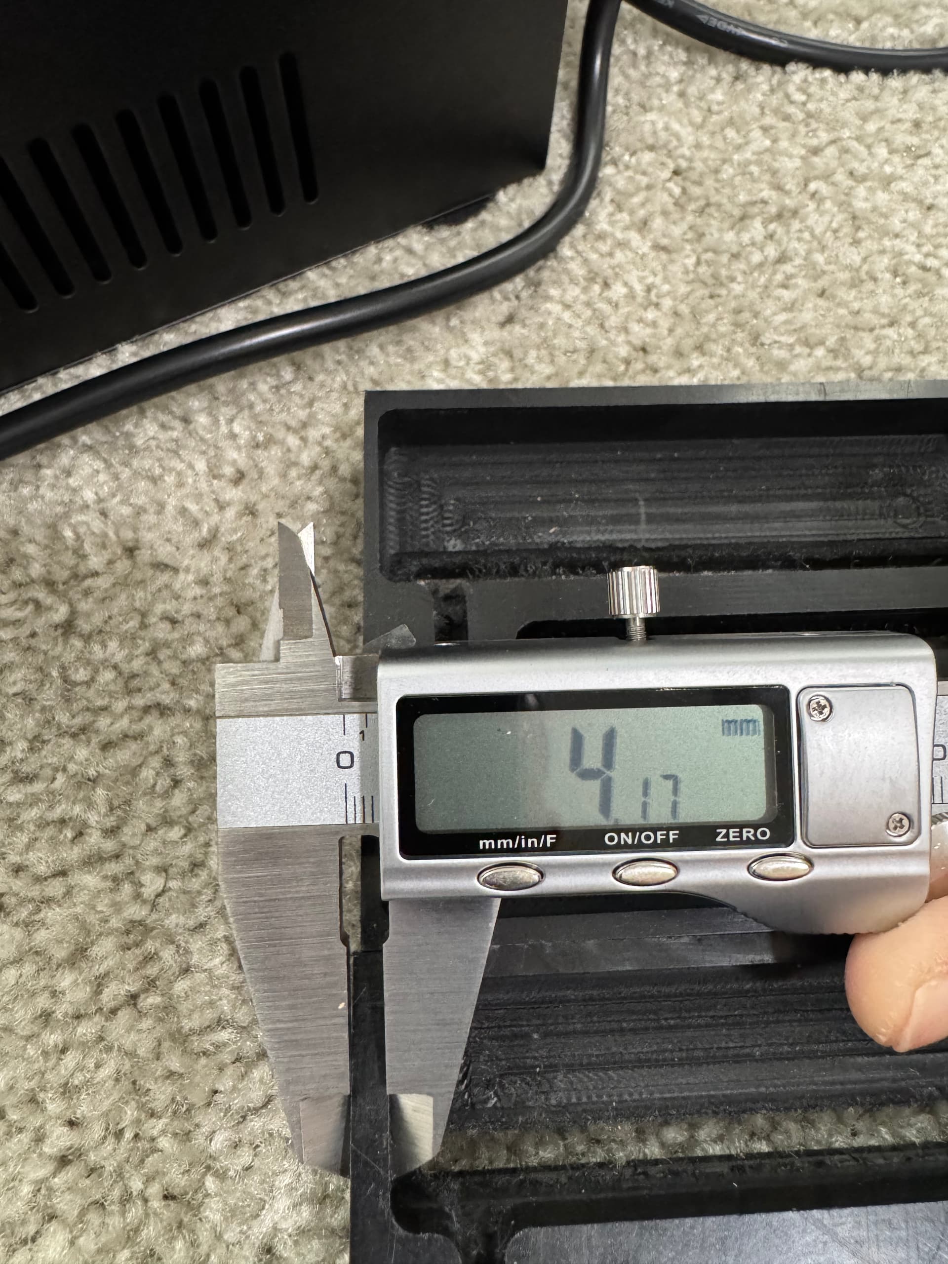

I bought a Shapeoko 5 Pro to machine a part for a product, and I’m mainly doing flip cuts. However, there’s no easy way to get this thing square, and every single cut has been off. I’m attaching a picture of a square plywood jig that I cut with the machine before machining this part in HDPE. Also, in the picture, a metal store bought square shows how the Y is a tad off and not snug (it’s more obvious in person). Additionally, I attached pictures of my intended design in Fusion 360, where the part to be machined is center to stock, and the resulting post-machined HDPE that have wildly different widths on the edges. I suspect the Y-axis on the machine is off, but does anyone have any suggestions on how to get this thing back to square?
P.S. It’s 3/4" HDPE. Also, I measured these widths out of order (the three pictures w/ caliper measurements), but if I stacked them in the correct order in which they were cut, they would all have a gradual taper. I just posted these as an example.

Regardless of how square you get the machine, your gantry is not likely to be perfectly square to another part of the machine like the front crossbeam for instance. If you need to locate material squarely, machine yourself a fence on the machine. That way your reference plane is perfectly square to your axis of movement. :slight_smile:

In your first post I’m not sure what the metal framing square is measuring. The measurements showing a taper in one side wall (Y-Axis) could be a stock positioning error - did you check the opposite side wall for the corresponding taper?
What I would do first is, on the machine, cut a square out of the middle of a piece of scrap MDF. Measure that to see if X and Y are the same dimension and also measure the diagonals. If X and Y are the same but the diagonals are different, then your machine is indeed cutting out of square, and if you mark the piece before removing it from the spoilboard you should know which way to tweak the machine after loosening enough bolts.
If the diagonals are the same, then your machine cuts square and you should be looking at other things to explain your other results.
