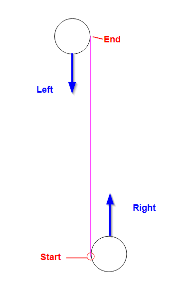

To add to this, Inside/Outside only make sense on CLOSED vectors. With an open vector, there is no inside or outside, so you get the modifiers, Left/Right.
Imagine just a straight line. Normally, you might think cutting on the Right side would be conventional cutting, and on the left side would be climb cutting. CC doesn’t do this. It likes to conventional cut either way, so the Left/Right are determined by the starting end of the curve.
Unfortunately, you don’t know which end is start & which is end.
There is one small clue that works for open curves. If you create the path & simulate, the starting engage will be green, and the retract at the end will be red.
And if the vector is symmetrical, you can swap the start & end by mirroring the vector.
In the above picture, I duplicated the left vector on the right, then mirrored it to get the path to go the other way.
