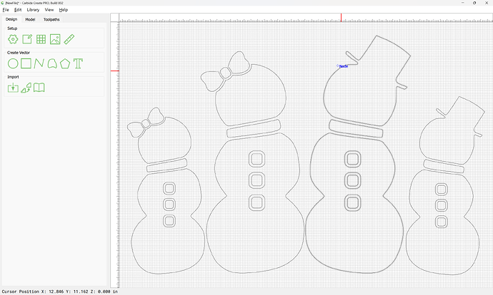

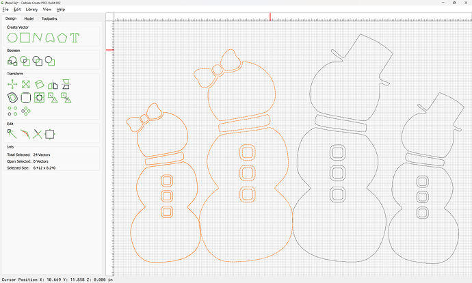

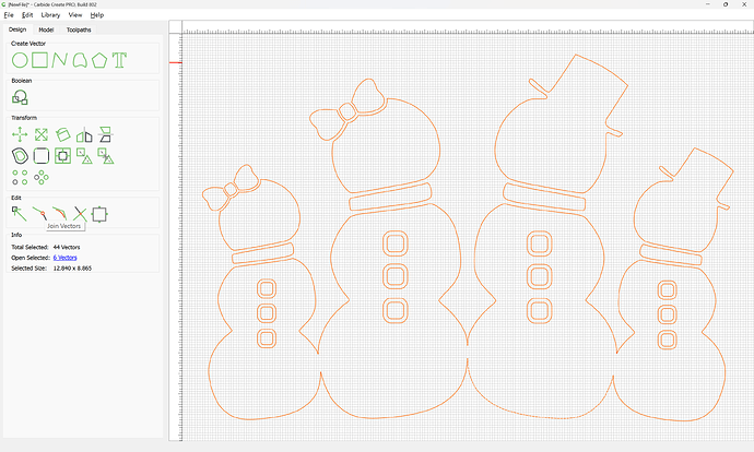

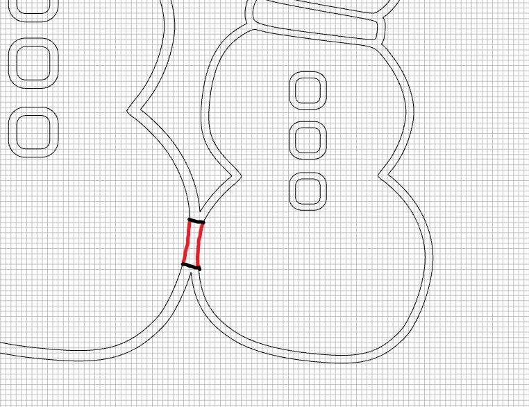

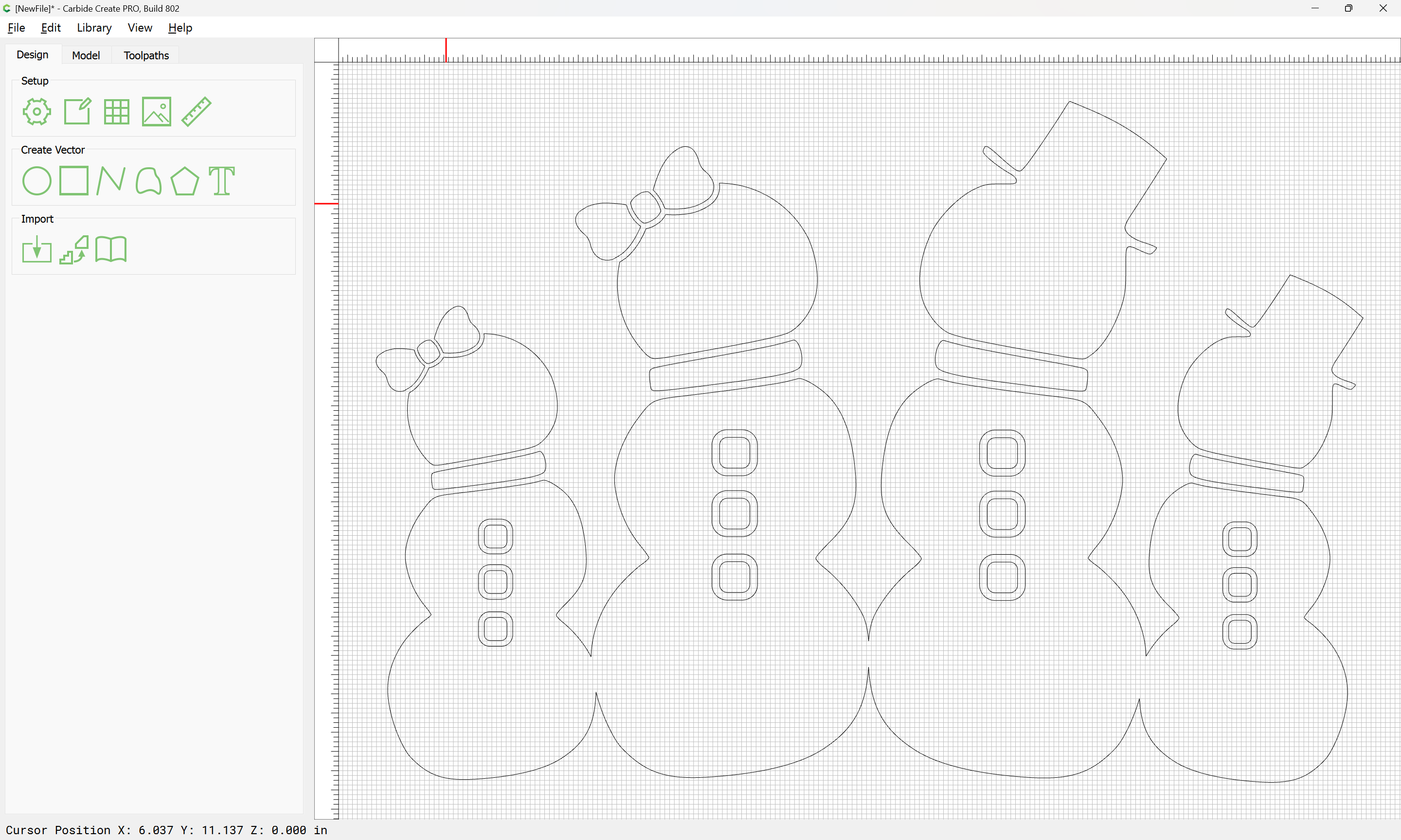

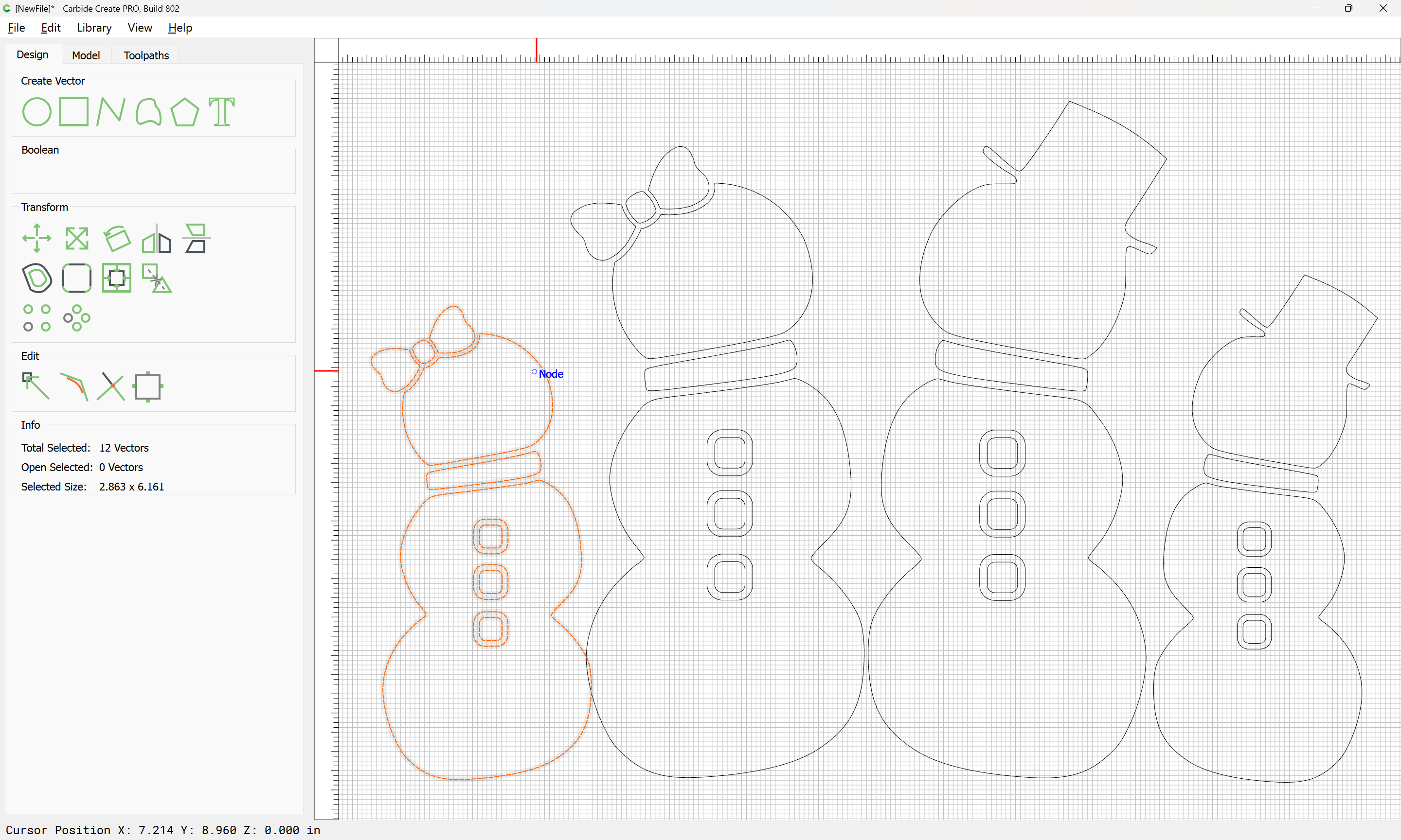

I’m trying to join these snowmen bodies together. I got the outline vectors added together using the “weld” tool.
I’m now trying to figure out how to delete the 2 snowmen
body vectors in “red” and join them together the “black” lines? I was playing around with the edit vectors tool but can’t figure it out. Maybe not possible?

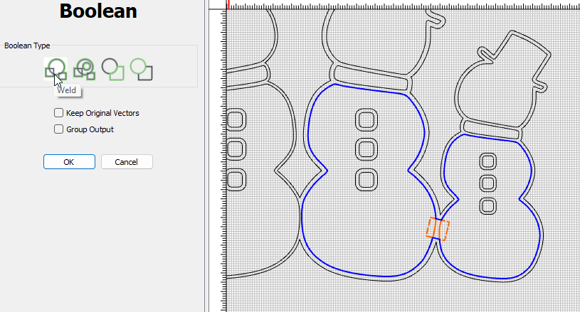

The easiest way would be to create a closed polyline shape and union/weld all 3 shapes
I needed to ungroup the snowmen first

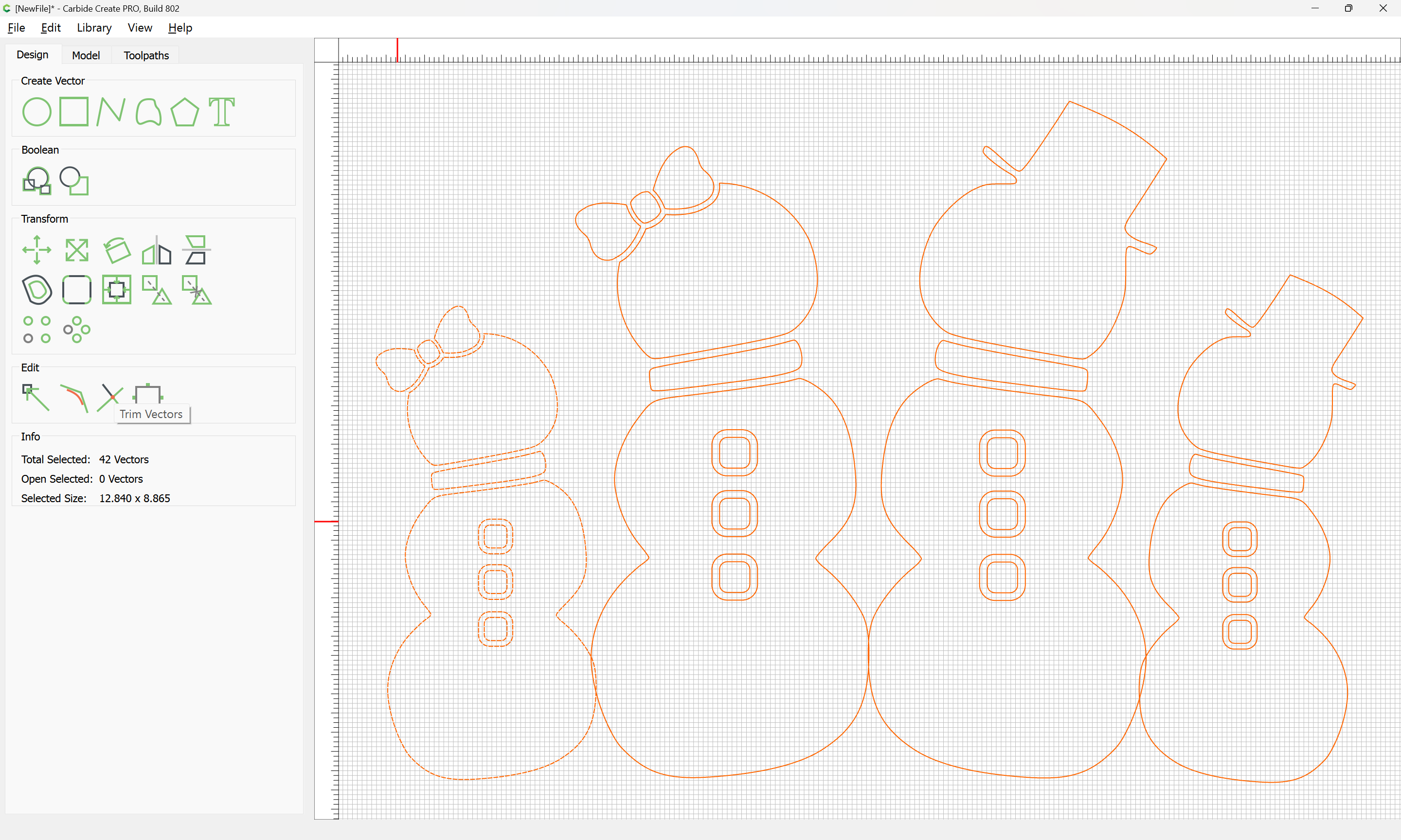

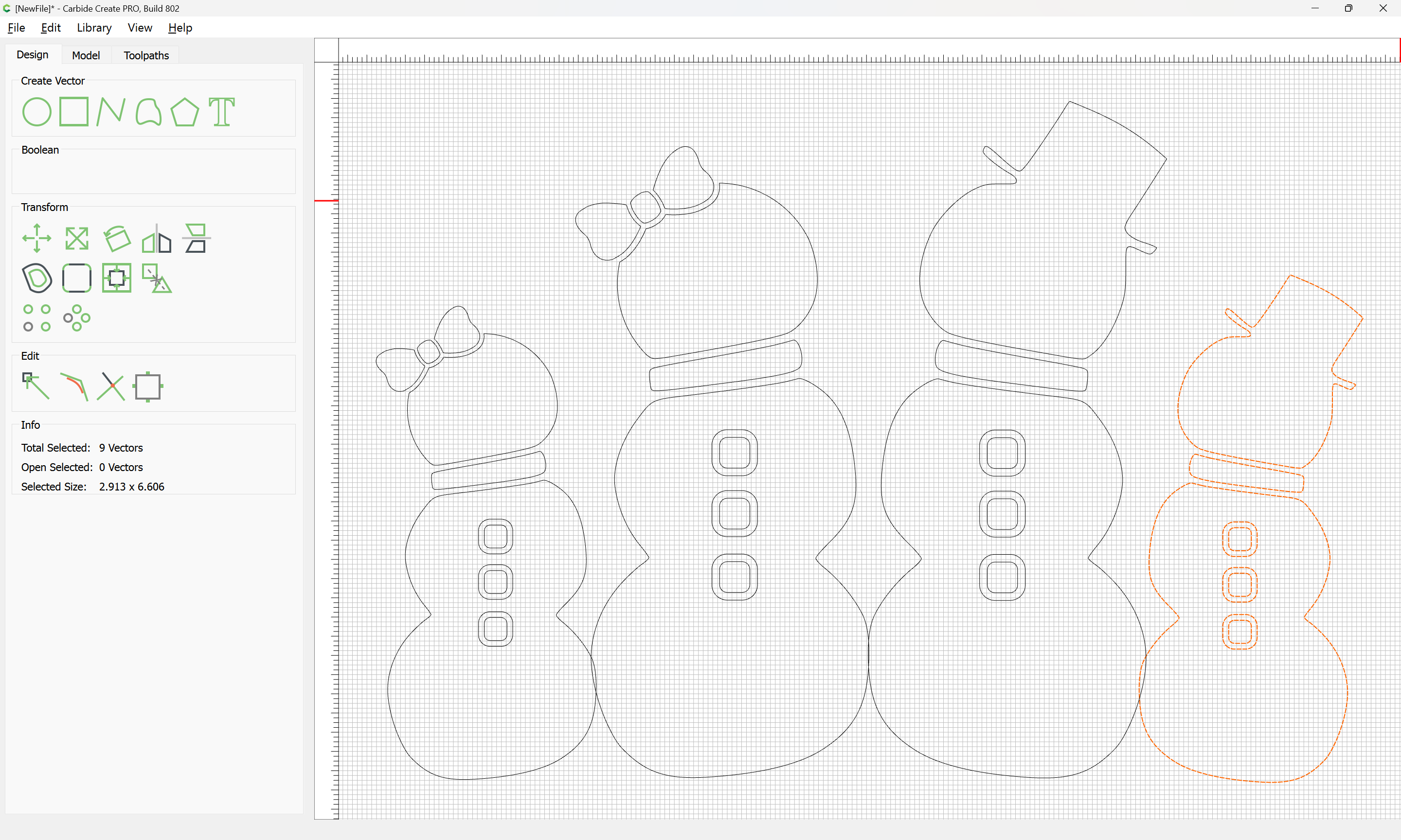

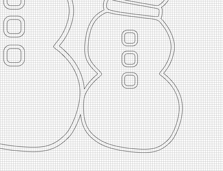

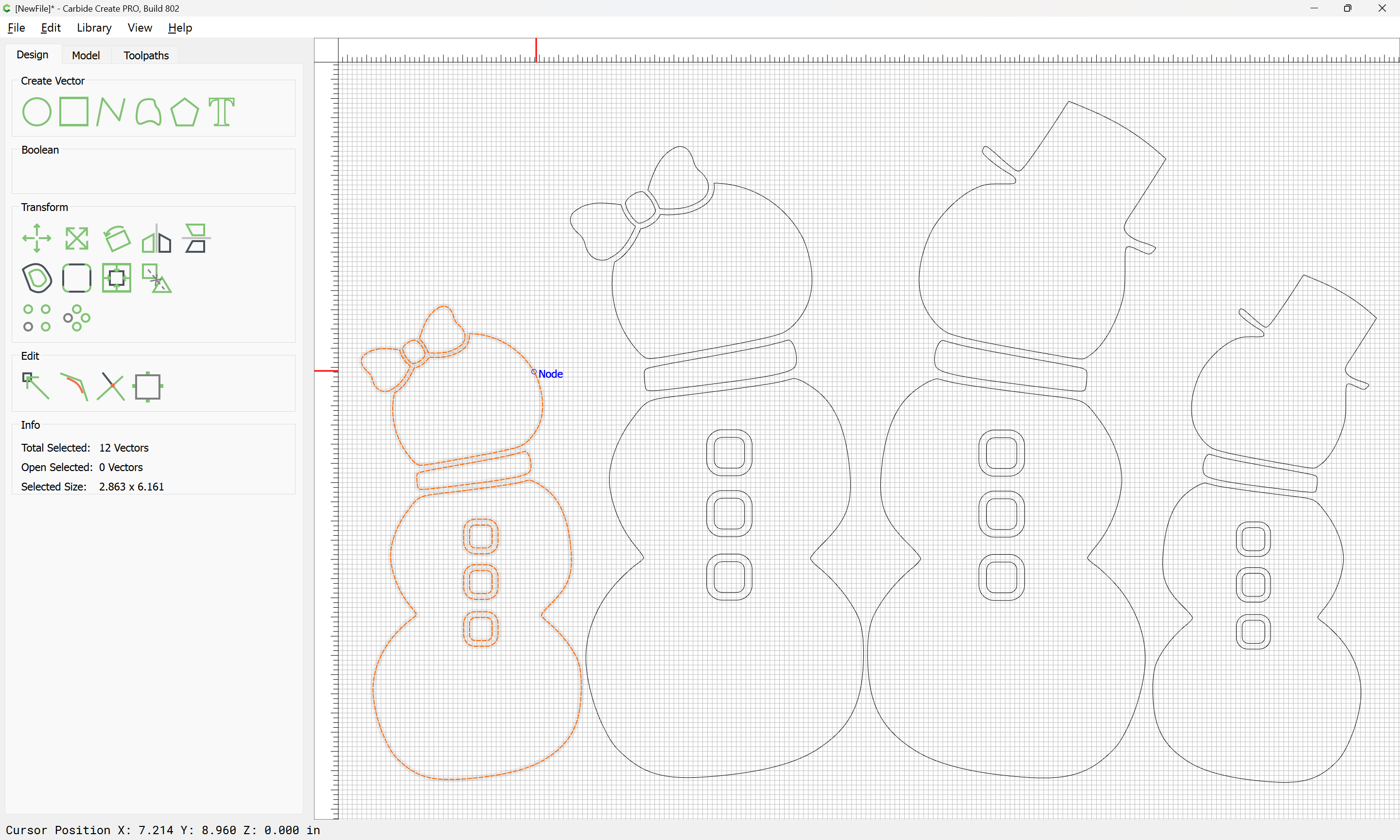

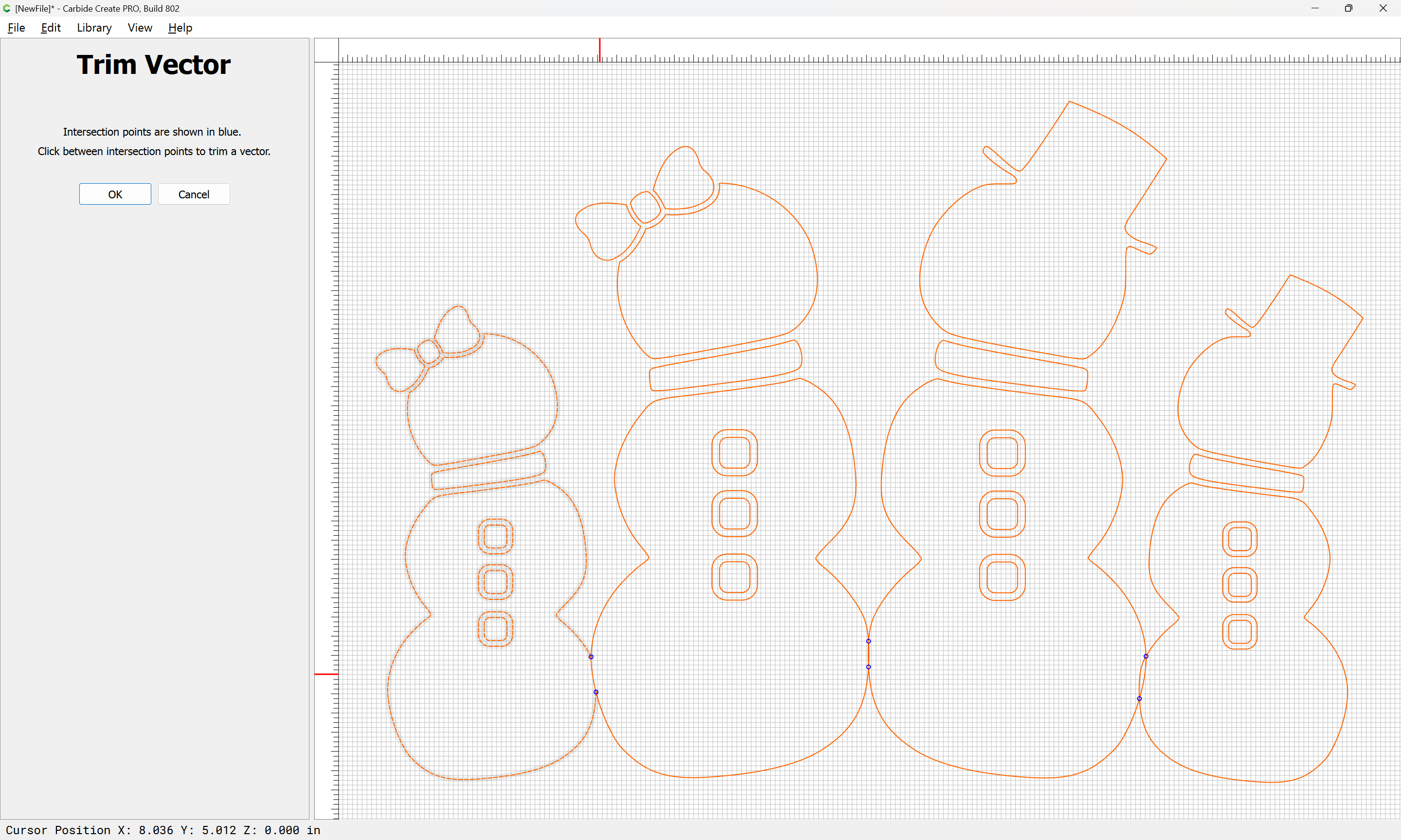

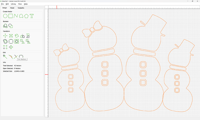

Rather than draw in additional geometry to make this connection, my inclination would be to remove the surrounding geometry:

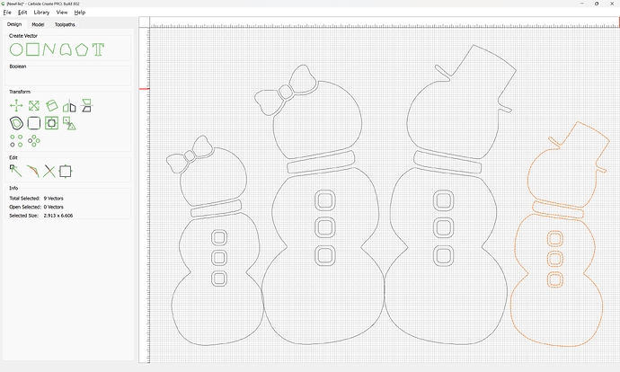

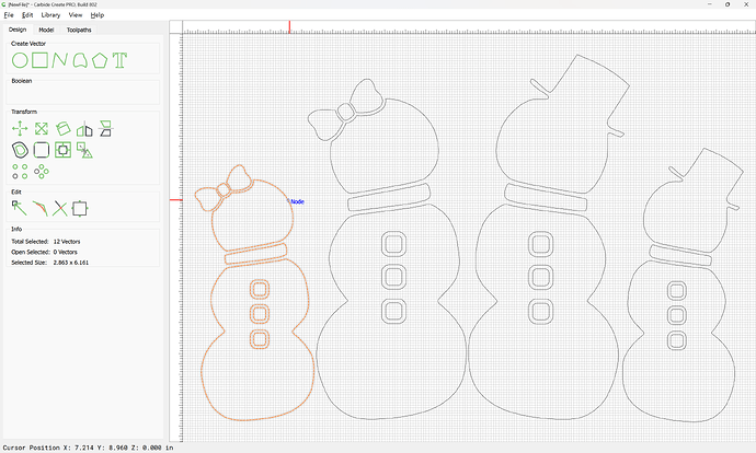

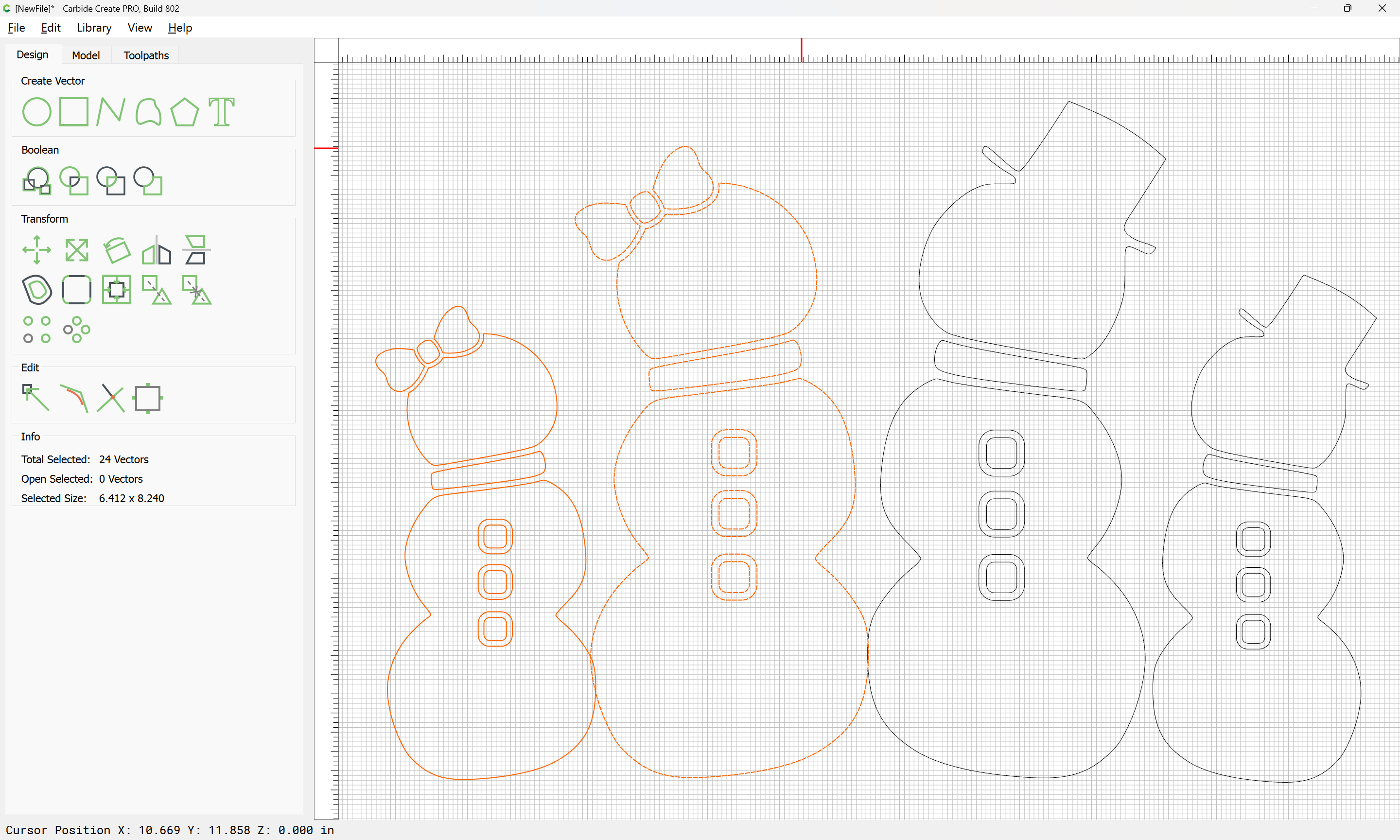

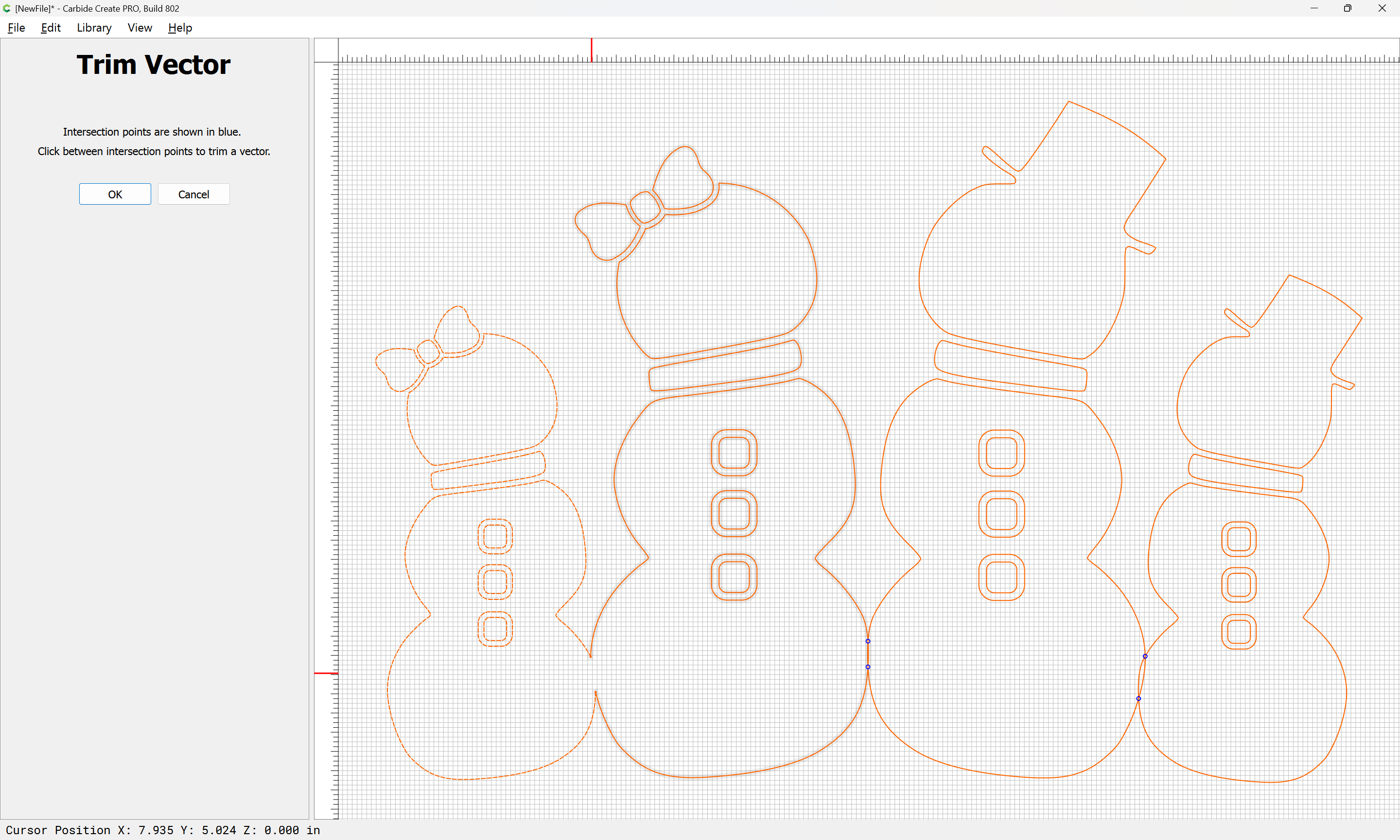

Then select and drag each snowman over so it overlaps:
repeat for each snowman:

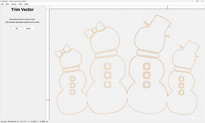

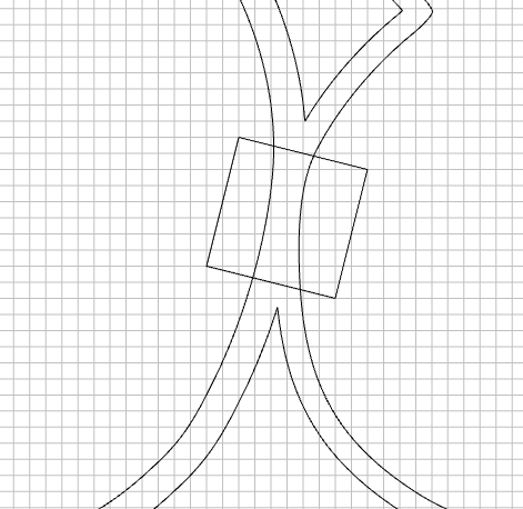

Select the overlapping geometries:

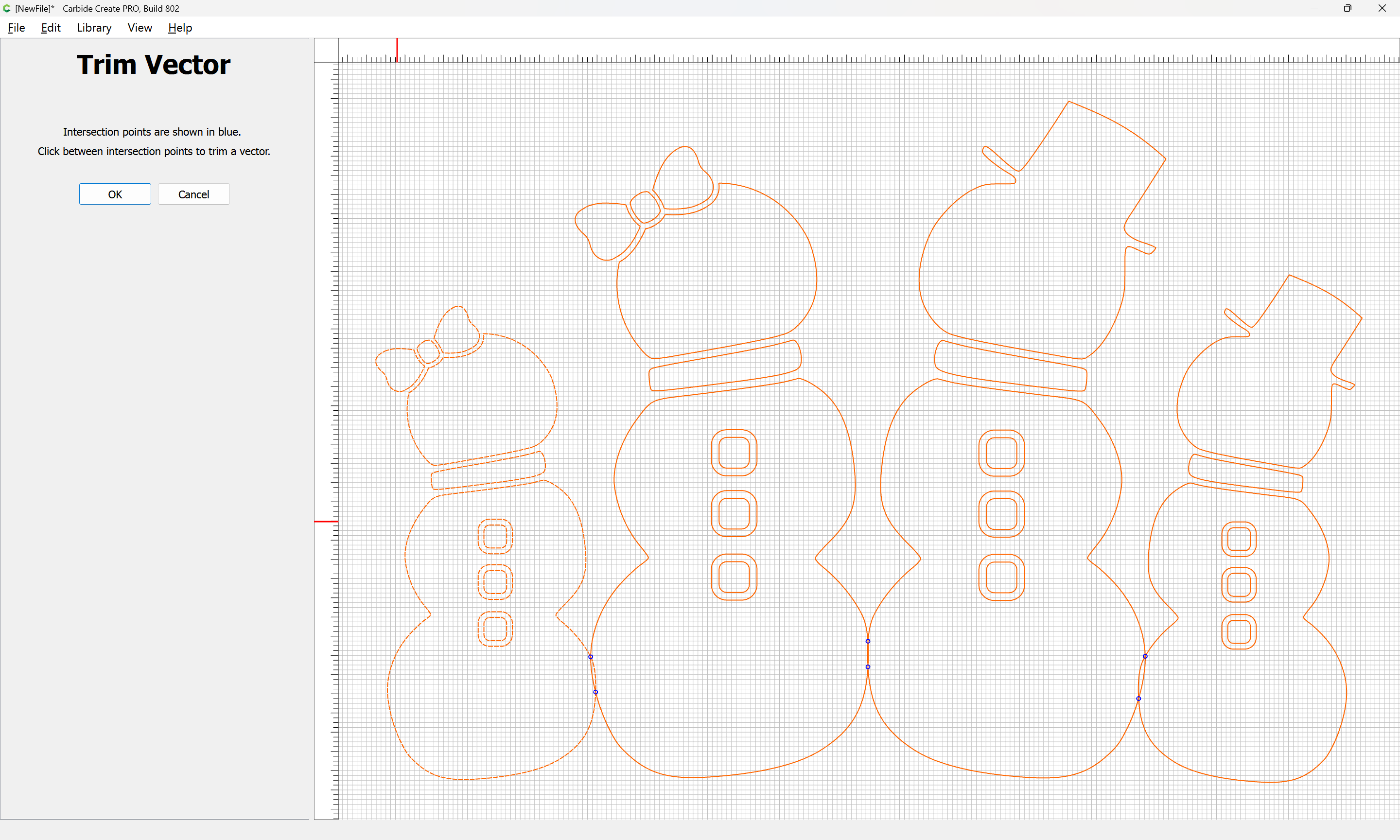

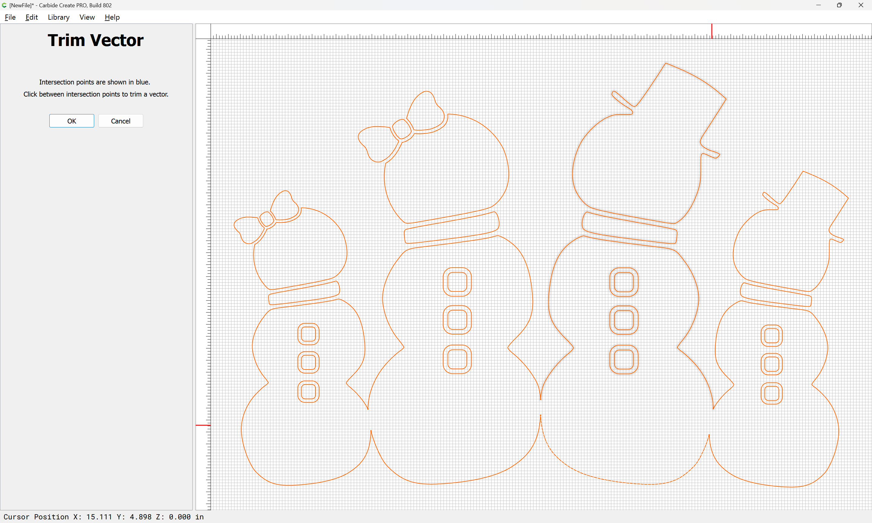

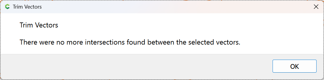

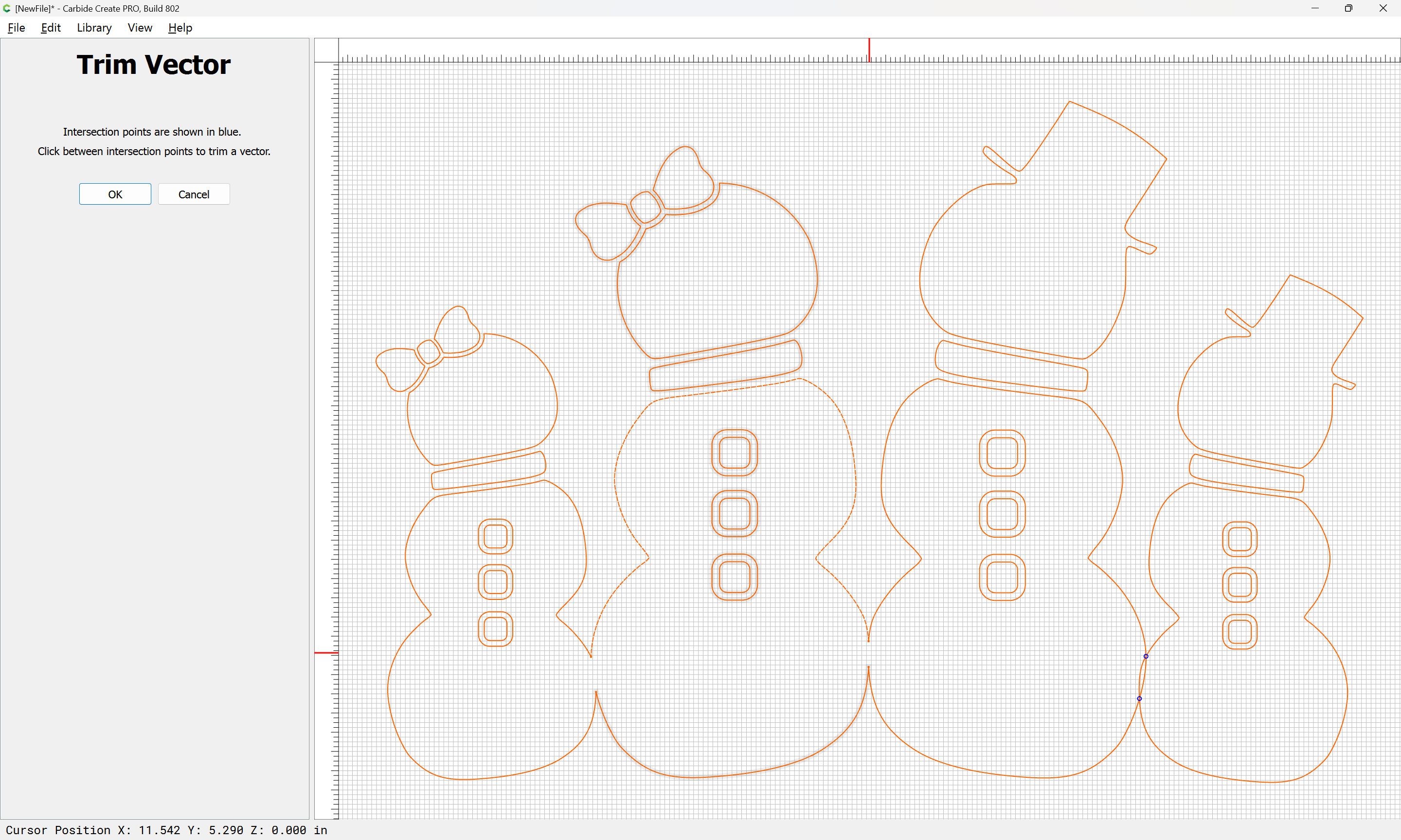

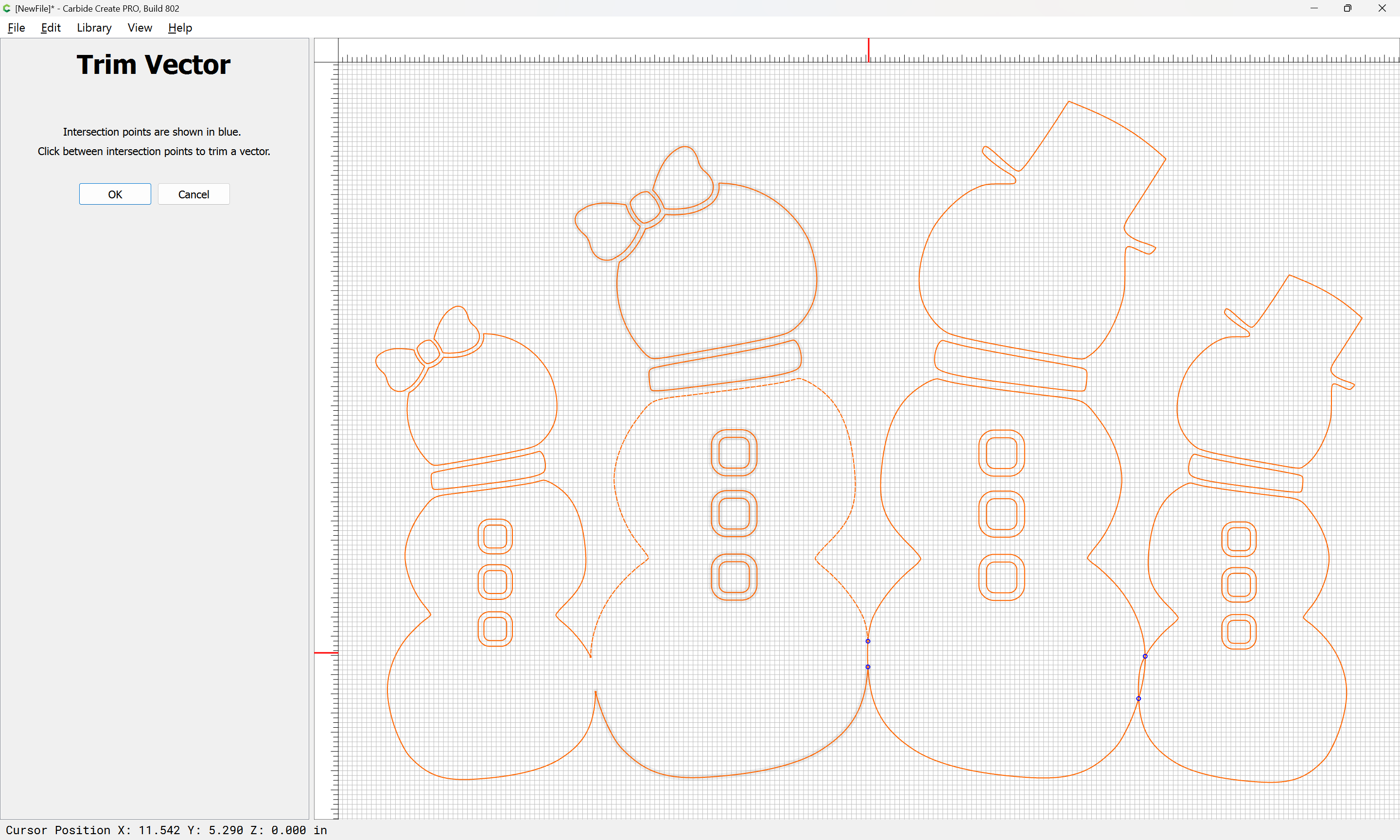

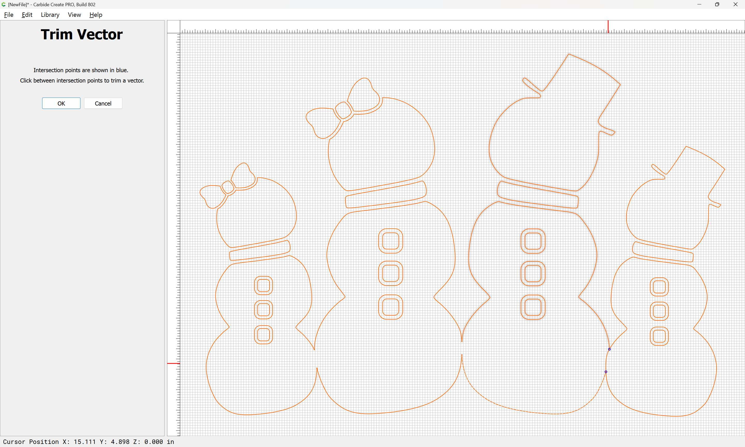

Then use Trim Vectors:
and click on each each segment which is not wanted:
until one arrives at:

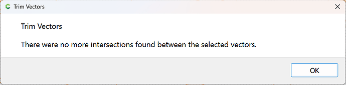

OK
OK

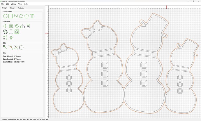

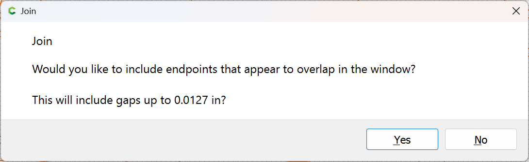

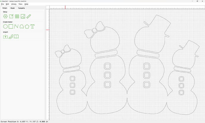

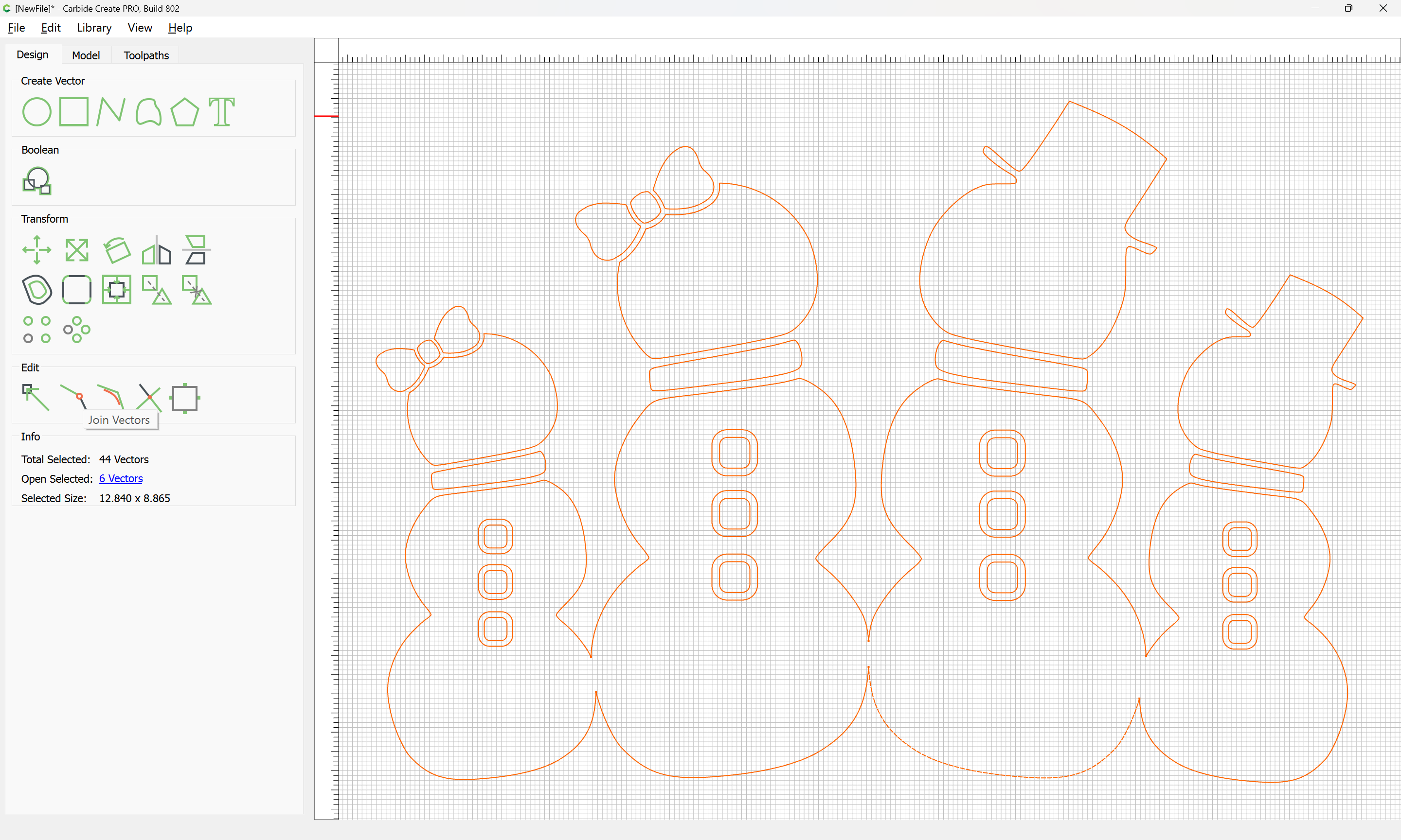

Then use Join Vectors to close things:
Yes
(if need be, repeat)

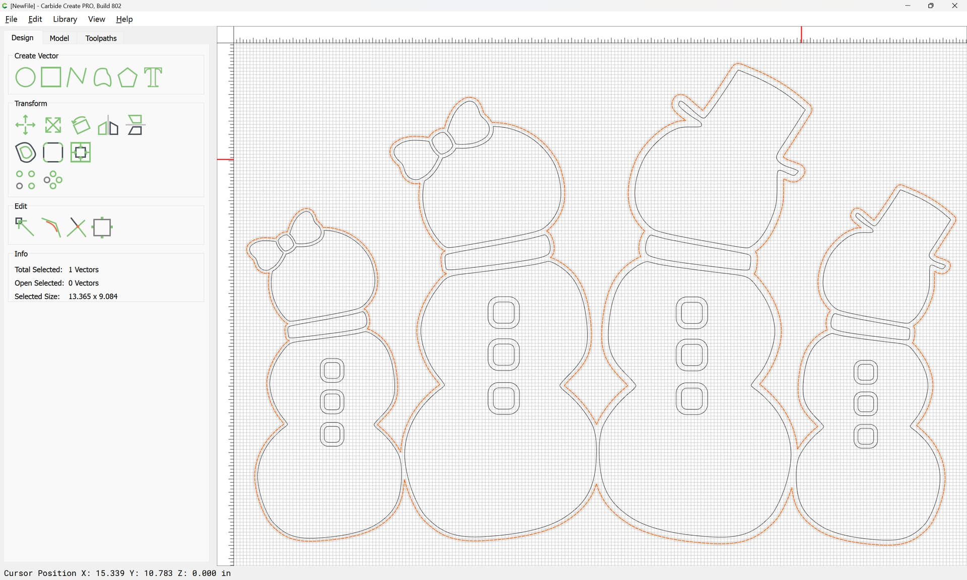

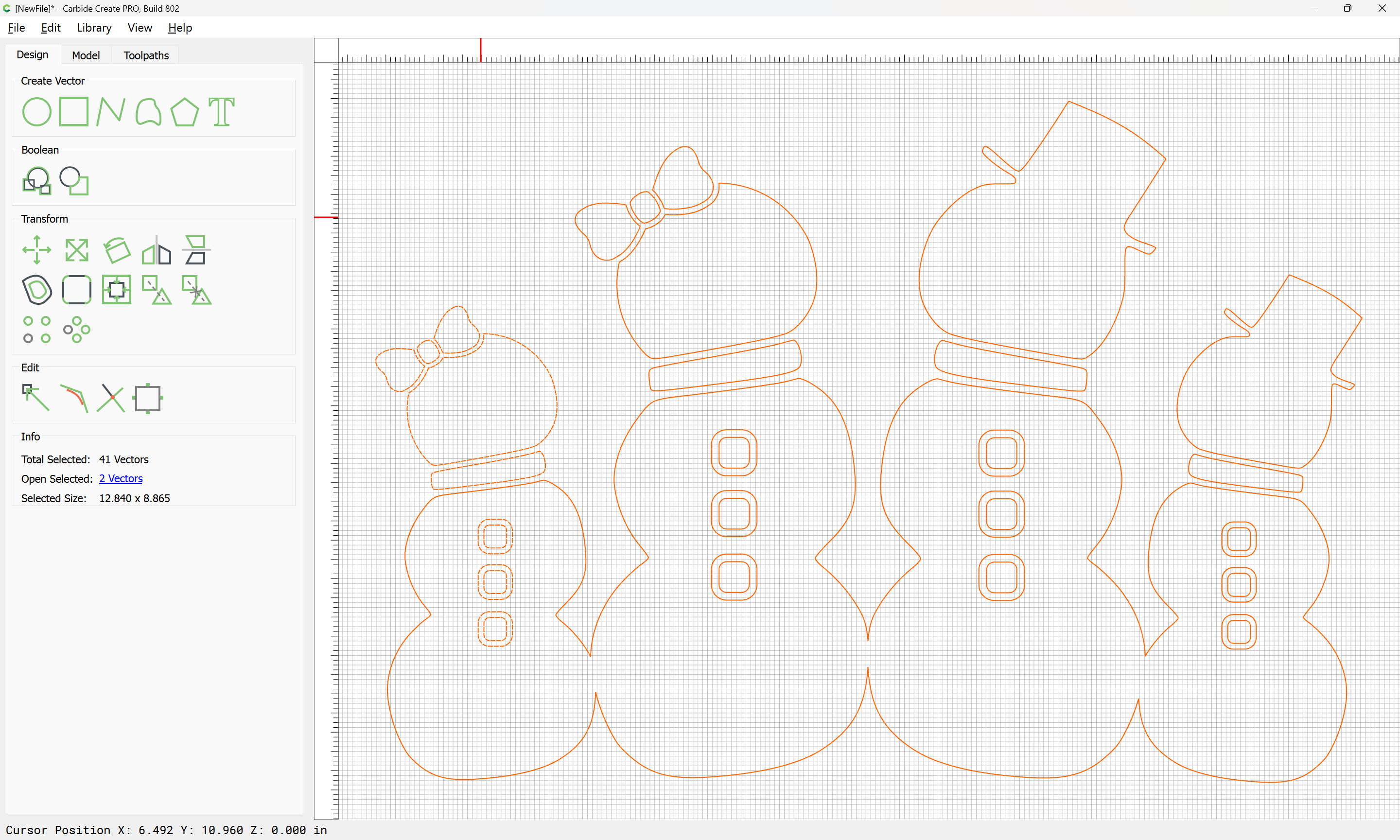

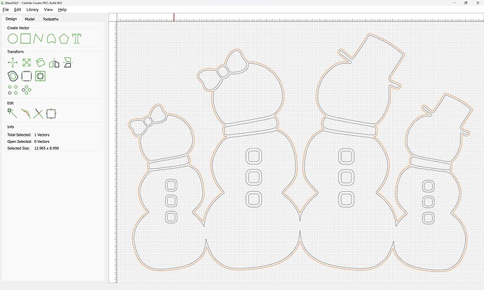

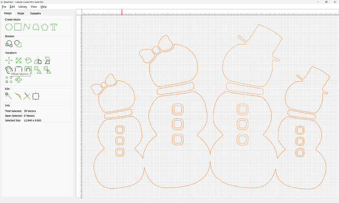

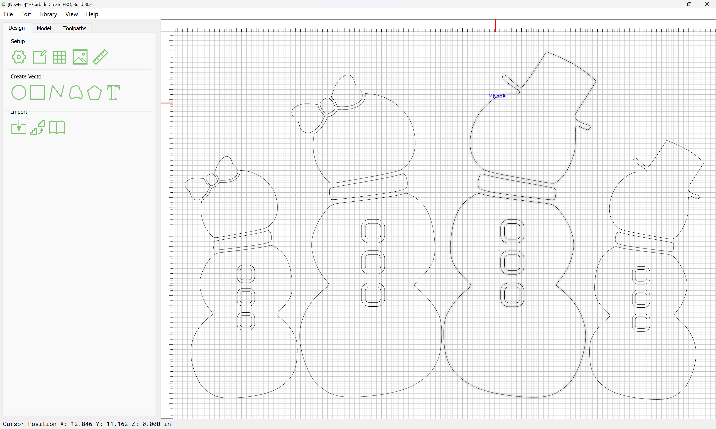

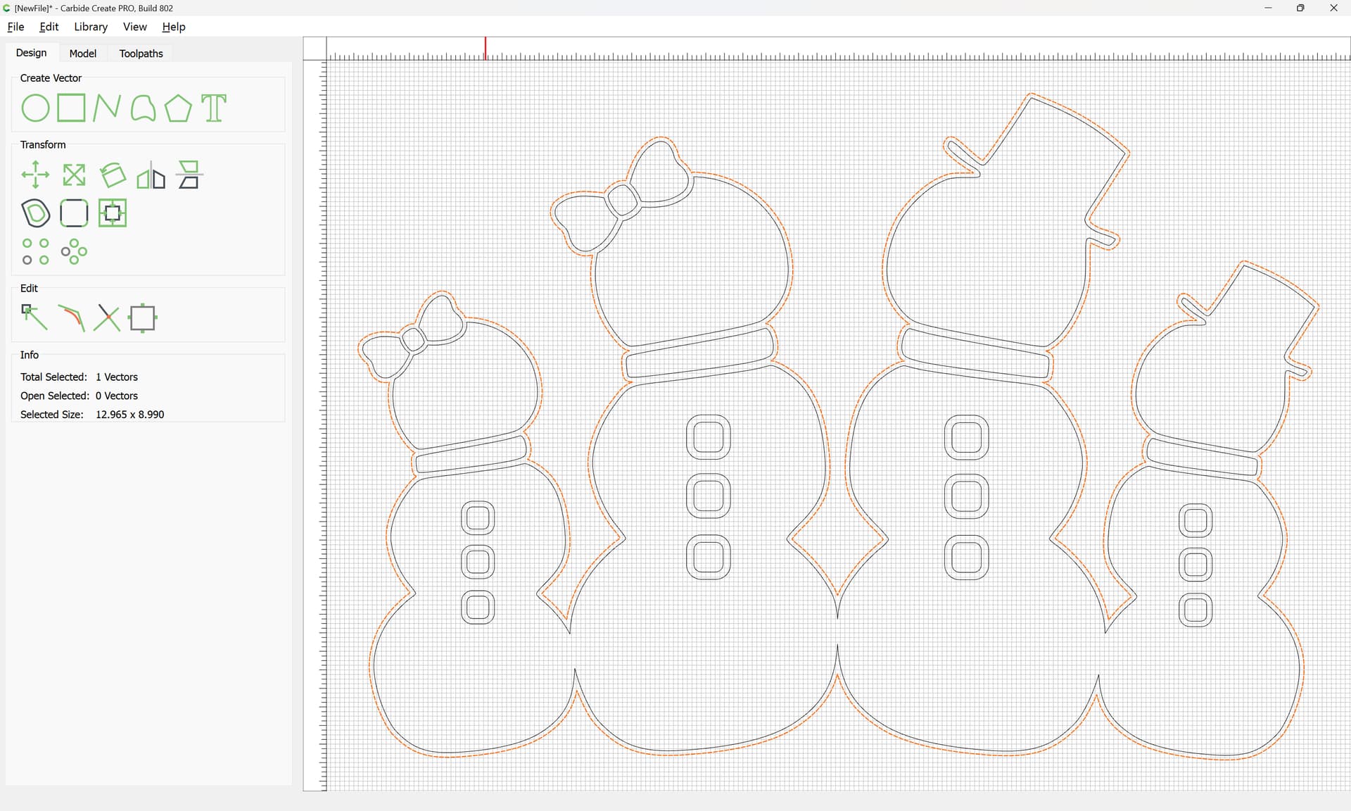

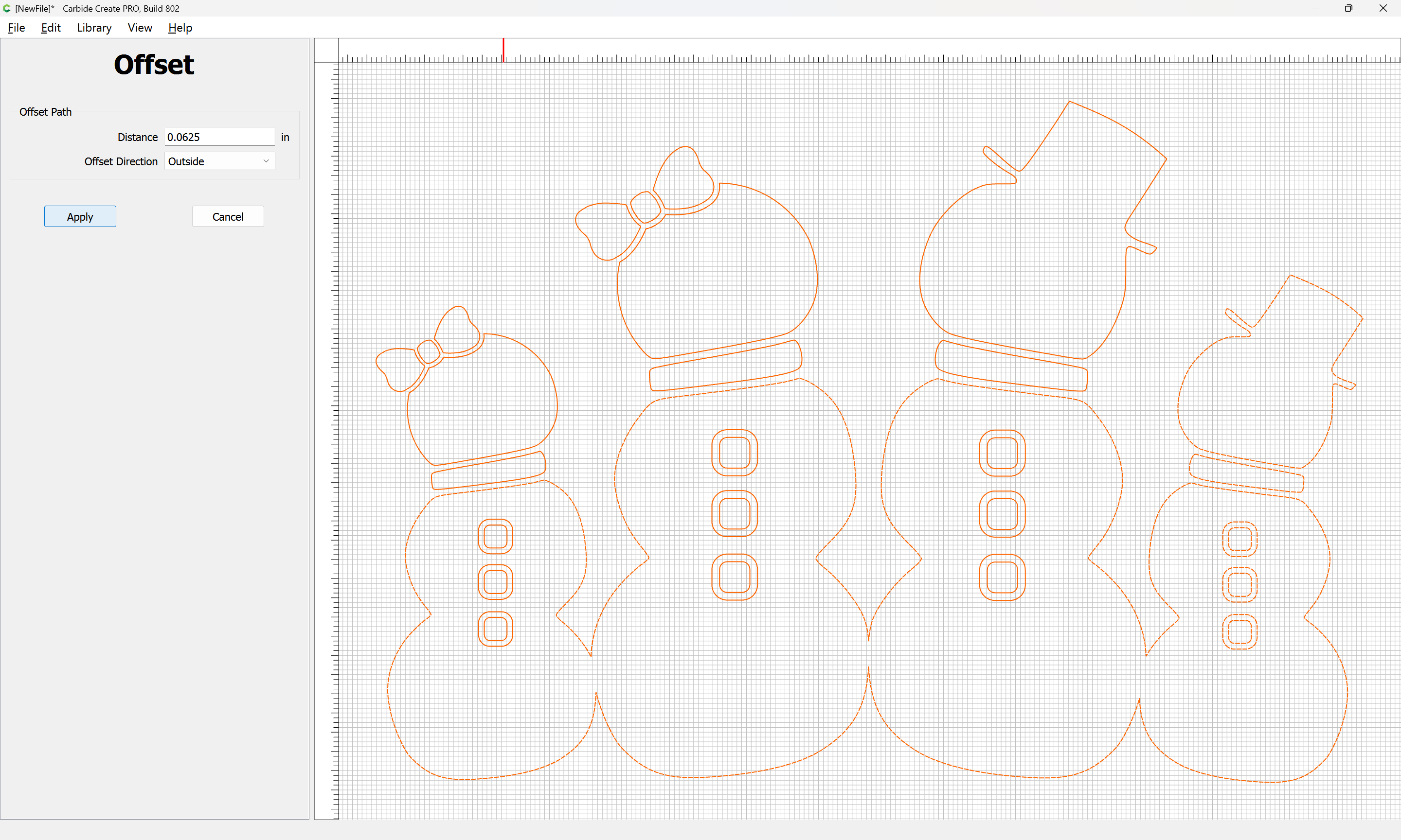

Select all the geometry:

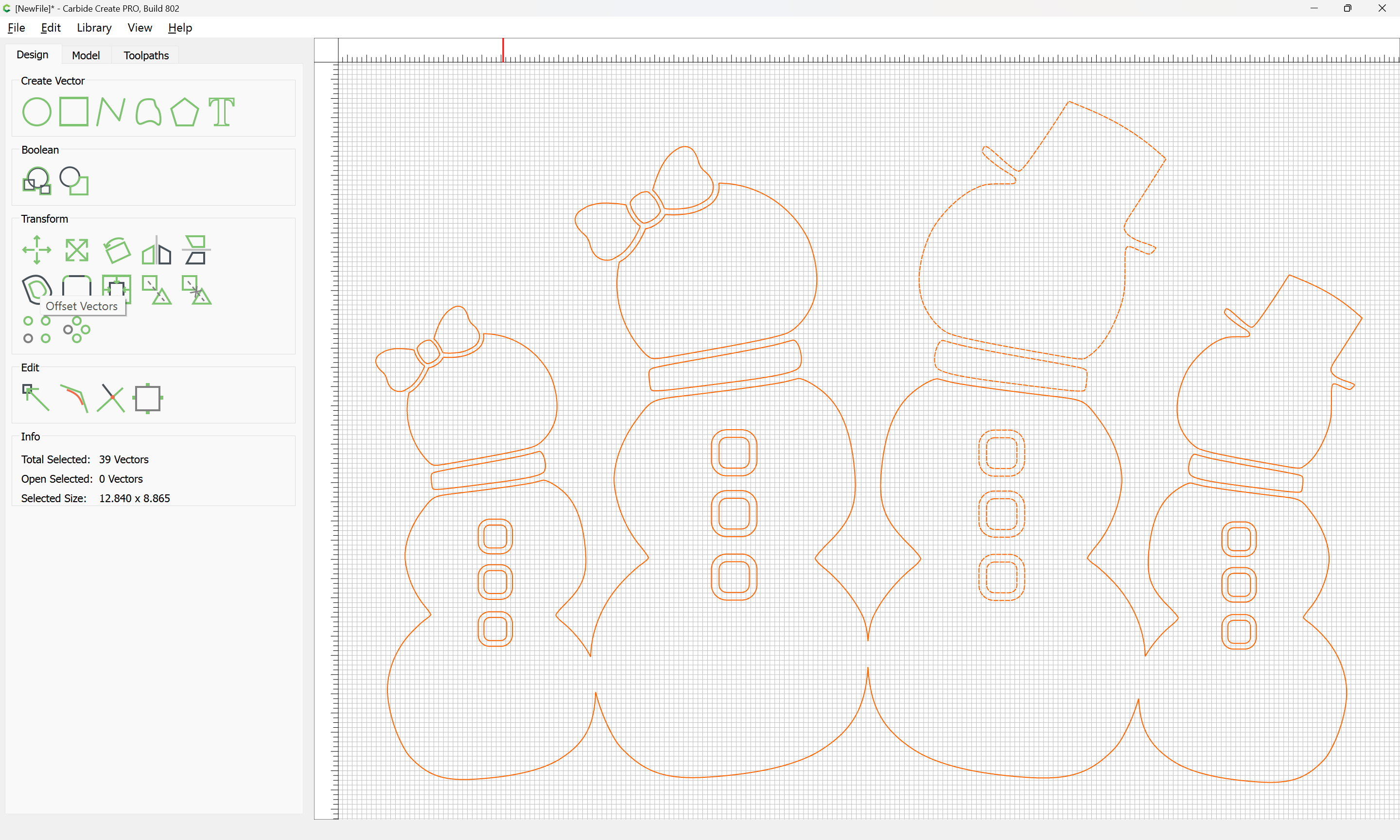

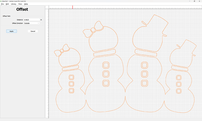

and offset to the outside:
Apply
Attached as a v8 file:
Snow Man Family Template Outline2_v8.c2d (348 KB)
Thank you guys! Got it!
