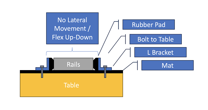

Interesting. So you you bolted the 5 Pro to the table through the mat.
Yep. Have 3x Home Depot Husky 62" tables interlocked in a U shape, with the SO5 taking one of them. Near zero movement no matter how hard I jog the unit. In my case, I was concerned that rear of 2x4 bed overhung the table by 1" - so bolt down gave me peace of mind to negate any chance of shifting.
Another thing I did was Loctite blue all bolts except the waste board center bolts. Seems prudent given the inherent vibrations involved in fabrication…
Please note that the official recommendation here is to not fasten the machine to anything, unless one knows that it is flatter than the machine structure — if you’re concerned about movement, block it in from the sides w/ some suitably padded blocks or angles.
Secured using L brackets with rubber blocks to prevent lateral movement. Should have been clear there…
You are defeating the purpose of the rubber by bolting the machine down.
Let me clarify further with a picture…
Arguably the same could be achieved with drilled holes and rubber gaskets, but I didn’t want to void warranty by drilling rails…
I see, the machine is not actually bolted to the table.
