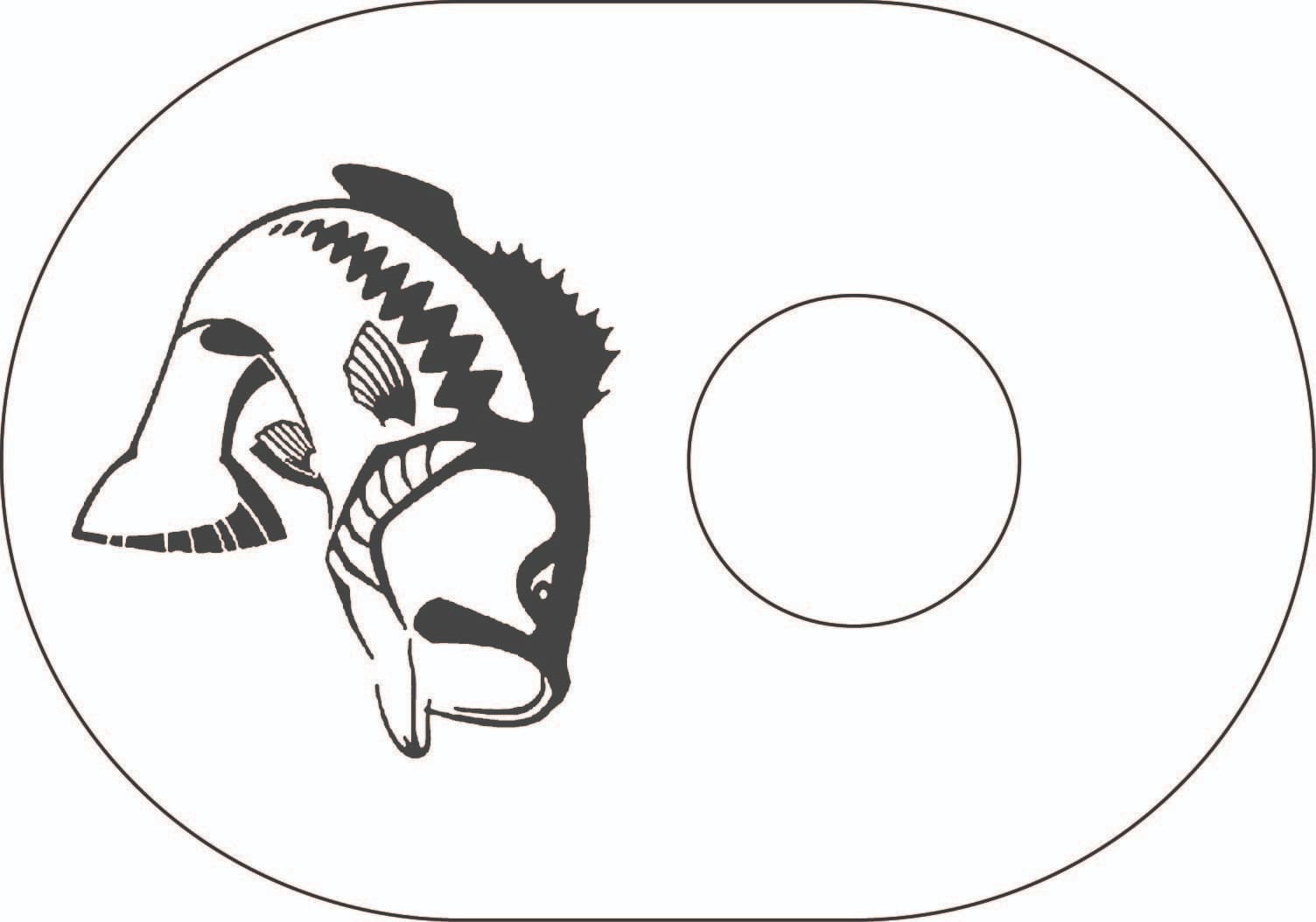

I am looking to make a bunch of blanks in advance and add customization (names, icons, etc) as the orders come in.
I am looking for the best techniques to zero things so that the customizations are placed correctly on the wooden blank. The blanks have rounded edges.

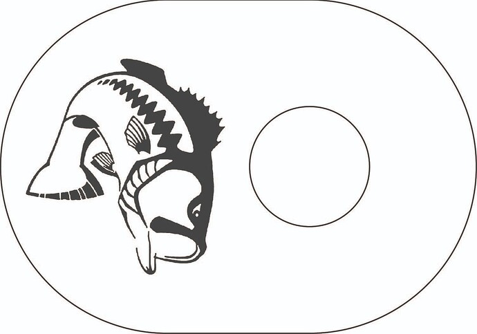

Here is an example of the shape of the wooden blank (the ovalish shape with the hole) and where I would like to add the fish (or other icons).
Any advice would be helpful. Thanks in advance!

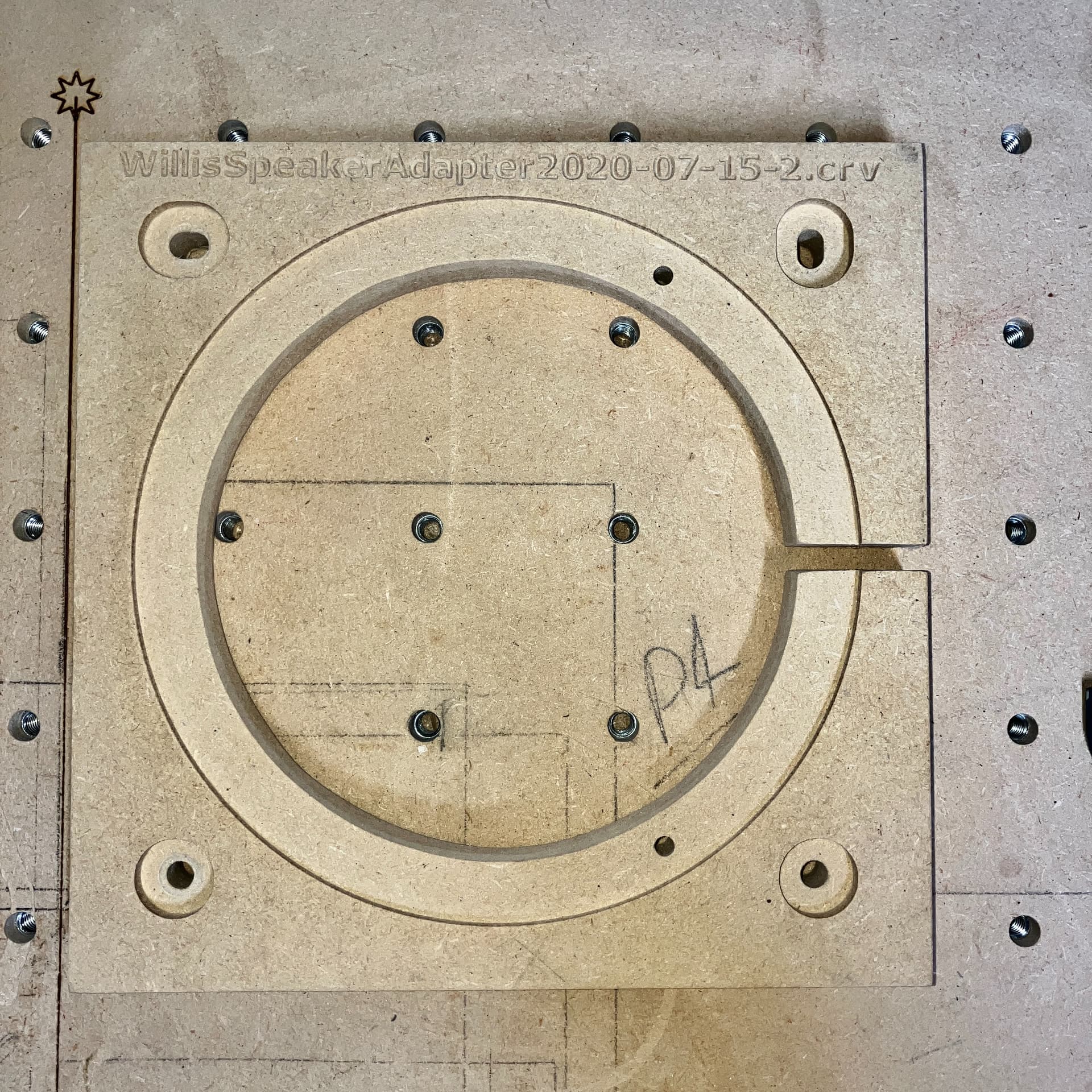

My inclination for odd shapes is to mount a piece of MDF of a suitable size, then cut a pocket in it to accommodate the blank, then secure the blank in the pocket and cut it there w/ that origin.
Bonus points if you set up the MDF as a fixture which can be removed and then replaced in the same position repeatably and if one sets up the origin for the cut to be one of the rapid position points — then cutting such work is just a matter of:
  • mount MDF fixture in correct position
  • go to the correct rapid position point and set XY zero there
  • secure the blank in the fixture
  • set the origin relative to the surface of the blank
  • cut

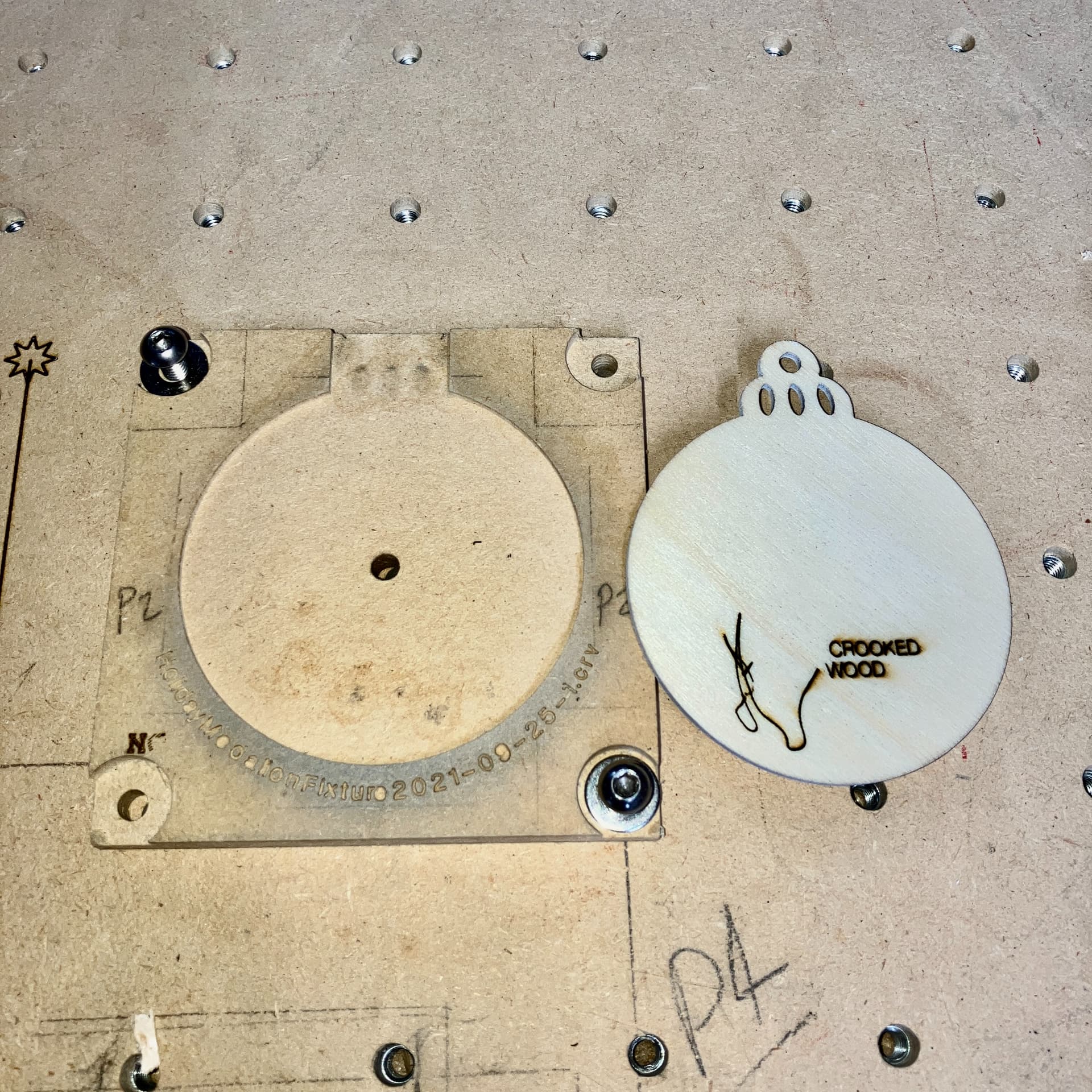

I do what @WillAdams suggests with the additional concept of XY zeroing on the corner of my fixture. So, my design carries all it needs to cut with it to check the zeros.
Yep, that’s an even better idea and more repeatable. If the pocket in the PDF is super snug maybe put a hole in the bottom to assist in removal after cutting.
I do basically the same thing as @WillAdams and @CrookedWoodTex mentioned. I have a piece of MDF thats located with dowel pins to the spoilboard, basically to keep MDF square with X and Y travel. That MDF has pockets for other other projects cut into it.
