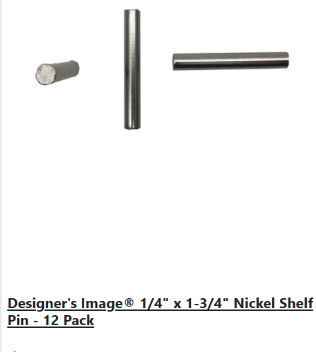

I purchased a slightly used Shapeoko 4 XXL and it is missing the probes for the BitZero v2. Is there something I can use in place of that to get the same results? Or can I order just the probes?
Any precision ground rod will work — such is readily available as tool blanks from machining supply houses or even Amazon. Some folks have even just chucked up a long drill bit and cut off the drill portion…
You’ll want it to be ferrous/magnetic (so the magnet will stick) and I found it worthwhile to order a short length (which didn’t need to be cut/deburred).

Is there a specific diameter needed or just a standard 1/4 inch and 1/8 inch?
One of each is handy when setting XY with BitZero V2 depending on bit size of choice for your project.
Ideally you would use a probing pin of the same diameter as-is needed for the collet of the tool which you will be using.
That said, diameter (so long as it’s concentric) doesn’t matter.
When I’m lazy I’ll often use an 8mm probing pin (since it doesn’t need a collet on my spindle setup) because the 1/4" and 1/8" collets already have tools in them.
Could I use a threaded rode that is 1/4 inch until I can get a tool blank?
Rather than a commodity thing like that, I’d just use the 1/4" tool (so long as it doesn’t have a non-conductive coating).
When you are referring to the 1/4 inch tool, what are you referring to?
Whichever 1/4" tool you will first be using.
The probing pins are provided to make up for the possibility that flute geometry will interfere with an accurate probe operation — so long as it’s reasonably deep (and not single flute) the probing usually works as expected.

This is what I bought six years ago… HHIP 4103-0250 Replacement Pin Gage, P-1 (-0.0002) Tolerance, 0.25": Amazon.com: Industrial & Scientific
But as Will also mentioned, you have options.
I use the shank portion of a 1/4" end mill I broke years ago. I also have the 1/8" version. :roll_eyes:
I have used a broken bit that was next to my machine that fit the collet I had in.

I found a 12 pack of shelf pins that I used for a tiling project a while back that would work in a pinch.
