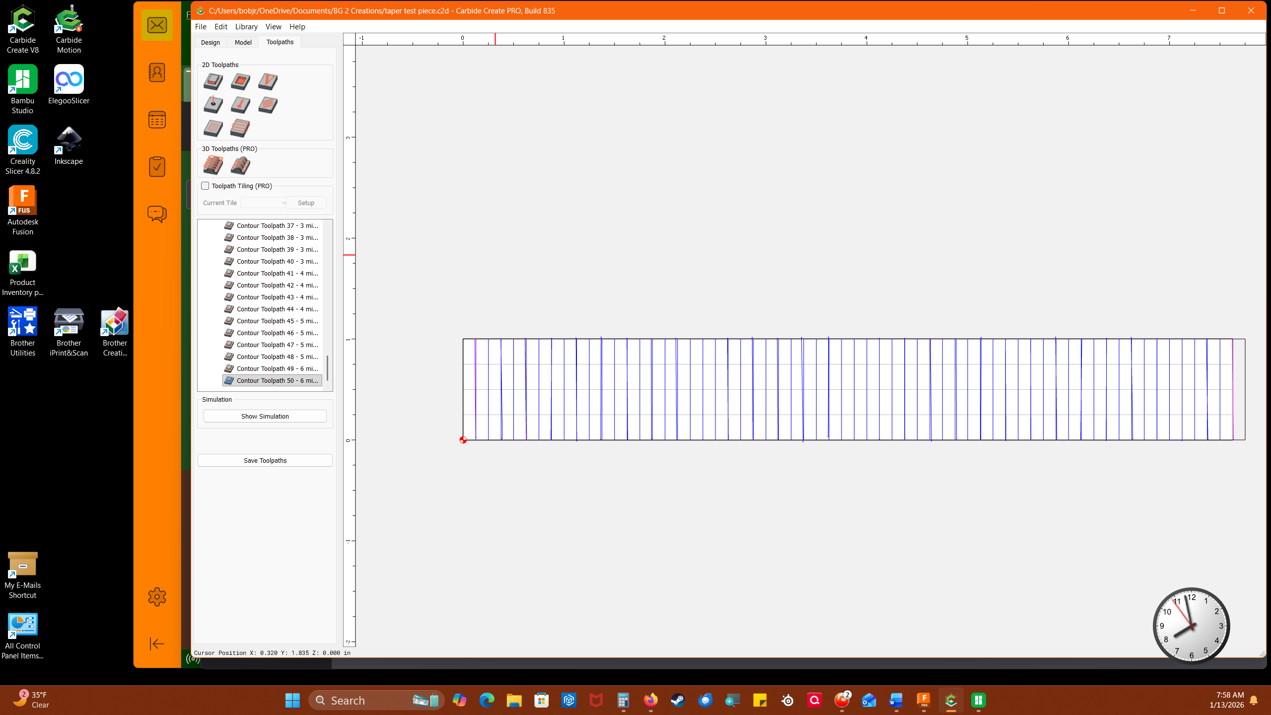

Thanks to everyone for your help. This angle is just a part of the work piece to be made, and as I wish to machine said work piece in place once I clamp it down, using a fixture to set it at an angle is unacceptable for me. I may have to use multiple CNC programs to complete the part, but I do not want to move the part, until done. I am trying to design this piece and learn fusion at the same time. I played withe ramp feature in Fusion but was unable to get it to rough angle out from a piece of square stock.only got it to finish angle if part was already roughed out. So I went back to my design in CC pro and finished angle in that program. it is not perfect but angle will be hidden anyway, plus I should be able to fix imperfections with hand tools.
