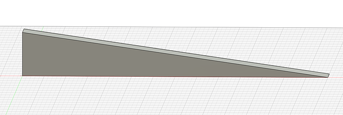

I have just been trying to figure this out so do not have part actually drawn up yet . wanted to find solution first. the above pic is from fusion
If you are using Fusion, why not use its CAM?
That said, if you’ll export an SVG or DXF or make a screen grab or something we can walk through this w/ you.

I think that if you are doing this part in F360’s Design tab, that using it’s Manufacture tab for the toolpaths would be the best way to cut that. I would use a 1/4" or larger ball endmill and a Ramp toolpath to make this feature.
The other option if you have designed it in F360 is to export it as a mesh (STL) and have Carbide Create Pro 3D machine it.

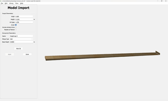

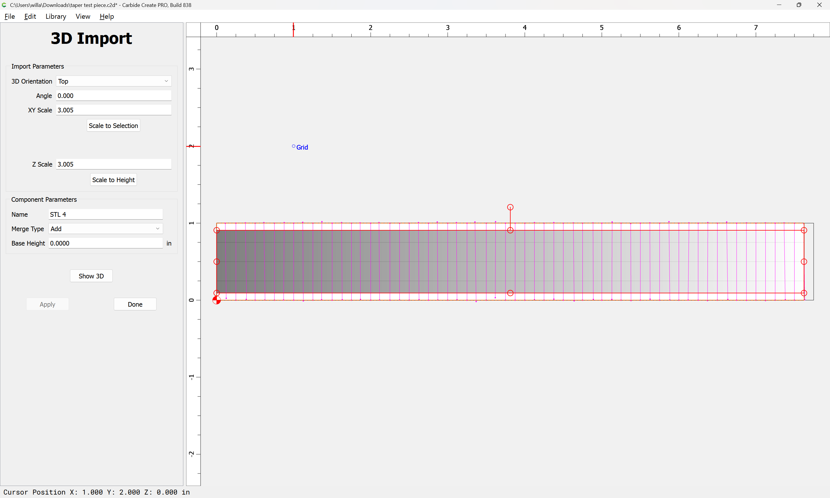

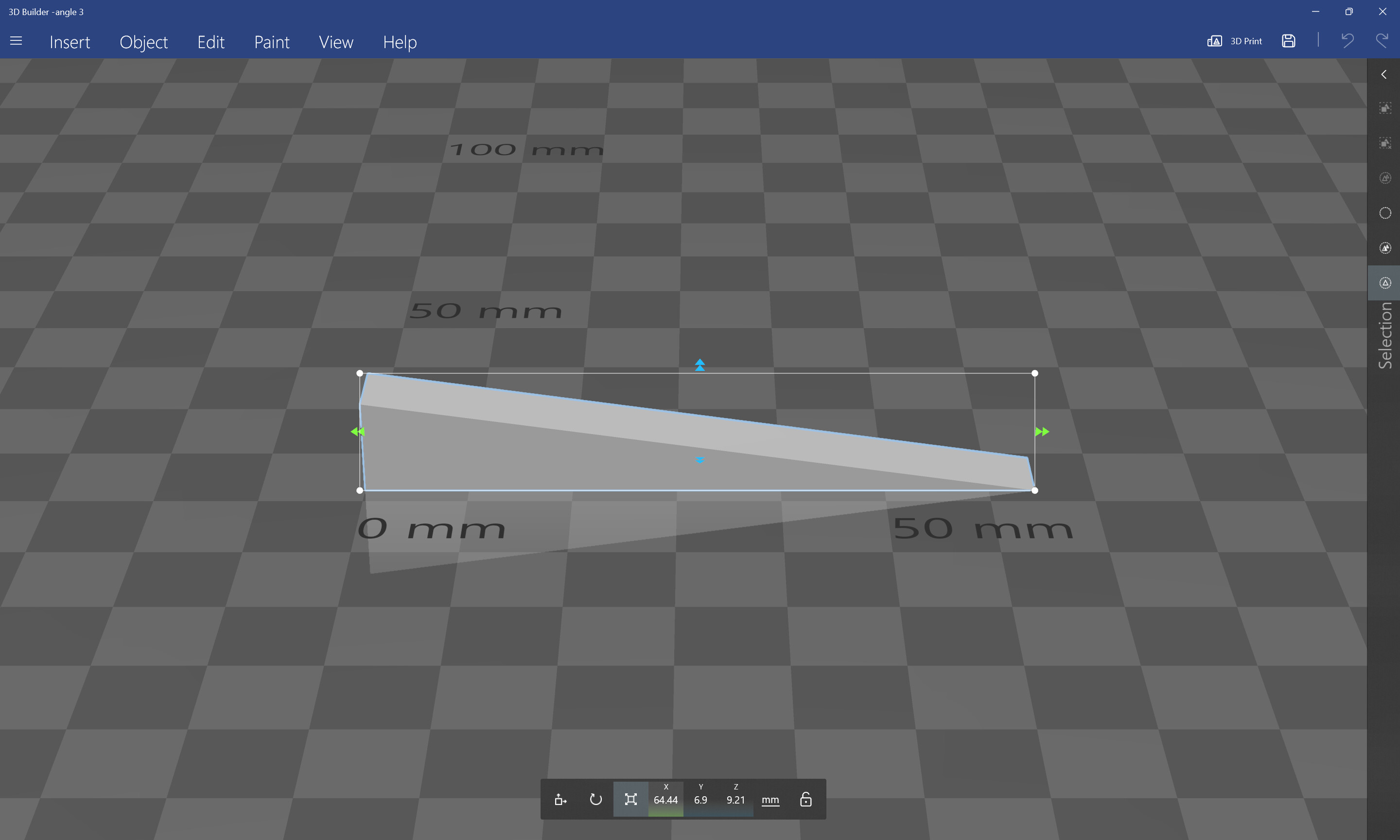

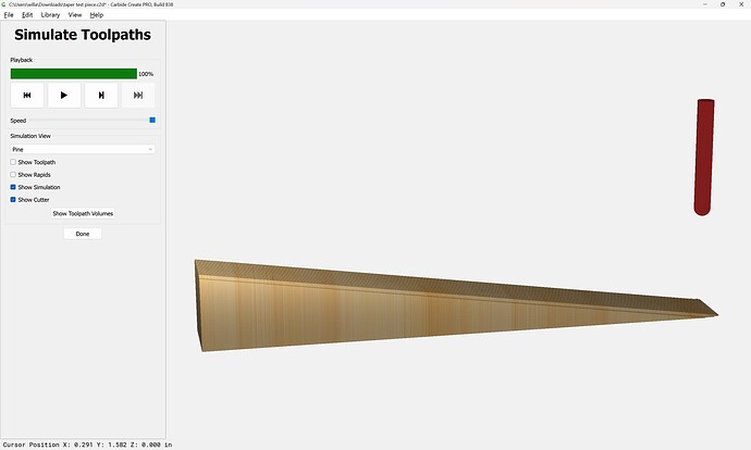

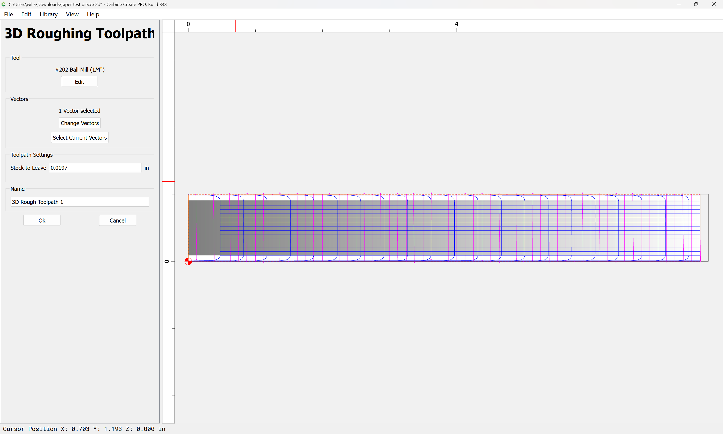

The easy way is to use the STL:
The file is:

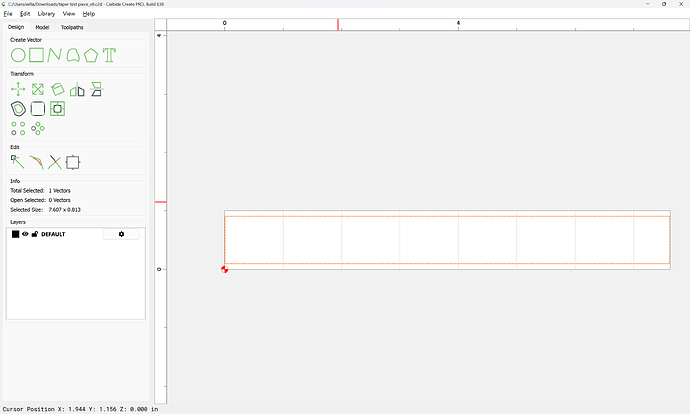

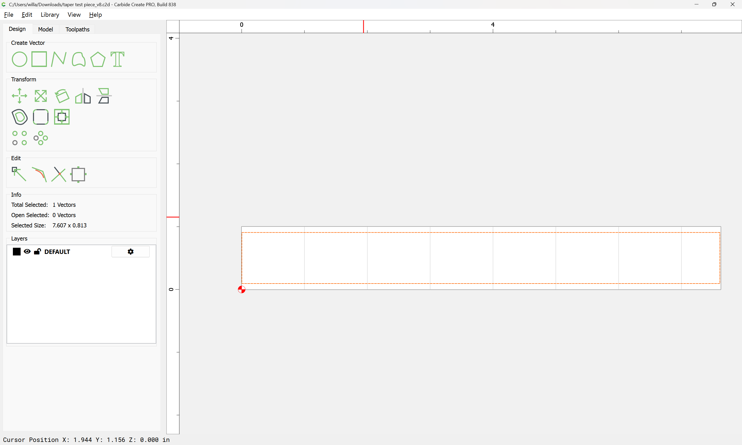

Draw geometry:
Import the STL:
which imports a bit too tall:
which may be adjusted by changing the stock size or model.

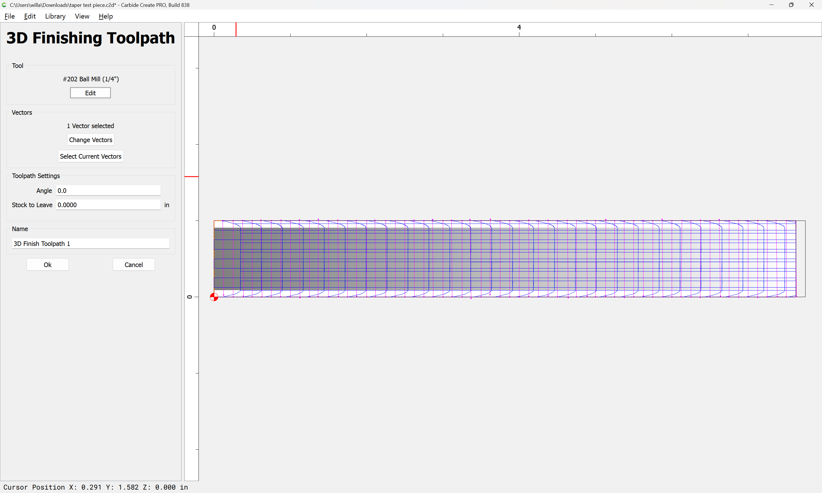

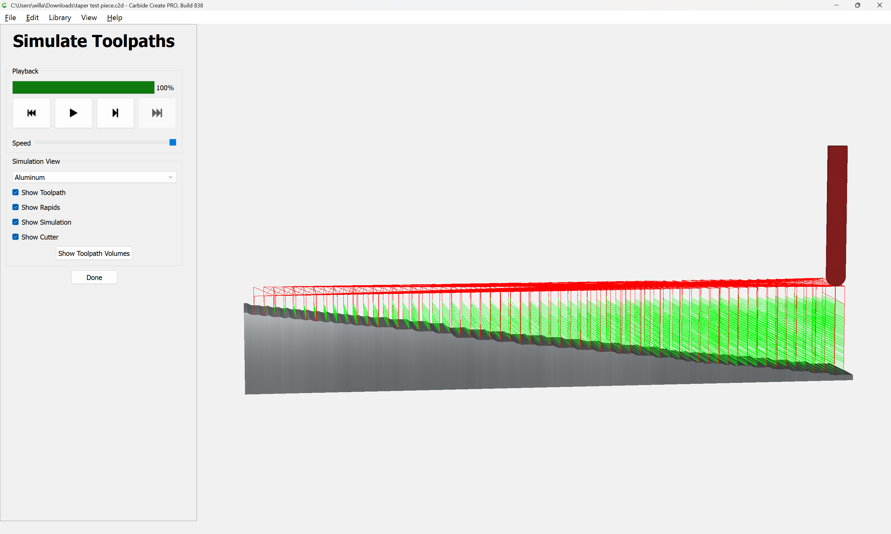

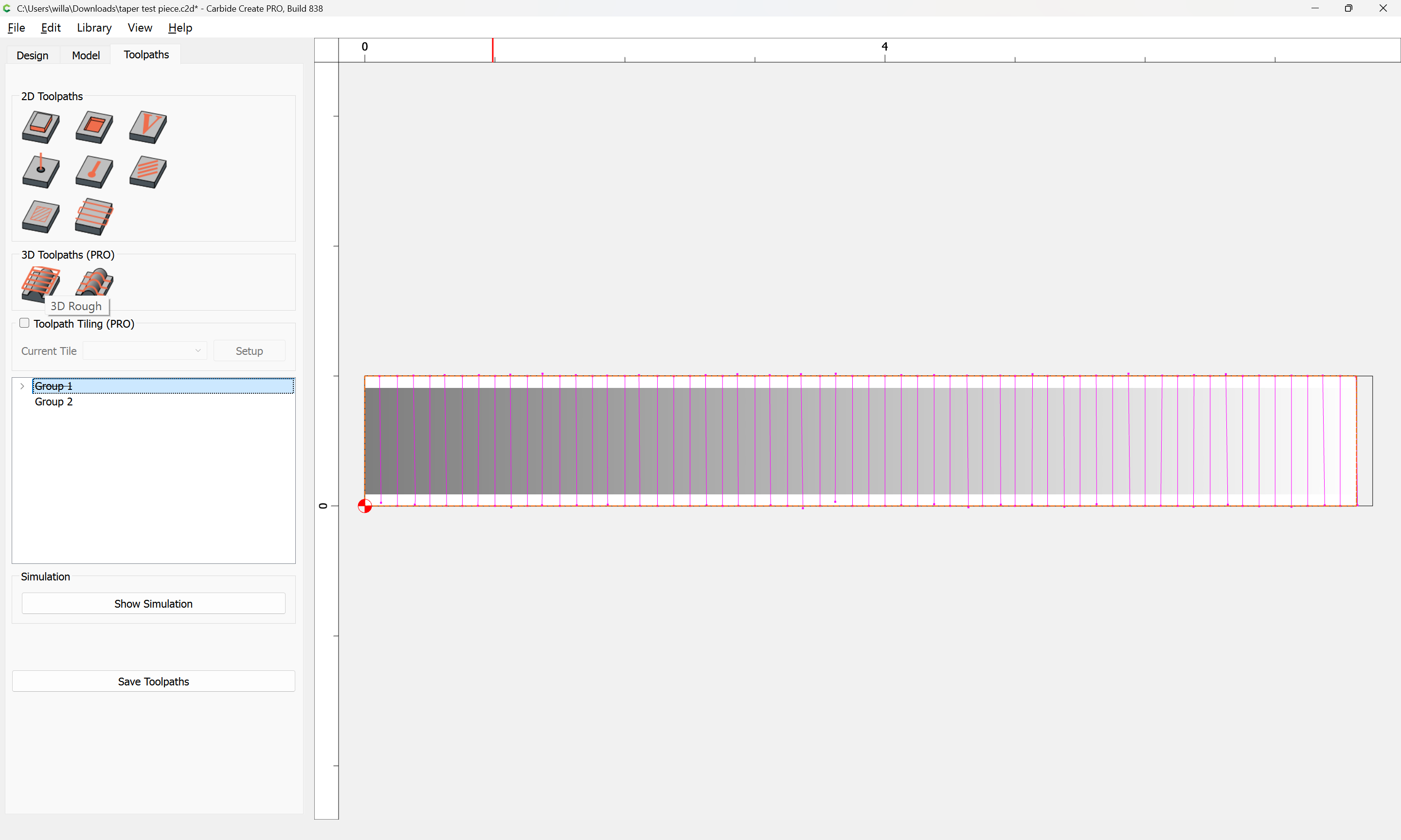

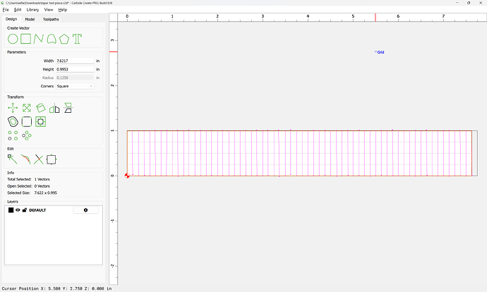

Then apply 3D toolpaths:
j
adjusting the stepover.

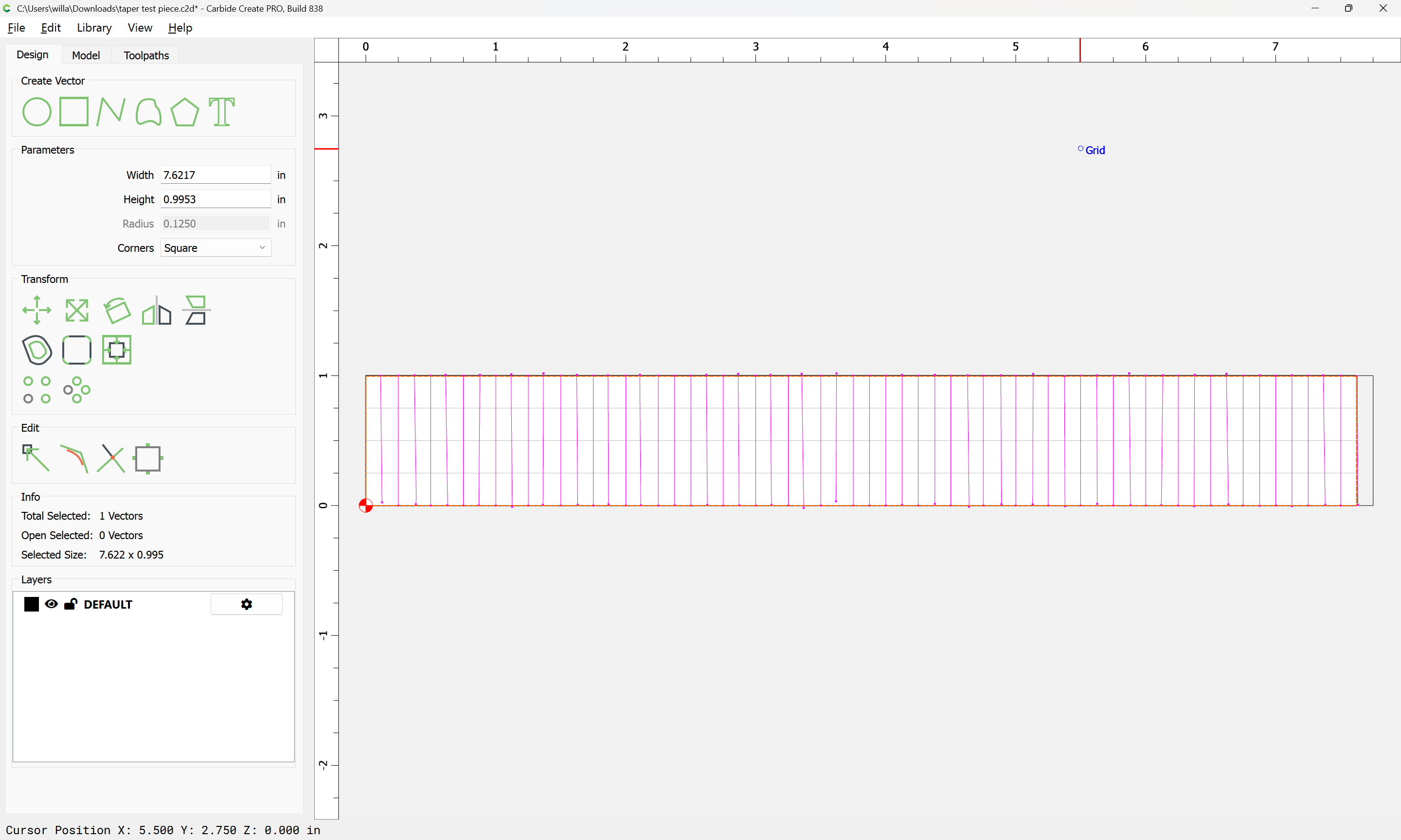

Next, we model using the file.

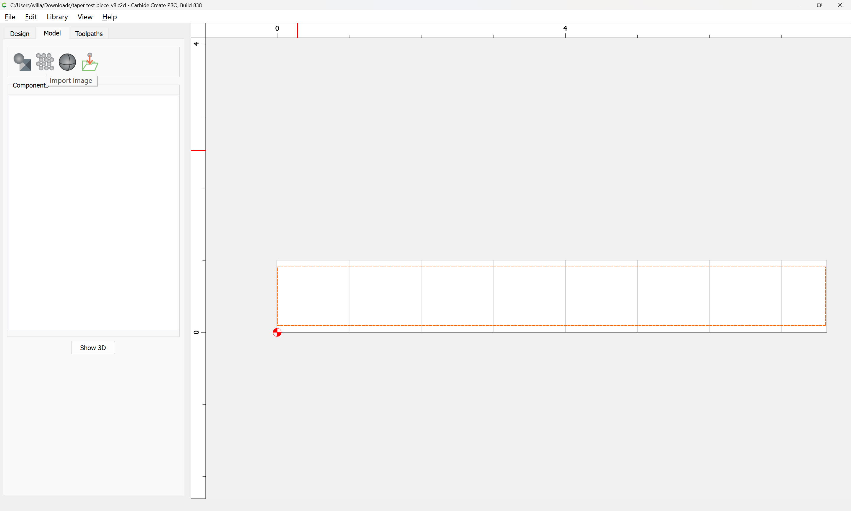

Draw a rectangle of the desired dimensions:

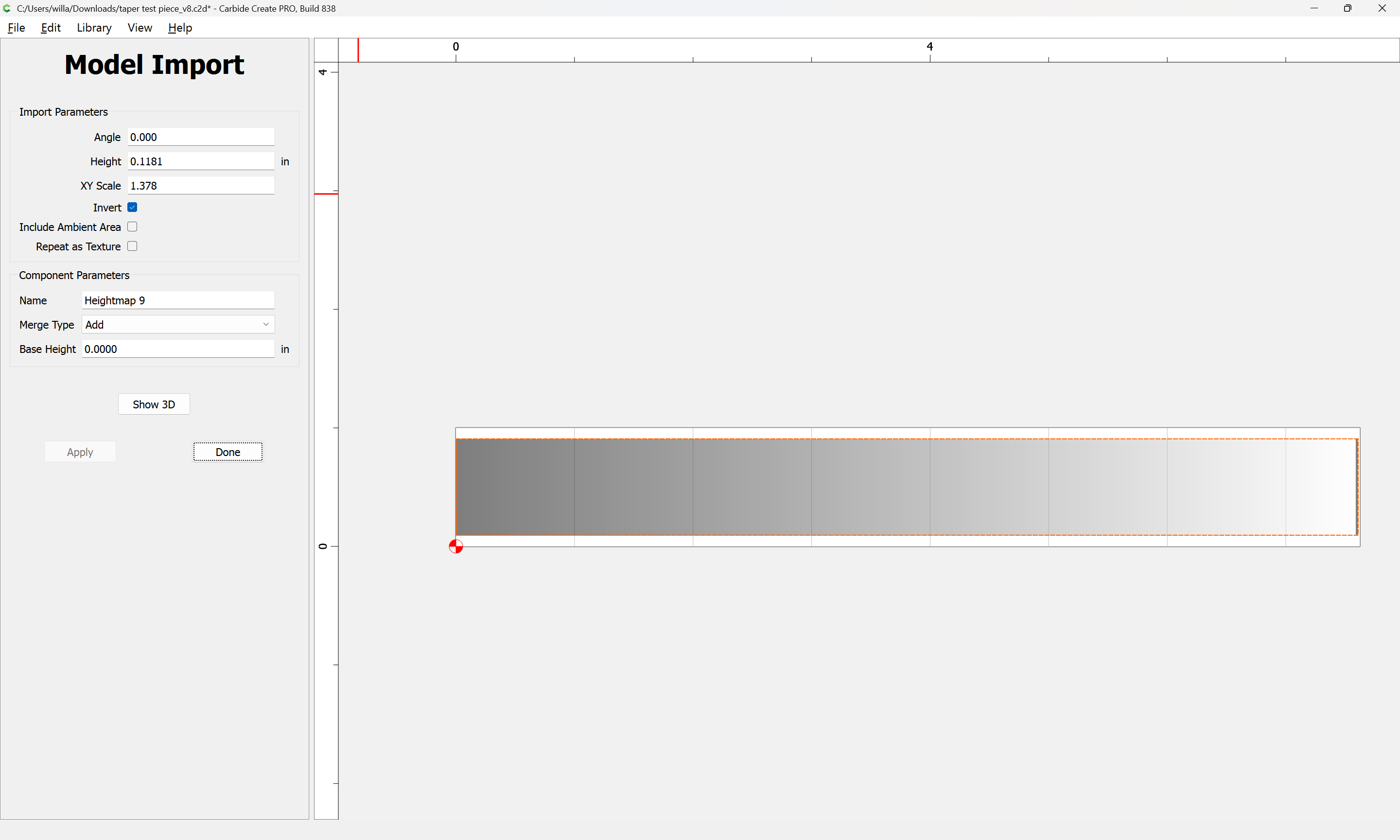

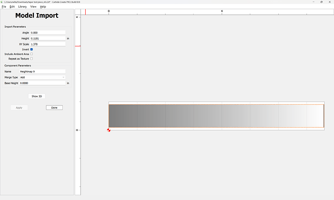

Switch to the 3D modeling tab:

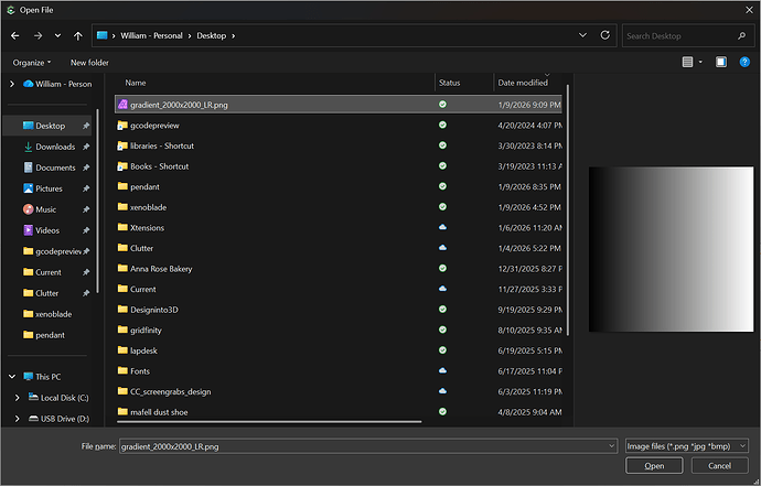

Import Image:

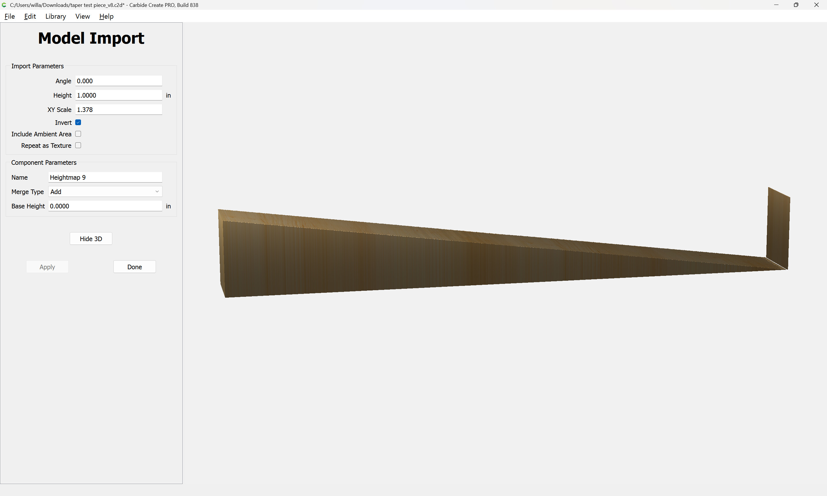

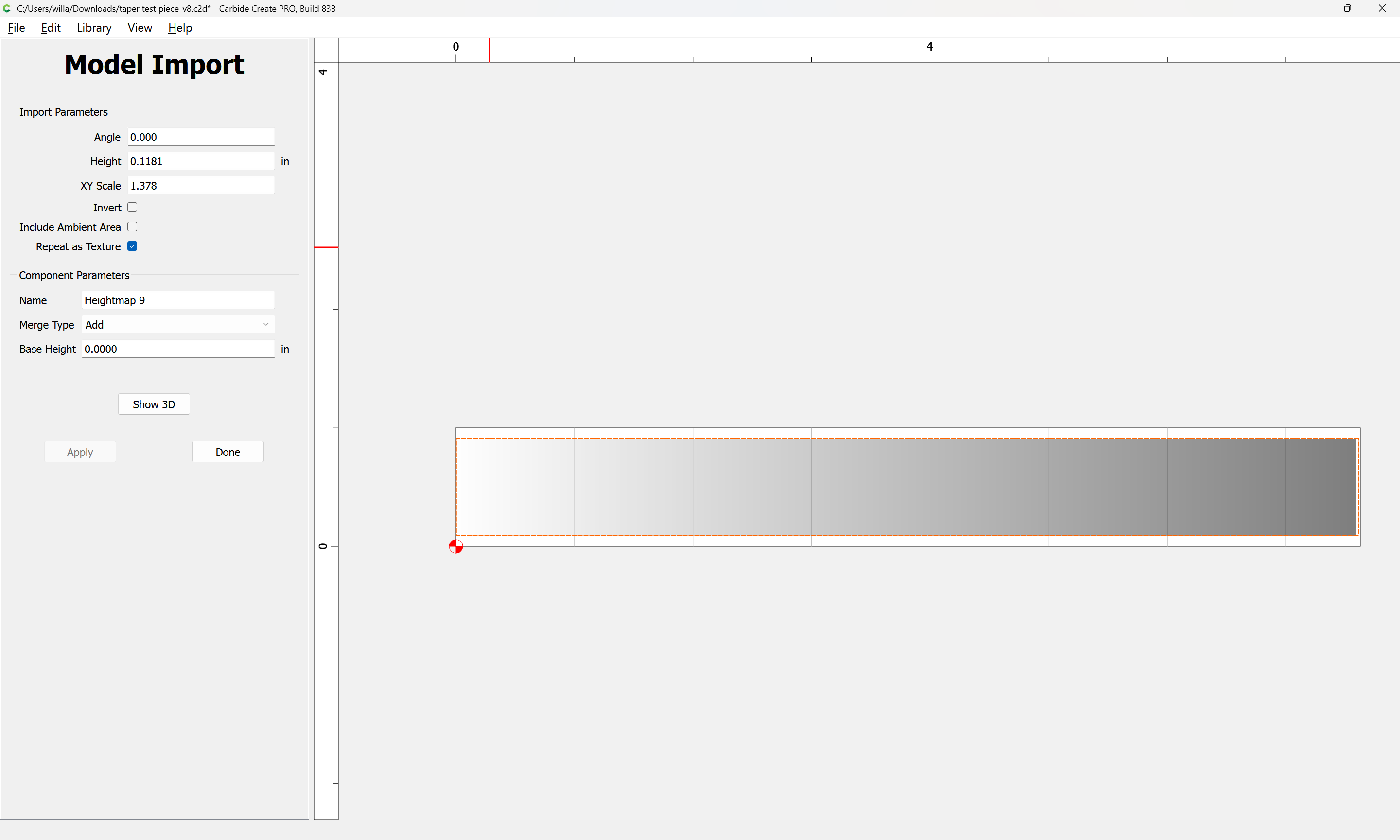

selecting a left–right gradient:
If need be, check Invert:

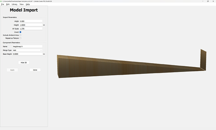

Adjust the Height until one arrives at the desired angle:

I 3d print my spacers to exact height and shape. They could be machined.
