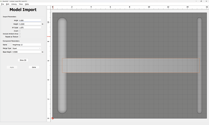

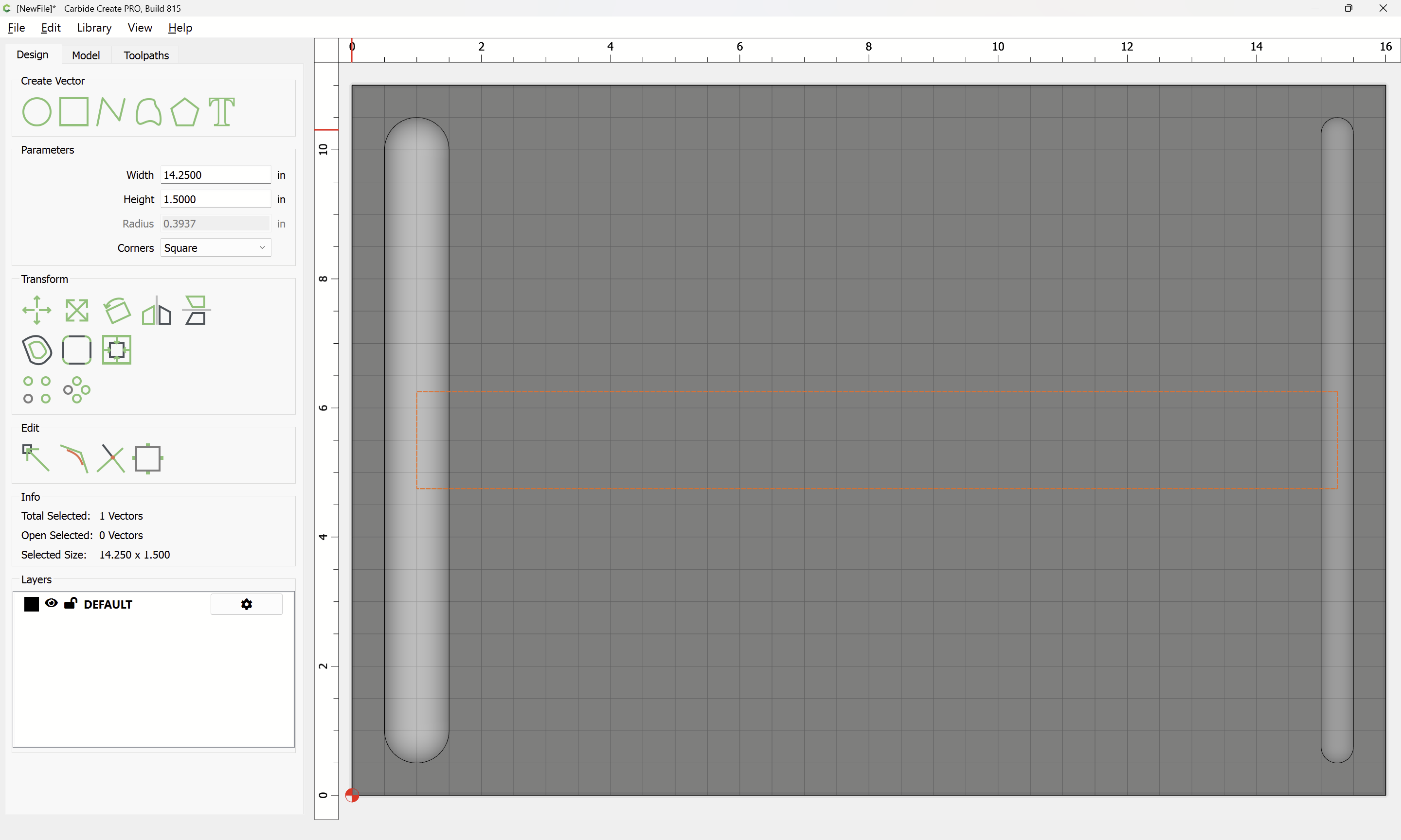

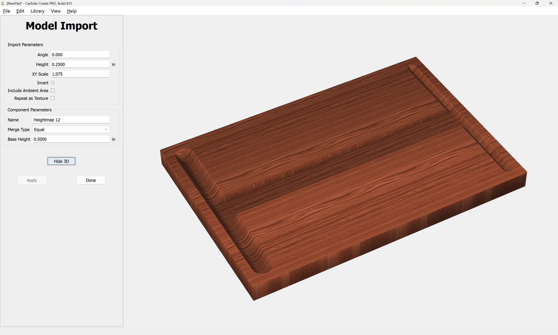

Given a design which for example is 1" thick and has a 1/4" groove at one end and a 1/2" groove at the other:
then one can draw a rectangle connecting those two depths:
and then import the appropriate gradient file:
to arrive at:

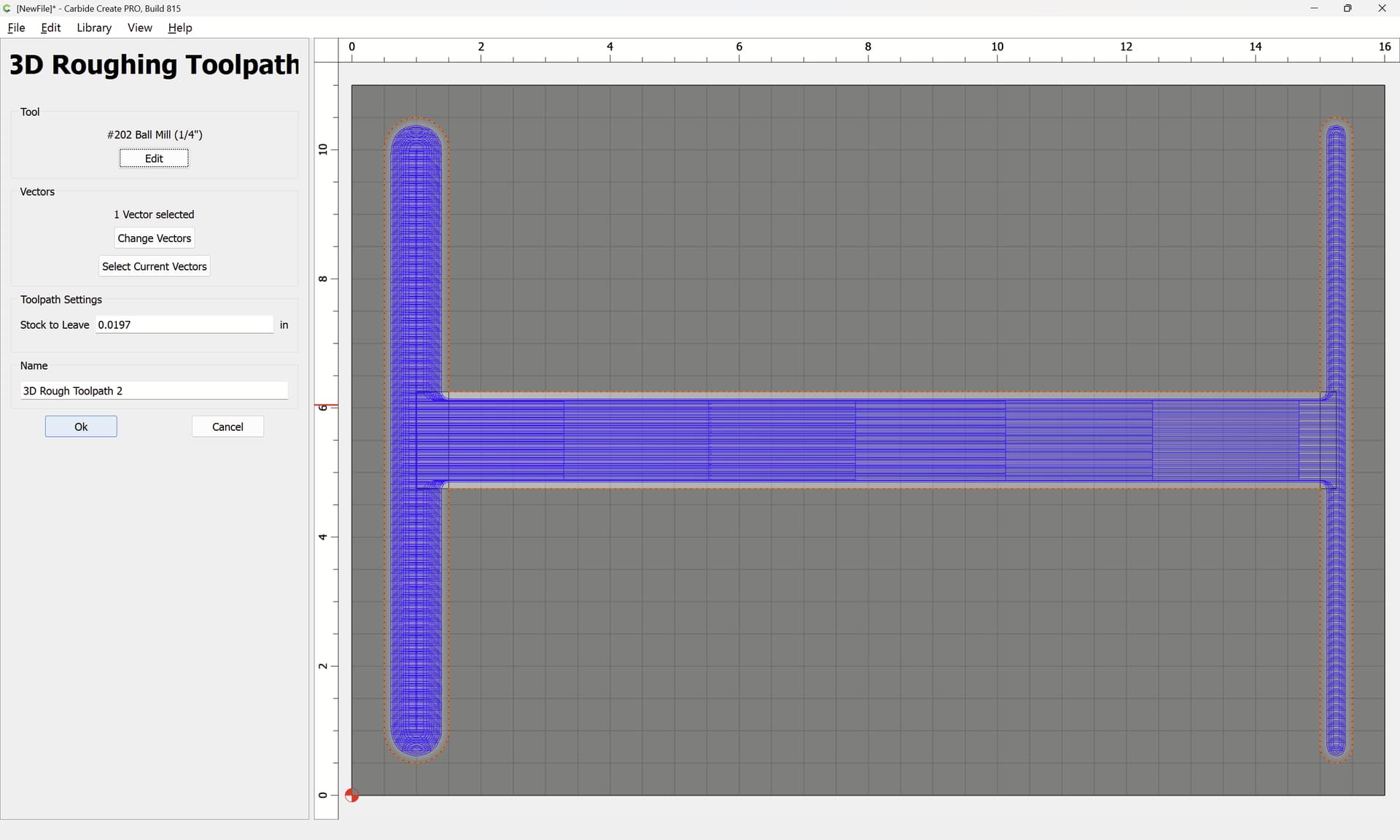

which may then be cut with rounded edges using a ball-nose tool:

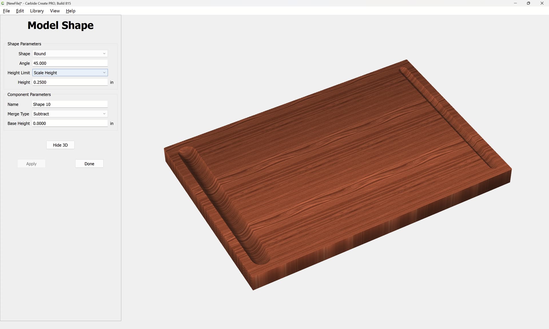

Can I use this method to make round overs and bevels?
Bevels yes, roundovers would require a different graphic, one which I’ve begun looking into (basically the dark/light has to vary based on a trigonometric function).
That said, either of those are far more easily done w/ specialty tooling rather than trying to model in 3D.
Bevel is just a pass w/ a V tool, while there are specialty roundover tools which may be used:

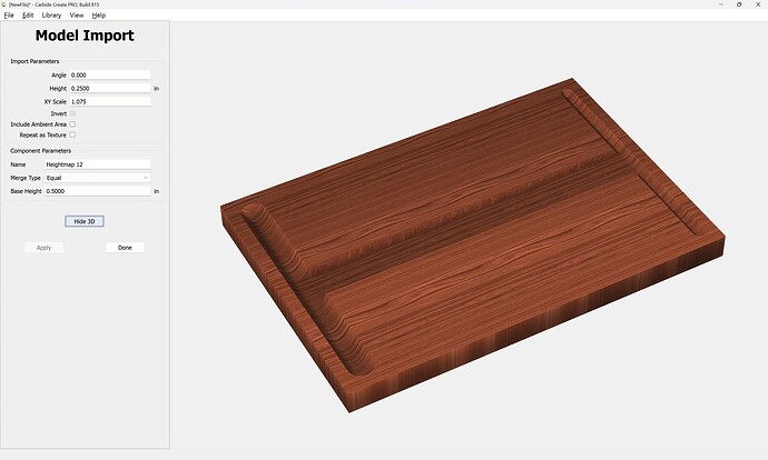

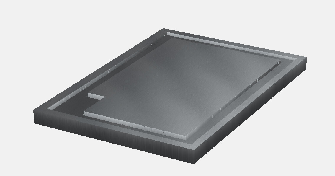

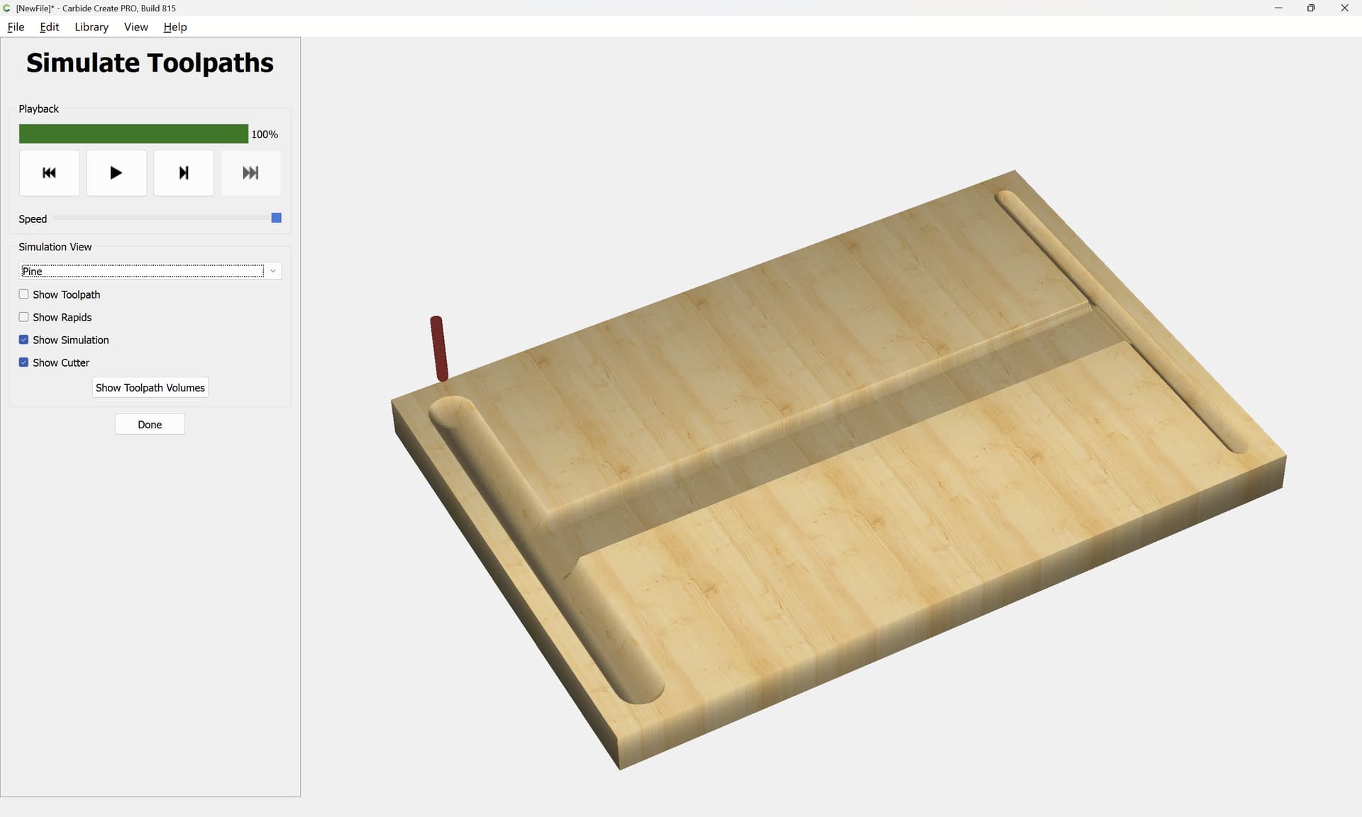

Yes…I had mentioned this before…it’s a great method and really works well. I used it on this graduated cutting board channel:
Which results in:
which creates a gentle ramp from top right to lower left…draining everything into the cutout.
I use Photoshop…which, with layers and all, make it easy to create the gradient and then cut it to whatever shapes you want. In this case, the gradient is on the diagonal.
