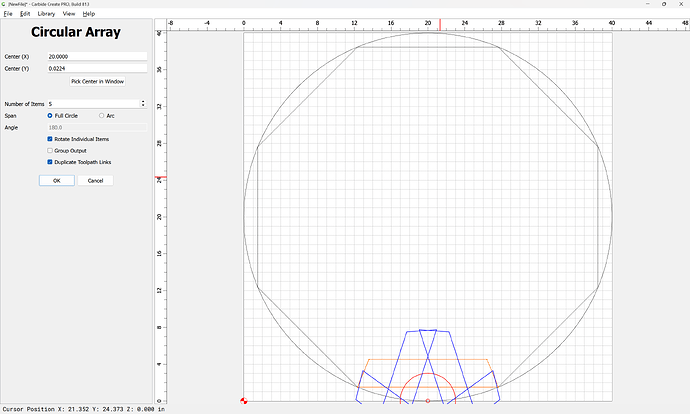

which radius does CC use? Circumcircle radius (R) or Innercircle Radius (r)
This is pretty easily checked in Carbide Create. First, draw a 40" diameter circle:
Then, draw a regular polygon:
and one sees that the regular polygon is inscribed inside the circle, and changing to an octagon:
Preserves that.
If one wants a specific perimeter thickness, this is easily done by rotating the octagon so that the top/bottom are orthogonal to the XY coordinate system:
Done

Note that one wants to Join Vectors":
One may verify that this will work by using a Circular Array to replicate as desired:
Pick Center in Window:
Increase the number of elements:
