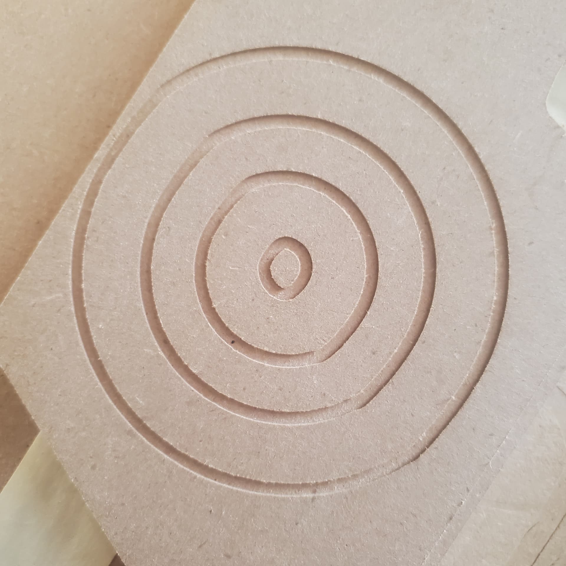

I appear to be losing steps, I’ve been trying to narrow it down but I can’t figure out what is causing it. Can anyone help?
I’m attaching a pic of test circles
Are all of your couplers securely in place?
I agree with Will. Skipped steps cause a drift overtime. That looks like backlash, which is likely:
  • A loose coupler.
  • The DAC bearings holding the ball screw are loose.
  • The ball nut is loose.
That was the issue, thanks so much guys, I appreciate it!
