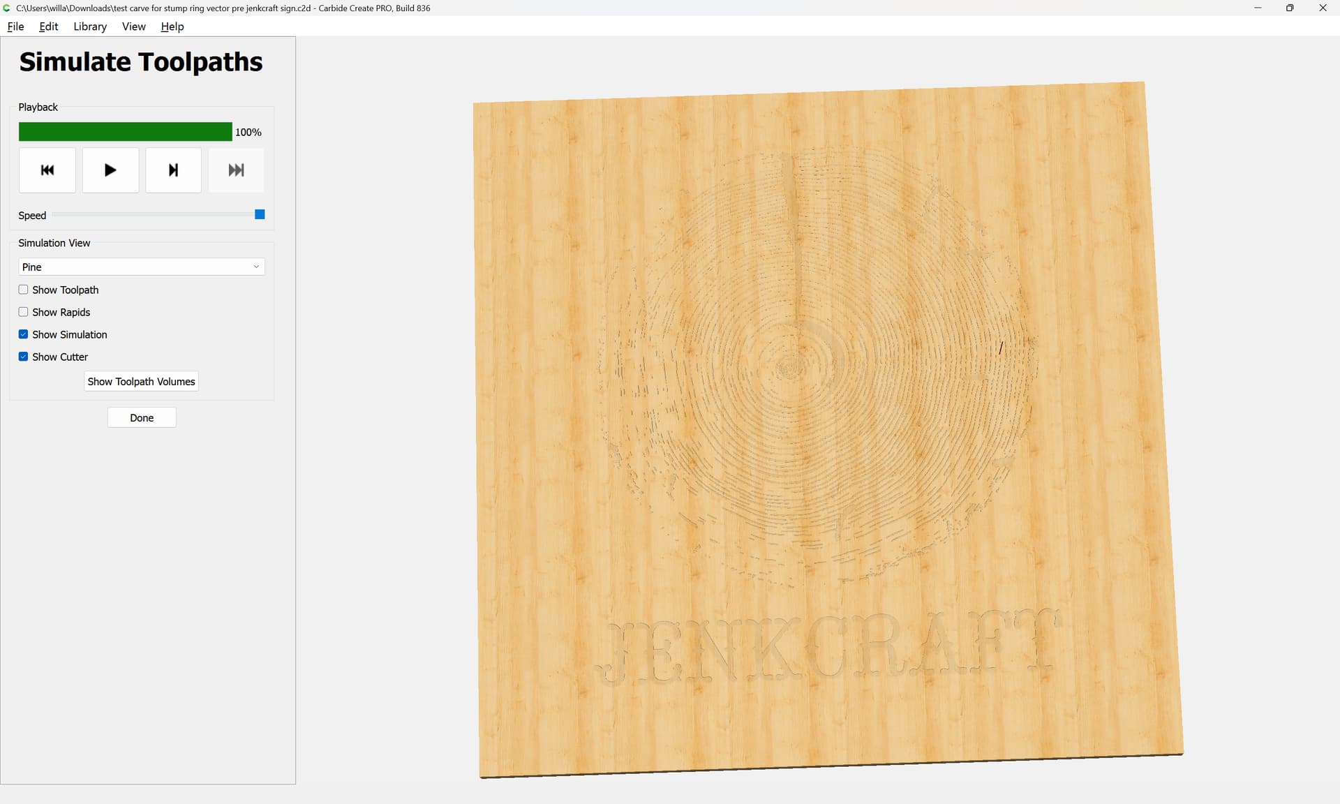

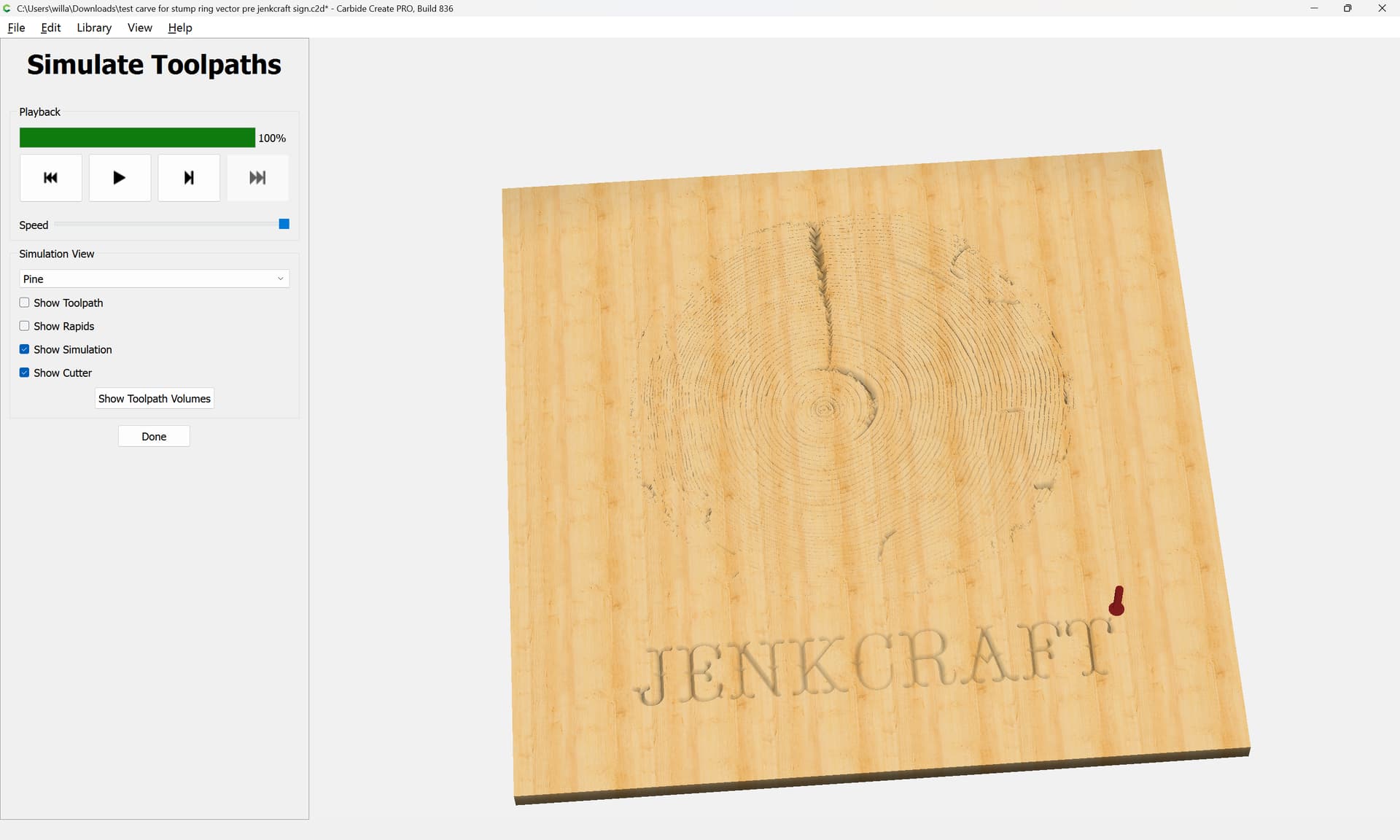

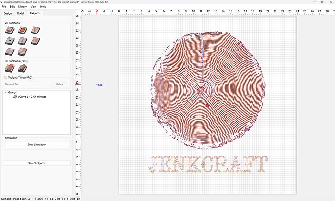

Im having a new and rough issue with my 5 pro 4x4.
When I start a new job, the spindle is lowering to the wood, it is shaking and dropping incredibly slowly. Something is wrong for sure.
It doesn’t do this when setting zero on bit setter or when jogging from place to place, only when working the project toolpath. Any ideas on how to fix this?

Ill note that building the toolpath view for simulation is very slow because it is a detailed image traced STL

Saw your ticket in the queue, and we’ve responded there asking for more information.

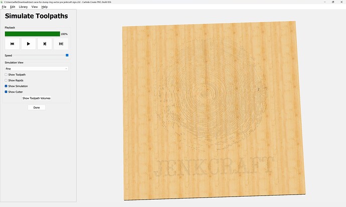

Looking at your file:

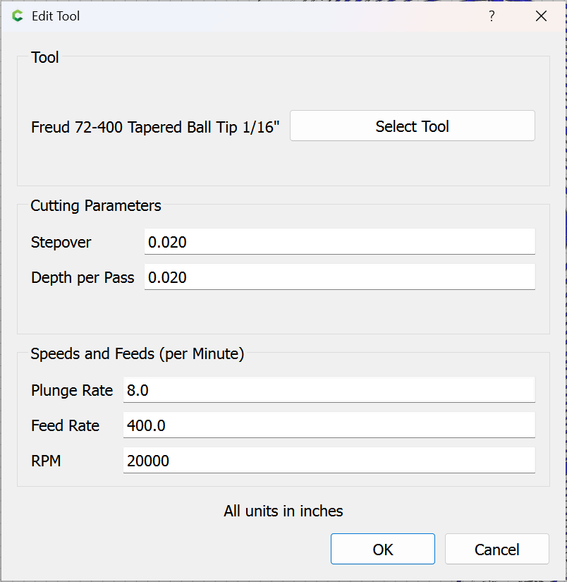

It is quite a large design, and you are cutting quite shallowly with your tool and plunging very slowly:

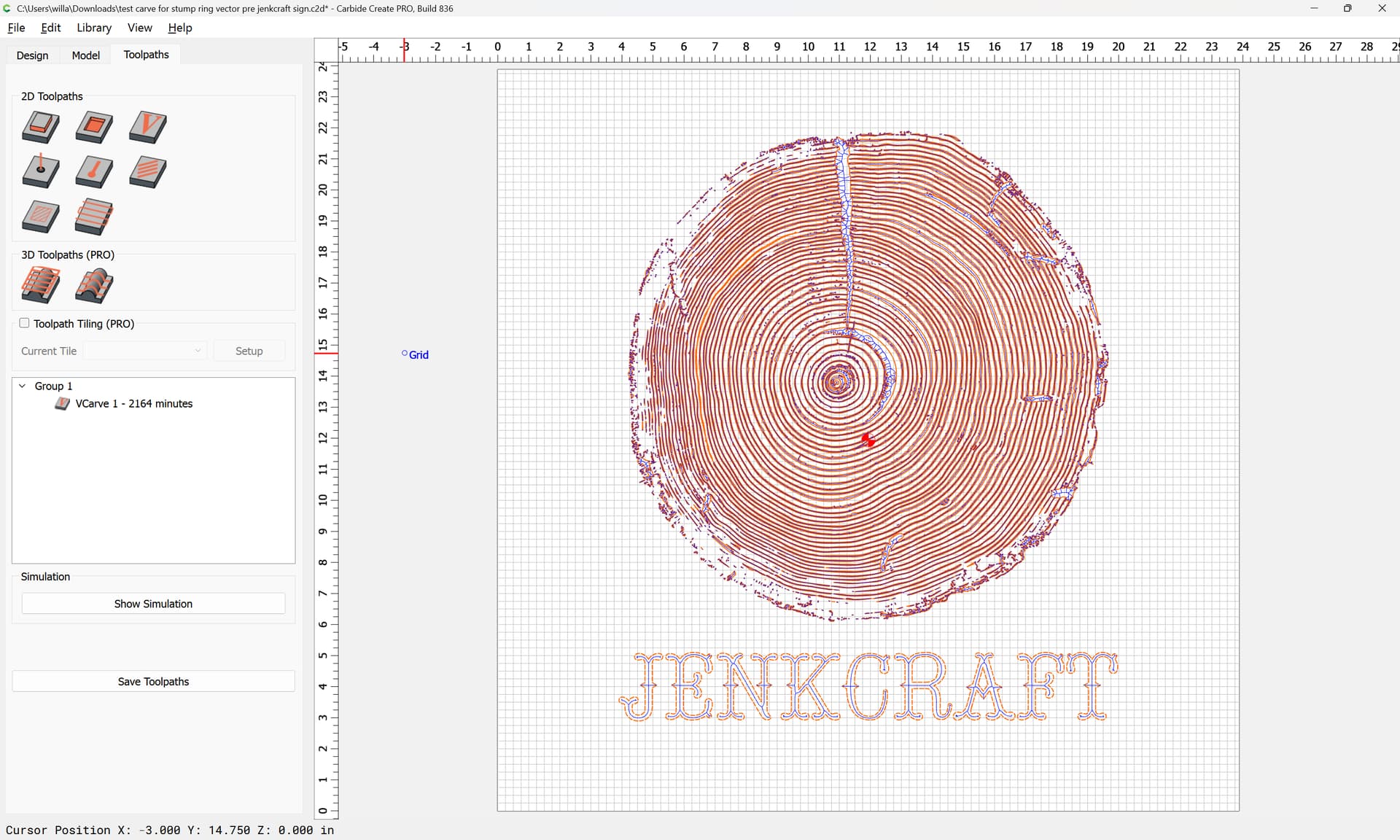

Tried setting it up as a V carving toolpath, but there were a lot of retracts:
Do you think it just has too much going on? Maybe I need too refine the image trace down a bit more?

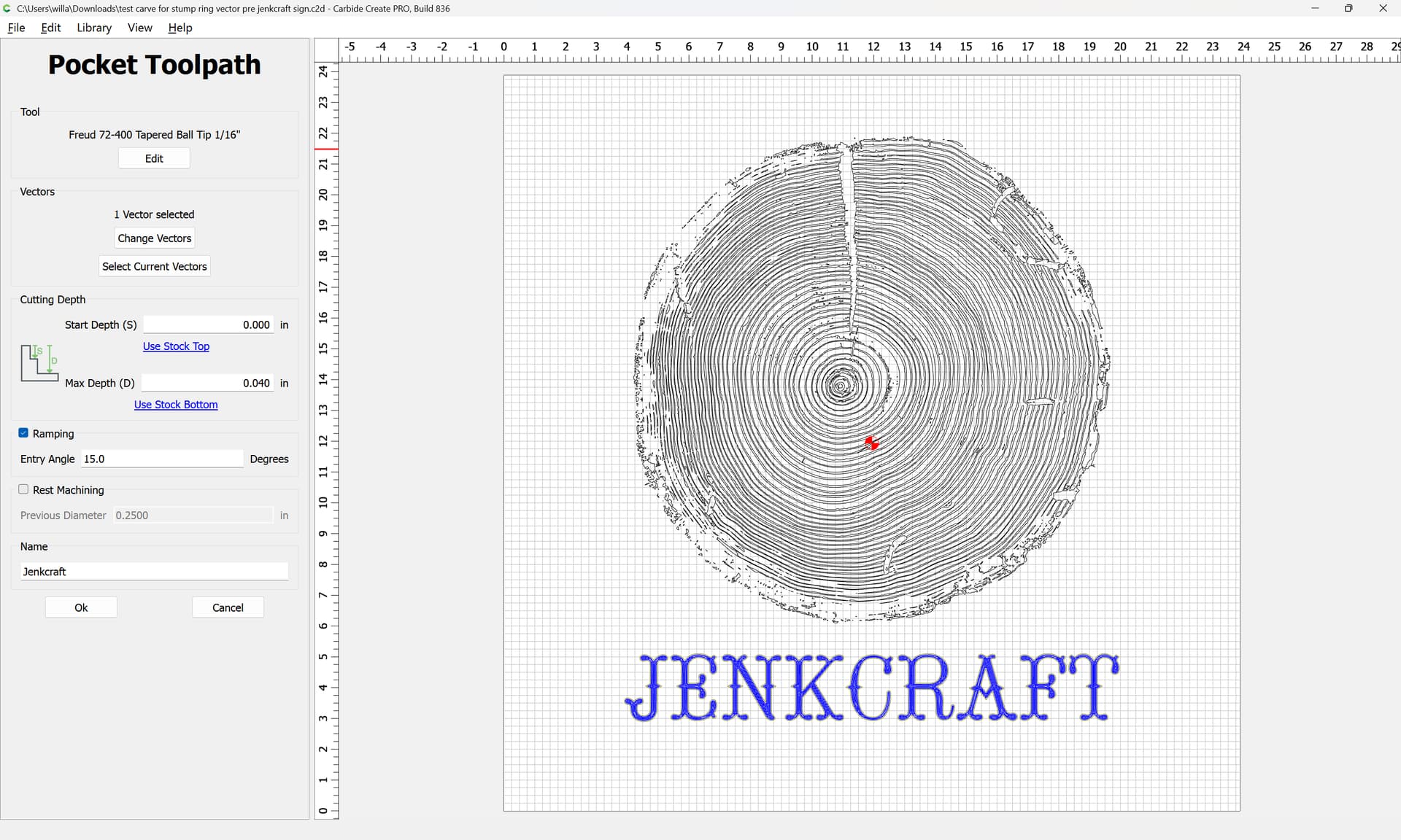

I believe that what you are seeing is the machine ramping in:
at 8 IPM against a very narrow element of geometry.

Additionally, I added a few new Freud and Bits n Bits end mills to CC recently so the slow plunge rate is obviously just my lack of knowledge when entering in parameters for them combined with Freud’s lack of available detailed data for plung rate value. I’m sure all of the ones I’ve added could use some adjusting…

I think I understand now. The cut is so thin, ramping is going to have basically no effect. and when combined w slow plung rate, the spindle is gyrating.
So if I remove the ramping, and increase plung rate, that’d make more sense and likely solve the issue…
Is that correct?
Correct.
That said, I don’t think that there was anything wrong with the initial file — it’s just surprising to see in operation.
