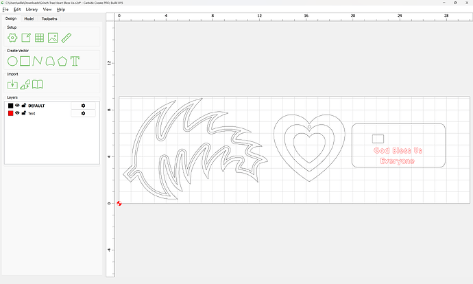

I need help with a file. The file shows up as expected in V815 in the simulation. When I switch to design, I get
In toolpaths, I set a Vcarve and when I hover over Base Text, it says to use a 1/8 endmill, when I go to edit, it states to use the 60V I set it to use.
What did I do wrong and/or am missing?

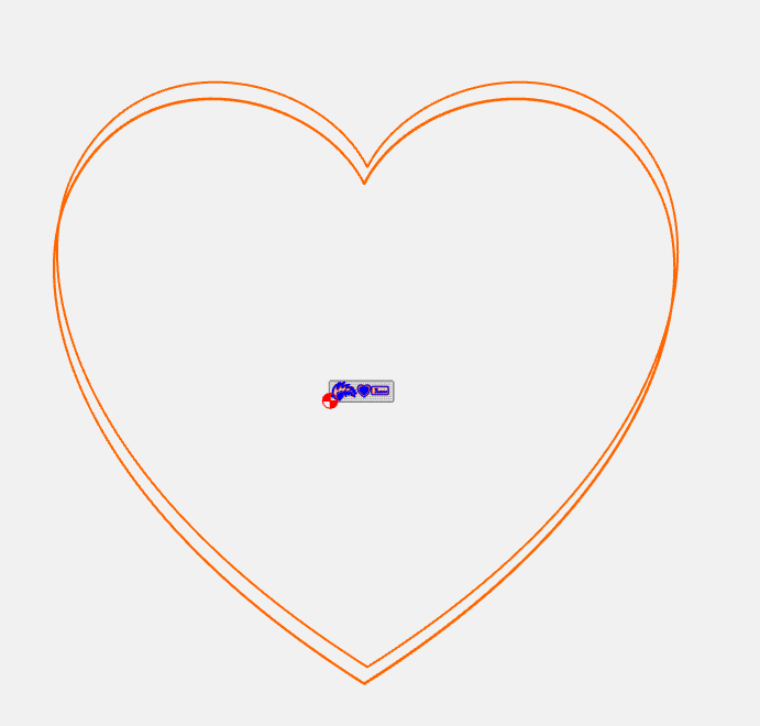

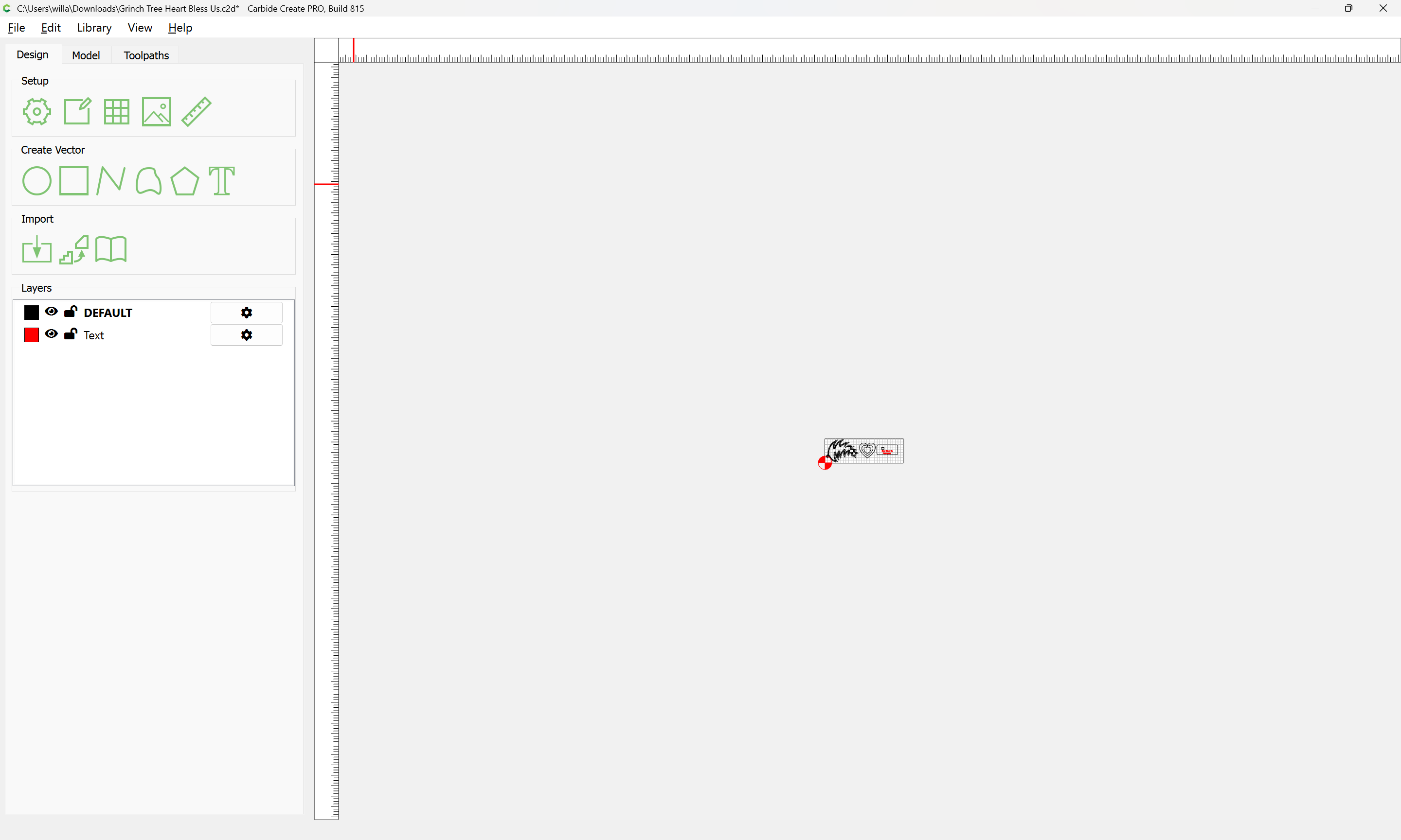

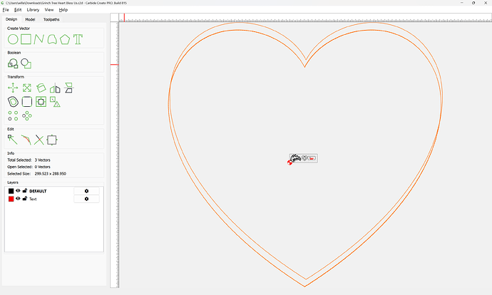

Got it, Thx. Any idea why i get the strange view in deign mode?
Why not delete the surrounding hearts?
Because I hadn’t though of that. Thanks to both for your help
