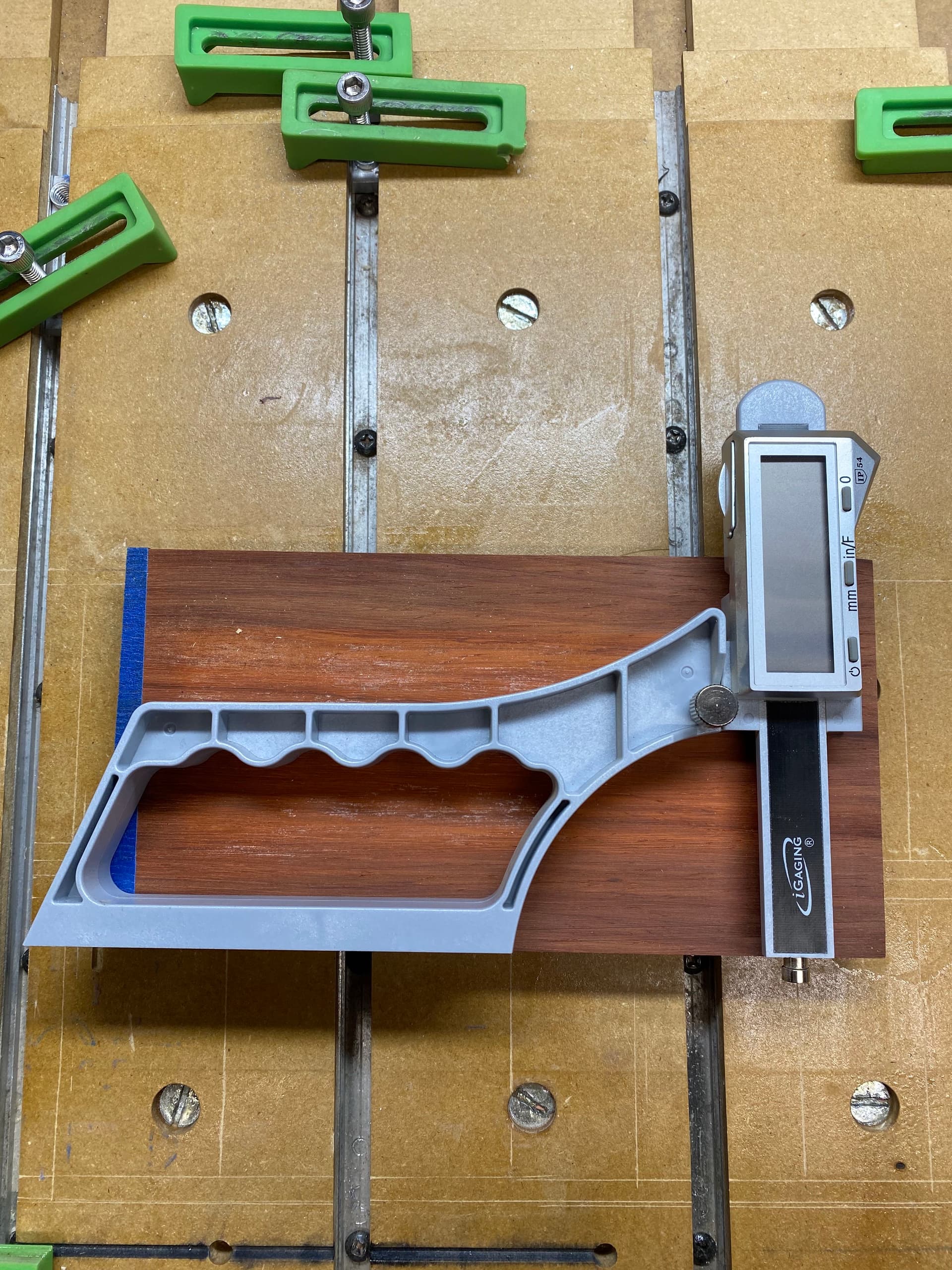

I was about to order one of those depth gauges like I linked above and then thought I may have something similar already.
I dug around in my drawer of “precision” equipment and found it. Of course the battery was dead but it looks much better than the one above given the metal vs plastic base.
I will start using this and see how it goes.

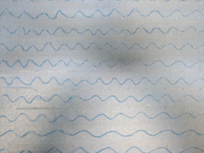

As far as something under the project that is not necessary but a lot of people use painters tape and super glue to hold projects down. That is not protecting the spoilboard but when I use bottom of material it usually cuts through the top layer of painters tape and not through to the spoilboard.
The painters tape and super glue method you put a layer of painters tape on the bottom of the project and a layer on the spoilboard. Then use super glue to bond the two together. Let is cure a few minutes and you are ready to do. When the project is cut out you simply remove the tape and finish as usual.
This picture is a large project I put down the 2" tape and matched the seams on the bottom of the project. I use TiteBond Medium Superglue in an S pattern. You want enough super glue to hold the project but not so much it squeezes out to the seams between the rows of tape.
Originally purchased for setting router bit height when I was making box joints on a router table.
