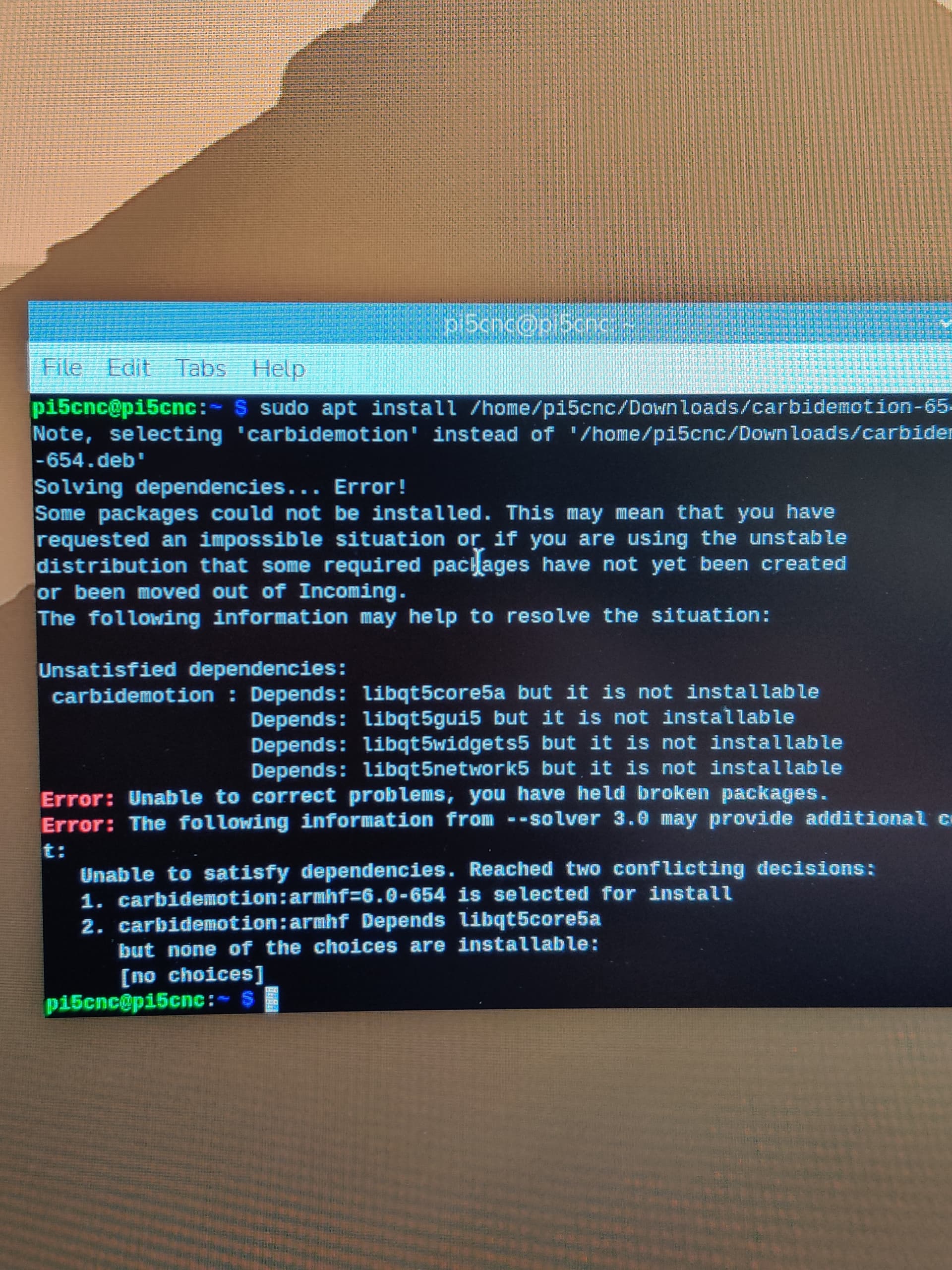

So odd thing I’ve found is that v654 package does not want to run on my Rpi5 & I have no idea why. I removed v635 & can re-install v635 just fine & run it. But not v654.
I’m wondering if v654 works on Wayland or does it need X11?
So using GDebi package viewer seemed to bring up possible issue of a missing dependency & file ownership.

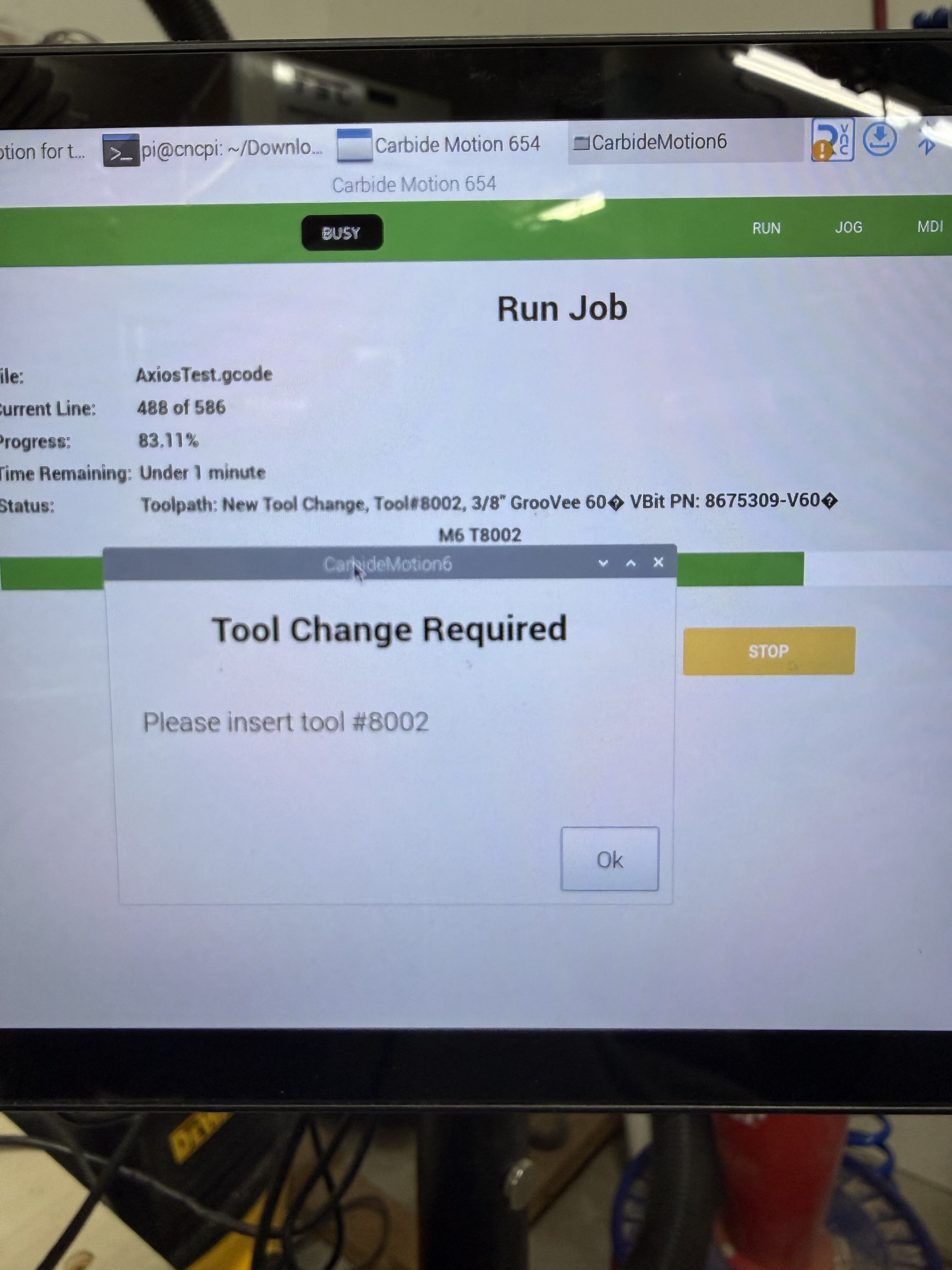

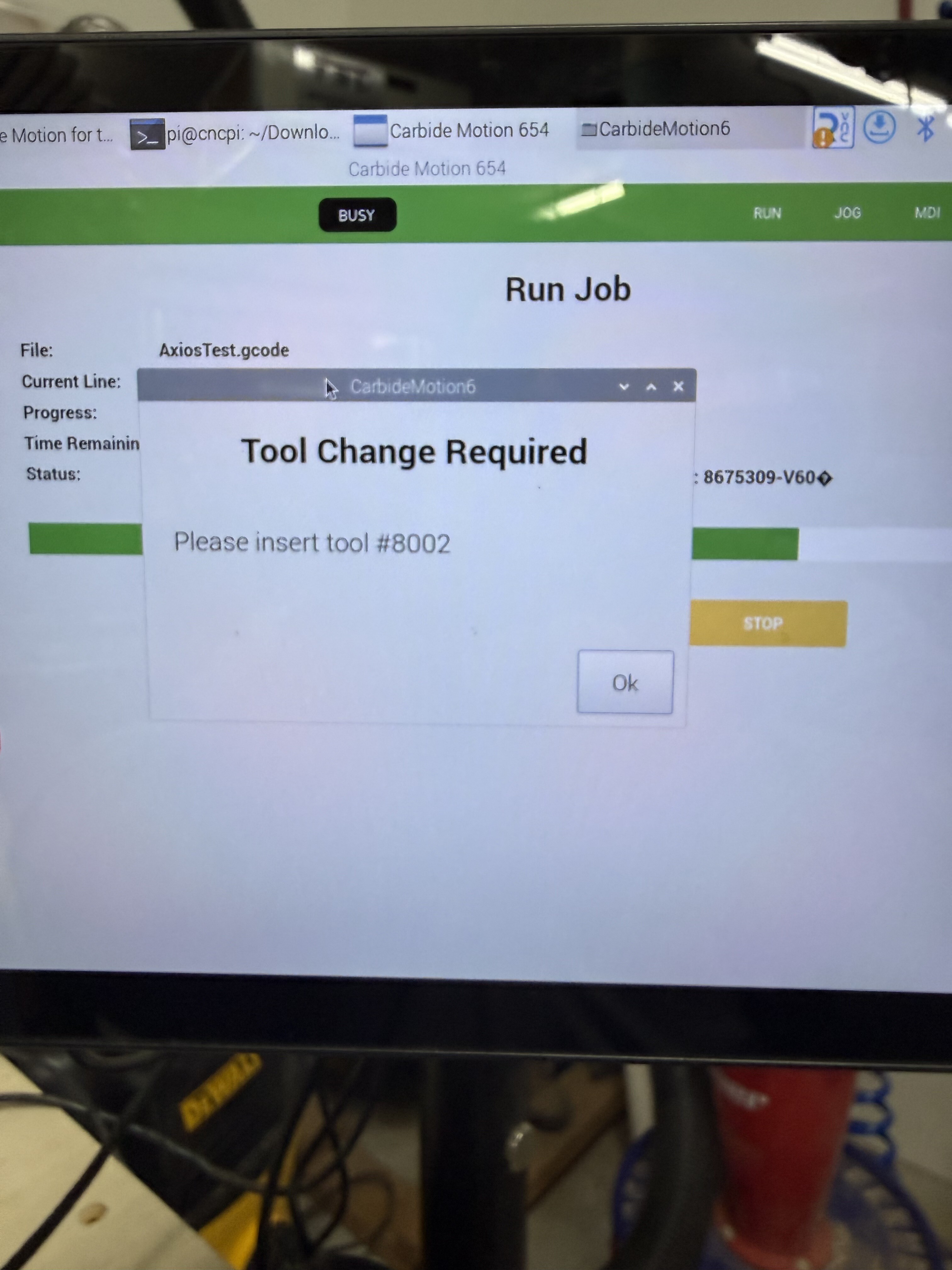

I just tried 654 on my Pi 4 (or maybe 4+) and it worked flawlessly. The Jog Pendant worked right away and was very nice.
I did not try the E Stop on the pendant or the program restart in CM but every else was smooth.
I like the larger popup for for the tool change. It’s easier to read on my 10” screen. It does obscure the more descriptive message from the Vectric post from @Allen44 but I can slide the front one out of the way.
I did not test jogging from the touch screen to see if the double jog bug is there but the other buttons on the touch screen works as they should.

Finally got around to checking out my RPi5 again. Loaded up the latest Raspberry Pi OS(Trixie) & downloaded CMv654 to see if it would work.
It’s a no-go.
From what I can tell, the QT library dependencies are not available to be installed.
After setting up my Rpi5 with 32-bit Legacy build of Bookworm, CMv654pi seems to run & work fine with my setup.
