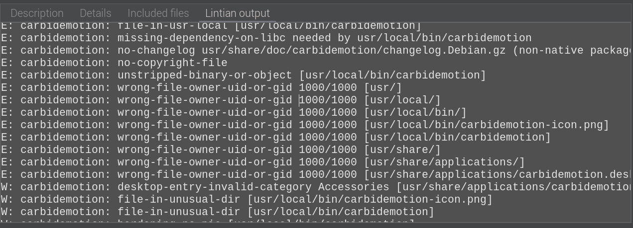

So odd thing I’ve found is that v654 package does not want to run on my Rpi5 & I have no idea why. I removed v635 & can re-install v635 just fine & run it. But not v654.
I’m wondering if v654 works on Wayland or does it need X11?
So using GDebi package viewer seemed to bring up possible issue of a missing dependency & file ownership.
