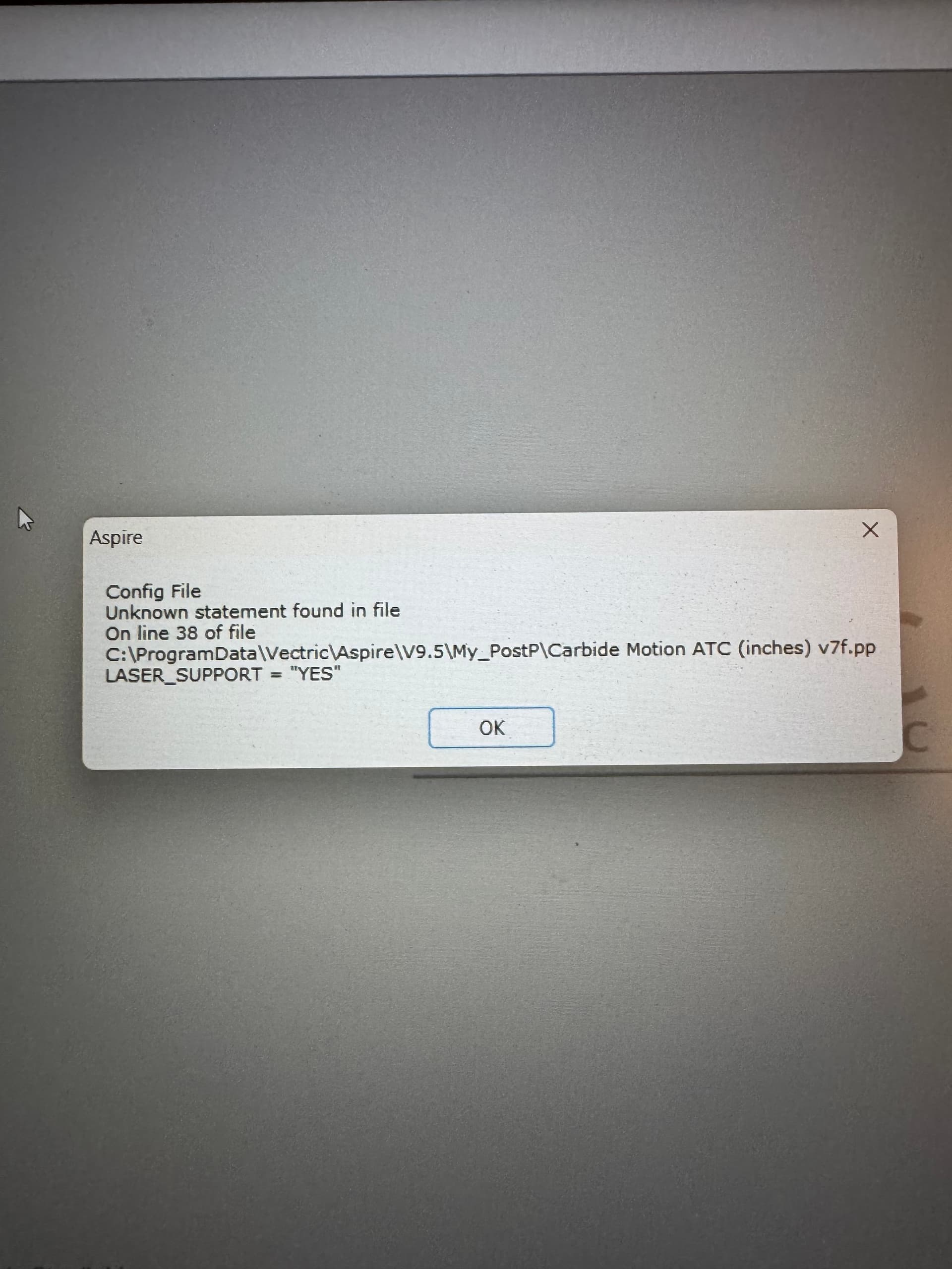

Hello Allen44, I have a shapeoko 5 pro with spindle and im using version 9.5 of vetric aspire. i was hoping to use your post processor zip file. I downloaded it and unzipped it and installed on vetric aspire and a error message coming up when opening vetric saying this.
"Unknown statement found in file
On line 38 of file
Laser support= “yes”
was hoping you might could help me with this if im doing something wrong or if you have seen this before. I included a image if you can view it. Thanks in advance!
nfi
You could start by commenting out the line by bracketing that line in parentheses, then try it again. GCode uses parenthesis to indicate comments, and ignores whats inside them.
