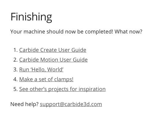

Why is this important step not in the (1) assembly guide or (2) Carbide Motion guide?
PS Still too many dead links in the assembly guide (Meg???)
See photo ( 1- 5 they are all dead)
The website is being updated — this hasn’t gone as smoothly as we’d’ve liked, and the re-directs haven’t been put in place, nor have all the link updates been made.

@RichCournoyer - the homing portion not being part of the instructions was a legacy thing. Originally the machine didn’t ship with limit switches, so it was a separate set of instructions, blah blah blah. Short story: It was my fault for not getting it updated sooner.
Longer story: I just took new pictures and am writing instructions to include with the Standard Shapeoko instructions, should be updated by Wednesday.
Also - I just fixed the 5 dead links you found. Let me know if you find anymore!
-Edward

Just to close the loop on this: I went ahead and created a new article defining how to enable homing. You can find that here: http://docs.carbide3d.com/shapeoko-faq/shapeoko-enable-homing/
Now the instructions are more clear - the actually switch installation is part of the overall assembly guide for each size - and the software configuration is broken out into this new article.
Hope that helps someone in the future.
