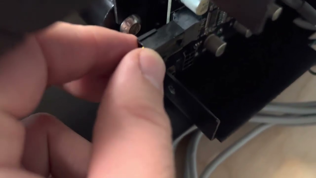

Hi everyone, just received my Shapeoko Pro XXL a couple days ago and yesterday spent getting everything assembled and today I started to connect all the wires etc etc. I ordered everything additional like the BitRunner V2 and BitZero V2.
So when installing the BitRunner V2 it felt like the connection on the PCB board was kind of wonky a tad bit and loose. Also the connection was super super super hard to connect. I kept looking at the male and female ends both thinking something was off but nothing was off. Anyways I got the connection which honestly felt like something that wasn’t meant to connect.
With that the connection/solder possibly feels loose. I can slightly see (barely) behind the PCB board. Looks like 6 solder spots holding this male connection on the pcb board but when I slightly move the male connection it looks light a 7th solder spot and its going in/out the pcb - I’m not 100% sure. Could this just be a tab on the male connection through the pcb to keep the male connector from twisting/.
So video below I took to give a better idea. Anyone’s male connection on the pcb like this? Is this normal? Should I contact Carbide 3D? Thanks
Yes, you should contact support@carbide3d.com. It may still work since only 2 of the 6 pins on that connector are actually used, but still.
This will only affect the BitRunner, so you can still proceed to complete machine assembly and initial testing while you wait for a response from support.
As @Julien noted, please contact us whenever you need to — we understand that many folks can only use their machines evenings, weekends, and holidays, and do our best to assist folks during those times, at least via e-mail.

Hi everyone, I’m just now getting around to posting an update here. This past Monday I heard from Carbide 3D first thing in the morning. One of the technicians called and went over everything. He explained the connection is perfectly good and that the connection is meant to give a little like a spring because otherwise it could possibly break due to the tight connection. He had a couple boards next to him while on the call to confirm this is exactly normal. I finished plugging everything up and everything is running perfect no issues.
So if anyone ever has this or questions this I would say it’s normal and nothing to be worried about. Again designed this way because of the tight connection between the plug wire and the plug connection on the PCB board.
