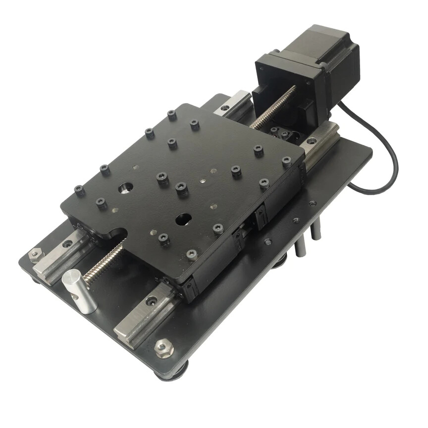

Almost 99% of the time when initializing and the router goes down instead of up it is the configuration. The Z-Plus and the HDZ run in opposite directions for the stepper motor direction. So if your router starts going down in initialization you likely picked the wrong Z. The Z-Plus which is the standard Z on most C3D machines is refereed to as LeadScrew and the HDZ is refereed to as BallScrew.
Here is a Z-Plus Z Axis
Notice that at the top the Z motor has no coupler and at the bottom there is a silver stud with a hole in it.

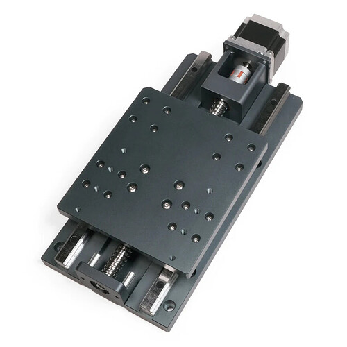

Here is an SO4 and SO4 Pro HDZ
Notice the cage under the Z motor and the coupler inside the cage. There is a bearing block at the bottom of the HDZ.
The SO3 HDZ is similar to the SO4 and SO4 Pro.
