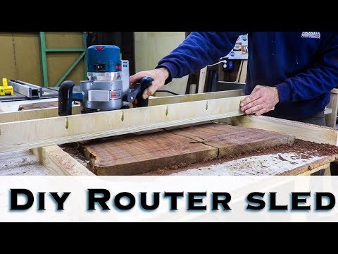

You can use a flattening jig to get oneside flat but the one I have is 5’ x 10’ and takes up a lot of space. I bought the Veritas hardware and you use 2" EMP conduit for your rails. The kit is relatively cheap but takes up a lot of rooom. I have a Porter Cable 7519 3.25 HP router and a Frued 3HP router I can put on the flattening jig
I have bought linear rails to replace the EMT but have not put them on yet. There are lots of videos on youtube about making a temporary flattening jig. I am not suggesting this particular one but make a search and see what your shop will make handy.

Big boards on the bottom, I thought so but wanted to confirm. My son-inlaw has a Router sled.
