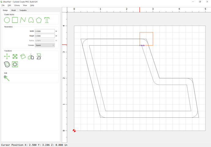

I have designed a bottom platform for a mobility scooter for special needs children. This is my first time using create. I need to radius the areas you see circled. So far no luck. Any advice would be appreciated.
The easiest way to put a radius on this sort of geometry is to inset it by the desired radius, then offset it to the outside by that dimension:

Offset to the outside by the desired radius:
thanks so much. It was driving me crazy
This is one of the coolest tips to make things work just right. The first time Will showed this to us, I learned he was brilliant! :slight_smile: I now use it all the time.
On my next design I don’t need a radius on every corner. How would I do that?
Leave the original behind, edit, or use Boolean operations to remove the corners which need to be rounded, select the offset and the edited original and Boolean Union.

I want to radius the corners in the circle. Also wondering how I eliminate
the material on the right side of the poly lines from the design.
Okay, if I understand correctly, you have:
  • a closed object:
  • Two lines which define where you want things cut:
First, join the two lines:
(joining has to be done twice to get a closed object)
Node Edit the new closed path to make it extend beyond where the original object extends:
Done
Select the original object:
shift-click on the edited object to add it to the selection as the key object:
Boolean Subtract:
Inset by the desired radius:
Draw in geometry where you wish the rounding to remain:
Select the original geometry, then shift-click on one of the objects drawn in where you wish the rounding to remain:
Boolean Subtract:
Repeat:
Drag the inset geometry so that it is positioned where you wish the rounding to be:
Draw in geometry to isolate where you want this to round things off:
Select the offset geometry, shift click on the isolating geometry:
Boolean Intersection:
Select everything:
Boolean Union:
