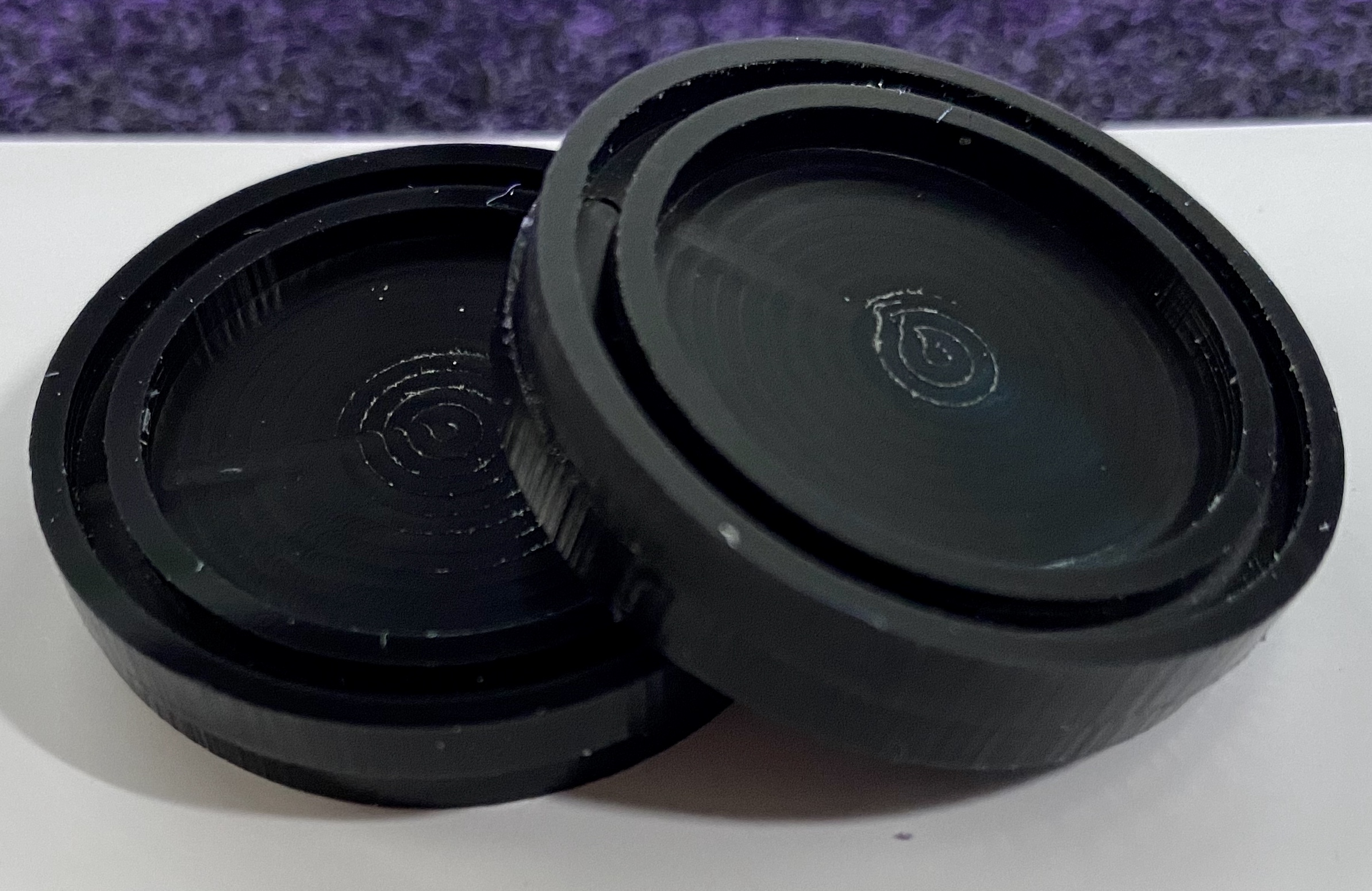

The goal is to make the exact same cuts on both sides of the Delrin–which I thought would only require flipping it over and restarting the exact same project (after zeroing back to the starting point).

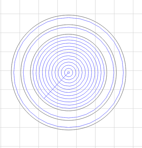

The project is pretty basic, to me. It’s a little smaller than a poker chip, consisting of:
  1. One inner circle, which is set to a pocket so I can do an inlay; pocket is 1.755mm
  2. One outer circle (larger than #1), 1.755mm deep
  3. One final outer circle (larger than #2) which is the cutout, 3.00mm deep
I’ve used Carbide Create to create the circles and center them to the dimensions of the project, which is set to the size of the Delrin. I’ve then shifted the group up and backed off from the top so it’s set to be centered to the top-middle section of the Delrin.

  1. Despite being centered in Carbide Create and the zero being identical by value in Carbide Motion, when flipping the Delrin and starting the project up again, the cuts do not line up. The last test was off by around ~12,7mm, resulting in cutting through the center pocket on the other side.
  2. My current process to re-zero to the project is to run the project, exit the Carbide Motion app, start the Carbide Motion app again, initialize, jog => rapid to current X Y (which seems to work). Is there a better way to consistently start at exactly the same position? Looking over the G Code, it seems G92 is not supported, so while I can set the zero using “G0X-284.5Y-39Z-77.510” in the .nc file, that does not keep a zero and the mill rapidly shot into the right side.

Gave the project another run. I don’t know what is different, the the gap is smaller than the initial, but I can’t seem to get it dead on. In the picture, you can see the lip on the top right (the bottom left has the same issue).
Any deviation in measurement/placement will result in this sort of difference — my suggestion would be to cut this as a one-sided project w/ a tool change to a #102 to cut the perimeter, leaving a roughing clearance and then taking a full depth finishing pass.
Even if you have do to do it as a two-sided piece cut the entire perimeter as a single setup.

Would you mind posting the C2D file? I see the .nc, but not the design.
@GJM Attached below, thank you in advance for taking a look!
project-puck.c2d (16.2 KB)

The offset is significant enough where if you look at the project C2D above, the “Outline - Top - Left” path cuts into itself when flipping the project over.
