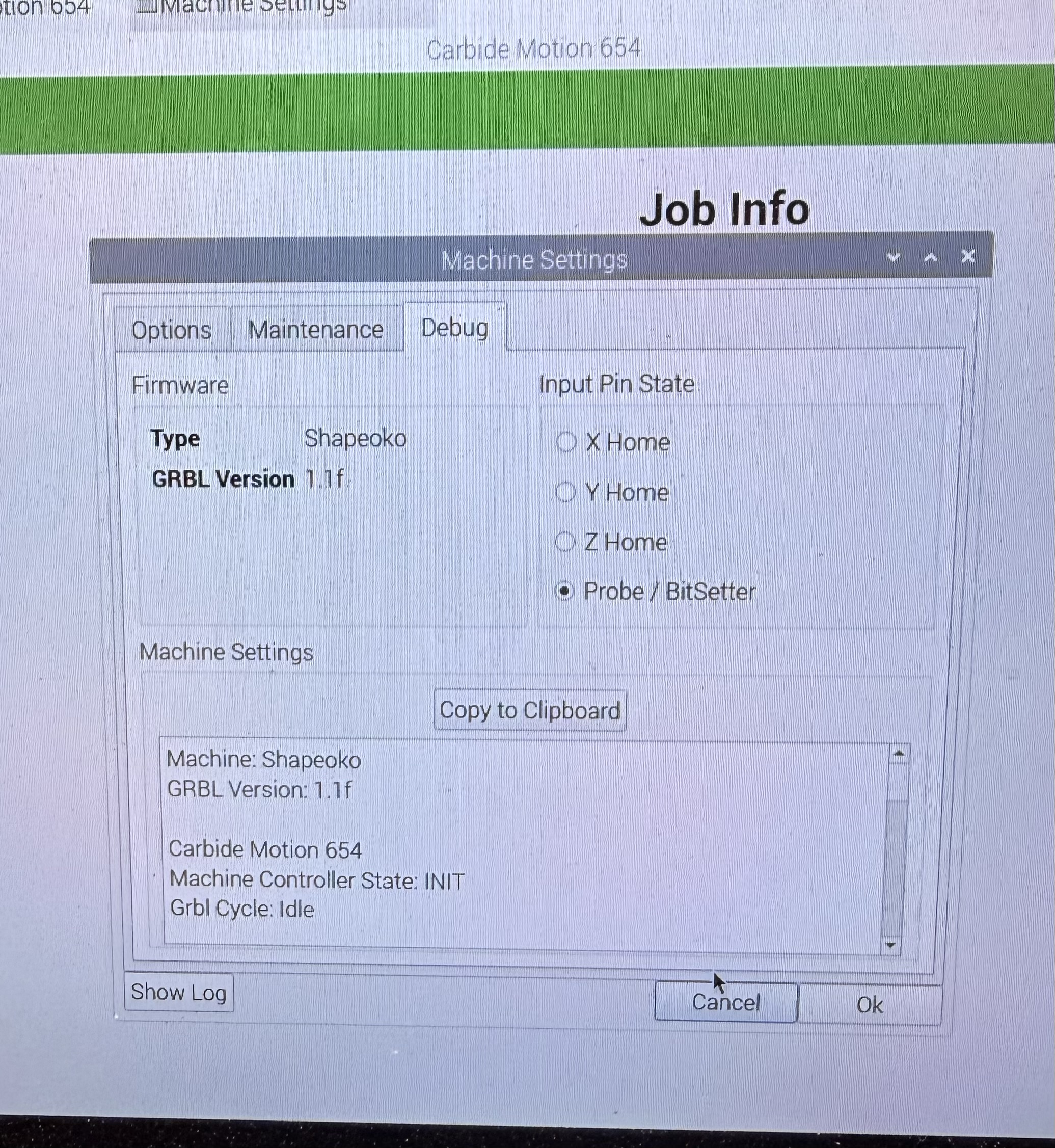

There is a debug screen in CM I think that will show you if it is pressed. Also, a light on the PCB I believe.

Settings / debug and press to see if it shows active on the screen.
If it doesn’t and you also have a BitZero test that to see if it activates.
If neither does then it’s probably a control board issue or connections to the control board.

Here’s this morning’s findings:
  1. The Y indicator in Debug is on, Y lamp is lit. System is retracted to the North.
  2. When I put metal by X or Z sensors then Debug displays correctly.
  3. BitSetter was selected, as I had originally done. No lamp is lit for this.
It would appear that I only need the BitSetter sensor.

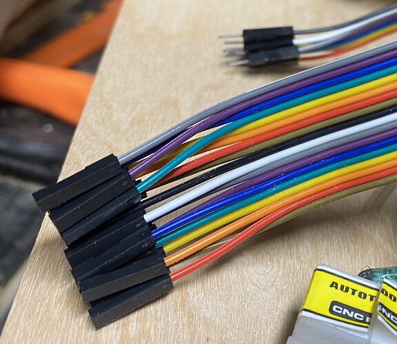

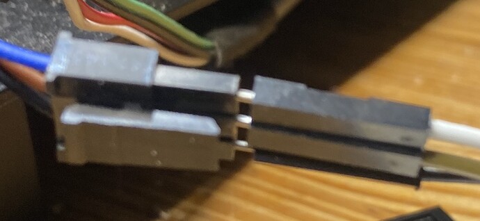

So … Here’s the results. It wasn’t the controller board or the sensor. It was the extension cable. Even though I’d done a continuity check on it. that wasn’t enough. There was apparently a weak pin in one end. Worked when pushed together for the meter but not when I wasn’t testing. That was the only thing left.
Found a 30cm ribbon cable at the local MicroCenter. Separated 2 lengths of 3 strands and plugged them in. Works perfectly. Just add a little tape to hold until I can get the proper cable.
