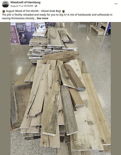

It all depends on what your local lumberyard has, and if at all possible, any wood purchase should start there.
Next-best scenario is to buy at a specialty woodworking store such as Rockler or Woodcraft — in some cases they will source wood locally and make it available quite affordably — my local Woodcraft’s Facebook post from the other week:
Every so often they’ll have a sale where the lumber is by the pound and usually bowl blanks are pretty affordable then
Worst-case scenario is to buy from a big box store such as Lowe’s or Home Depot.
