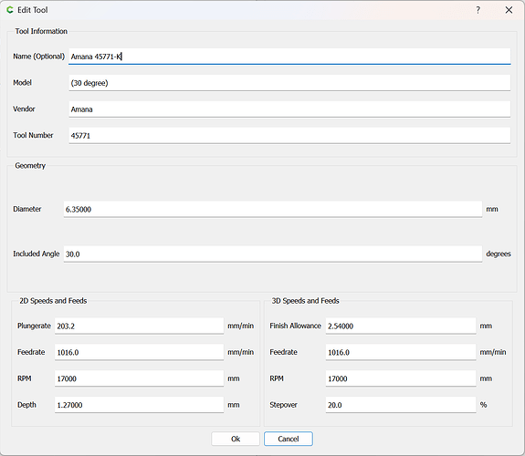

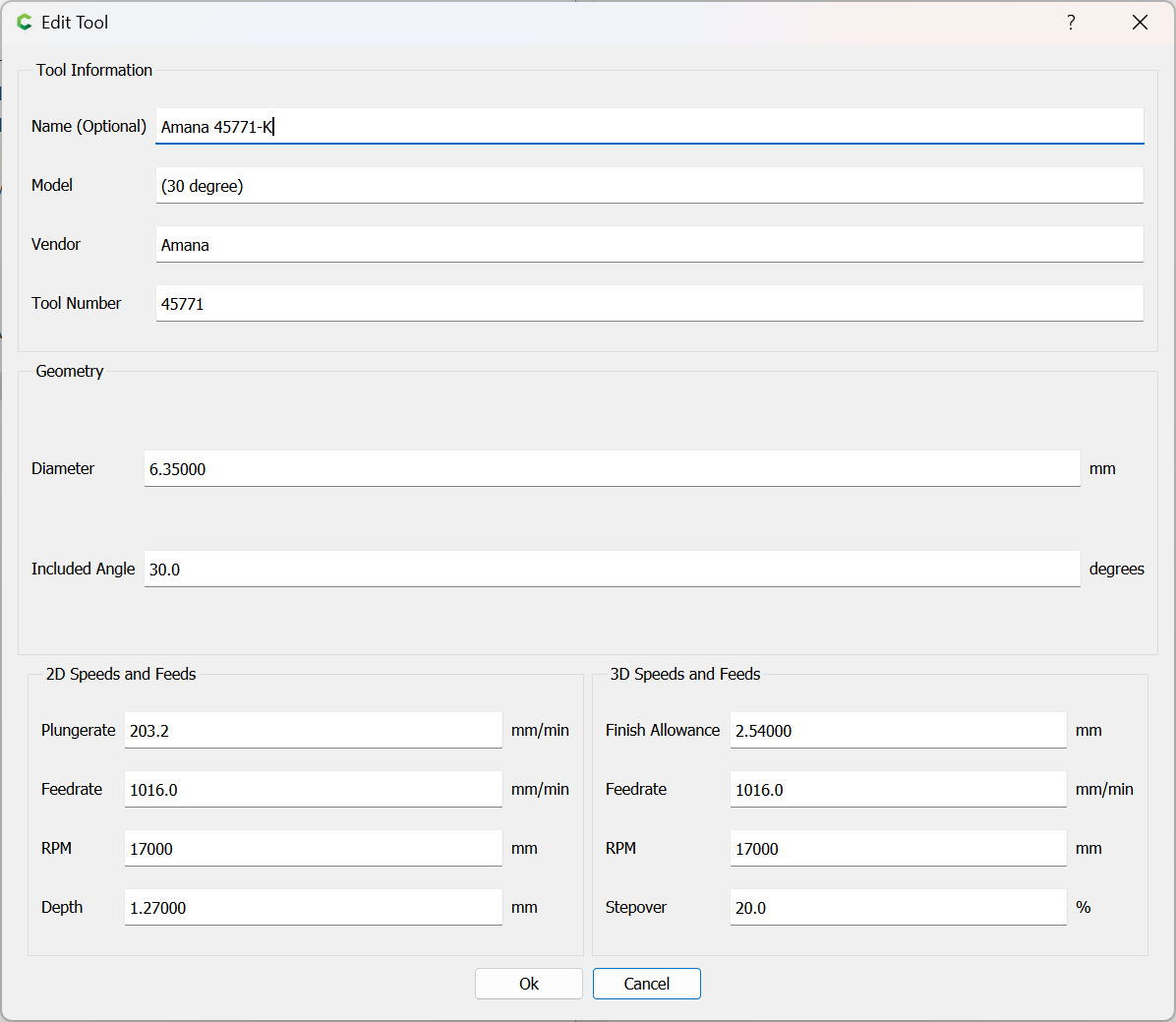

Does anyone have a starting point for the Amana 45783 18 degree v-bit? I am trying to get a little more detail on a project that I am doing. Tried using a 1/32" 6.2 degree tapered ball end mill for the detail and it was a little to much at a DOC 0.03". Thanks in advance.
I entered a similar 30 degree tool as:

I bought a 15 degree vee bit from Amazon. Here are the custom tool database for that bit.
number | vendor | model | URL | name | type | diameter | cornerradius | flutelength | shaftdiameter | angle | numflutes | stickout | coating | metric | notes | machine | material | plungerate | feedrate | rpm | depth | cutpower | finishallowance | 3dstepover | 3dfeedrate | 3drpm |
703 | Foos | 703 | 703 15 degree vee | vee | 0.25 | 0 | 0.5 | 0 | 15 | 2 | 1.5 | 0 | 8 | 14 | 18000 | 0.05 | 0 | 10 | 14 | 18000 | ||||||
704 | Foos | 704 20 Degree Vee | vee | 0.25 | 0 | 0.5 | 0 | 20 | 2 | 1.5 | 0 | 8 | 10 | 18000 | 0.05 | 0 | 10 | 10 | 18000 |
I only use those for thin lines in vcarving. A 60 or 90 degree vee bit barely scratches the surface for really fine lines.
