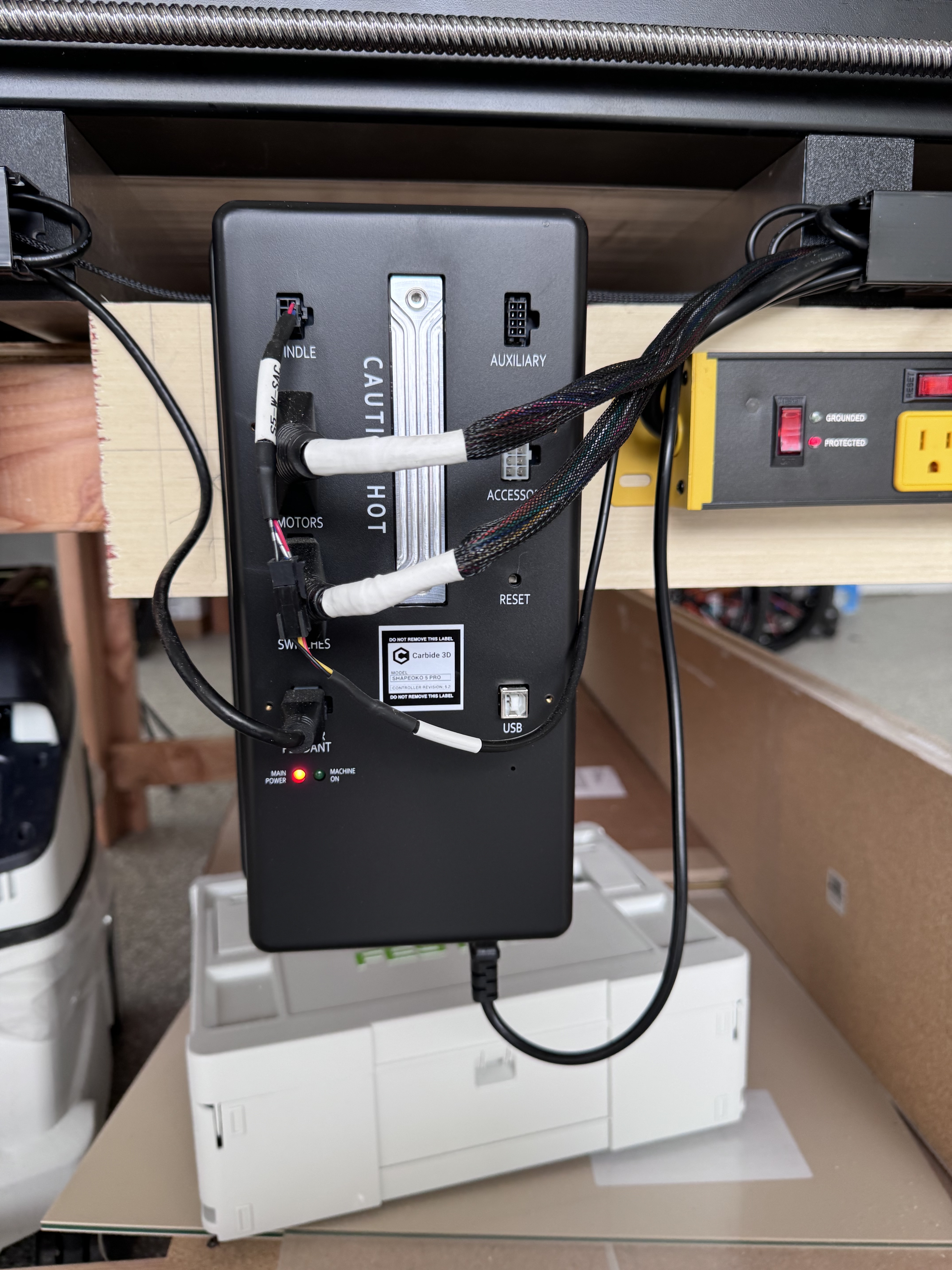

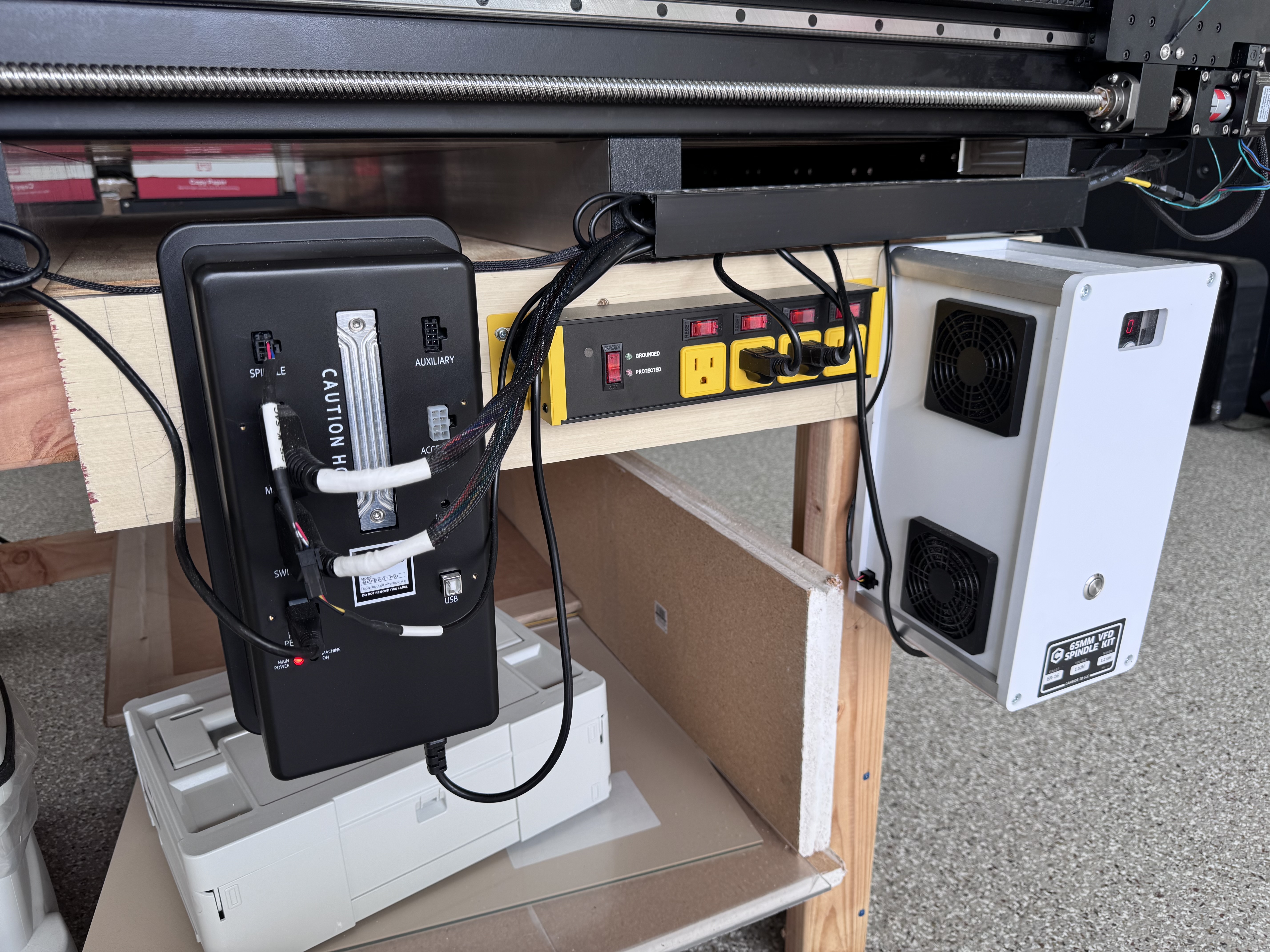

I was finishing up a cut yesterday and at some point the spindle returned to the home position and then powered down. I have tested all of my wiring set up and I’m getting power everywhere. However, the little light on the front of the 65 mm VFD spindle box around the button that disables the spindle is not illuminated but the blinking numbers in the window are. I have shut everything down, checked all the connections that I can see, and generally just tried to do an end-to-end assessment, but with no successful result. Can someone suggest something that I should be checking for this issue? Also of note, the LED light under the gantry is not illuminated. My assumption is that I’m not getting power somewhere between the box and the gantry/spindle.
I’m sure it’s something simple that I’m missing because that’s far the function of the machine has been 100%

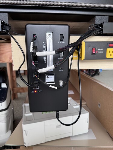

You can’t see it here because of the LED, but the LEDs in the window are blinking 0.0. The spindle Killswitch is not illuminated.
Did you accidently hit the emergency stop button ?
I did this three days ago.
The gantry lights will not be on if the switch is depressed.
Negative. I’ve checked it half a dozen times. Though, I do have some concern over the health of the module. We’ll see.
