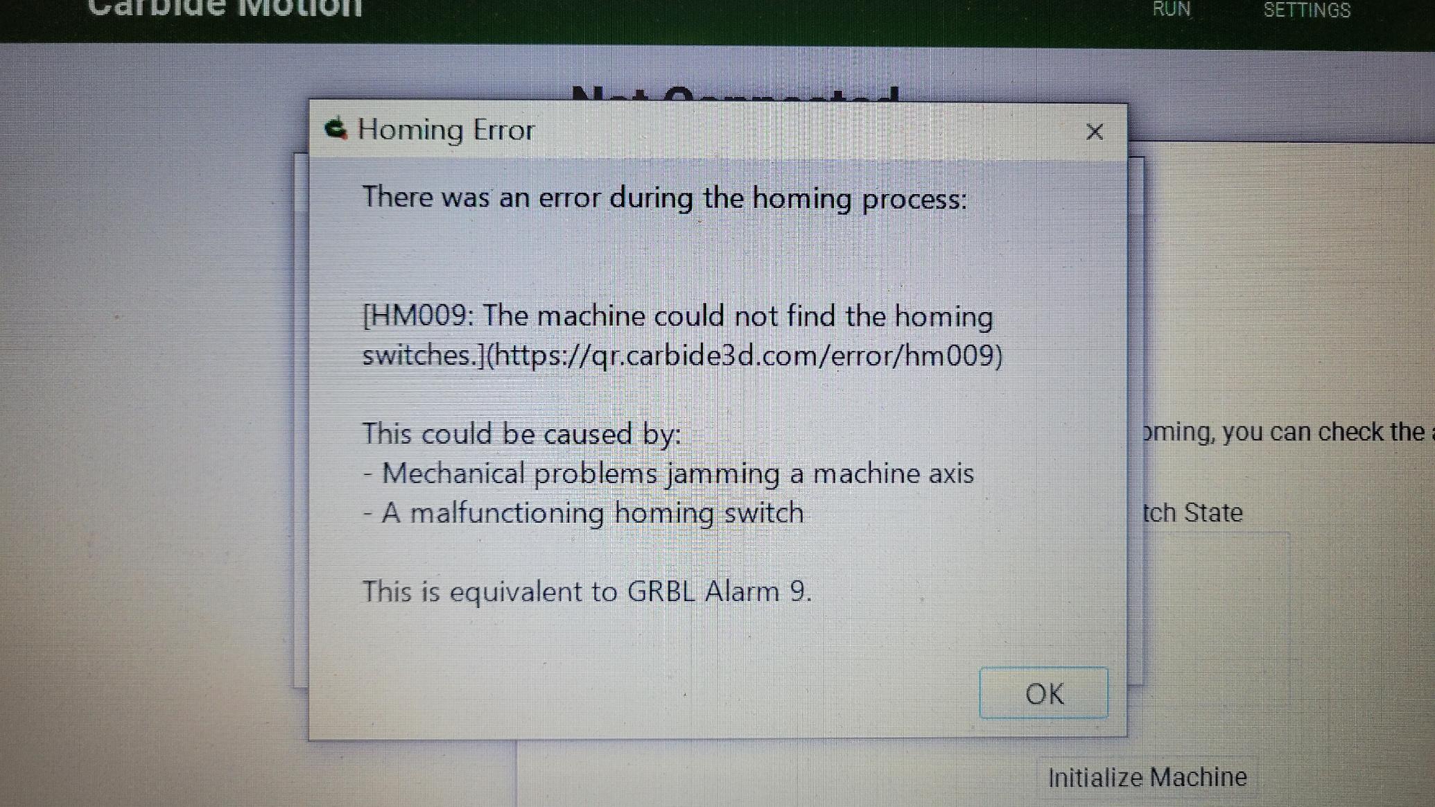

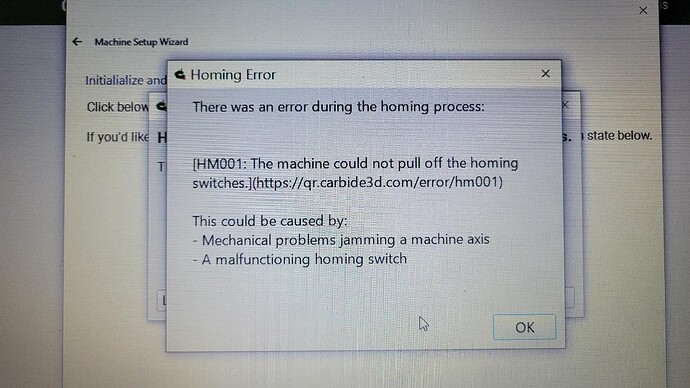

Hi anyone of you know related issue problem with noise that I can feel cuz I am deaf since not understand why what happened? here is video by click here Watch 818216c9-9312-48a3-8a37-8e9746c12fb3 | Streamable to watch what did you hear noise what cause come from? I struggled it not working anyone help tip what should I do? Thanks.
Check if y limit switch is being triggered, sounds like the motor is trying to continue moving to home position. You can see the x limit switch light up in your video, check to see if the y limit switch lights up as well.

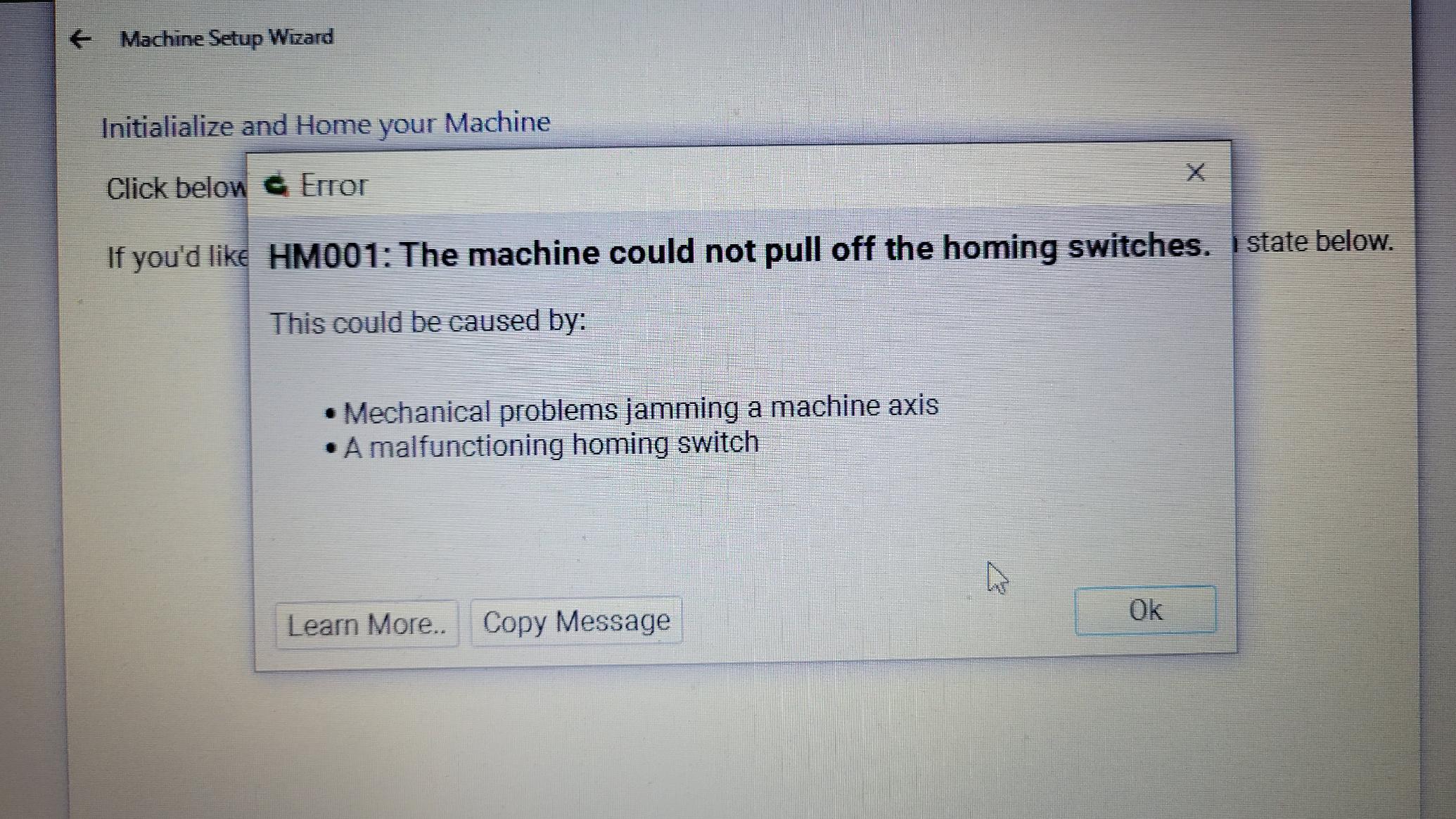

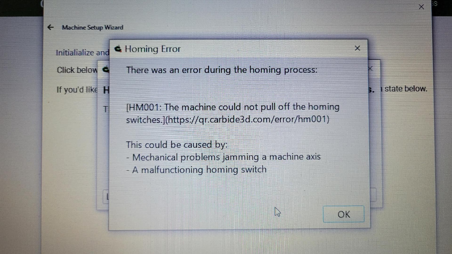

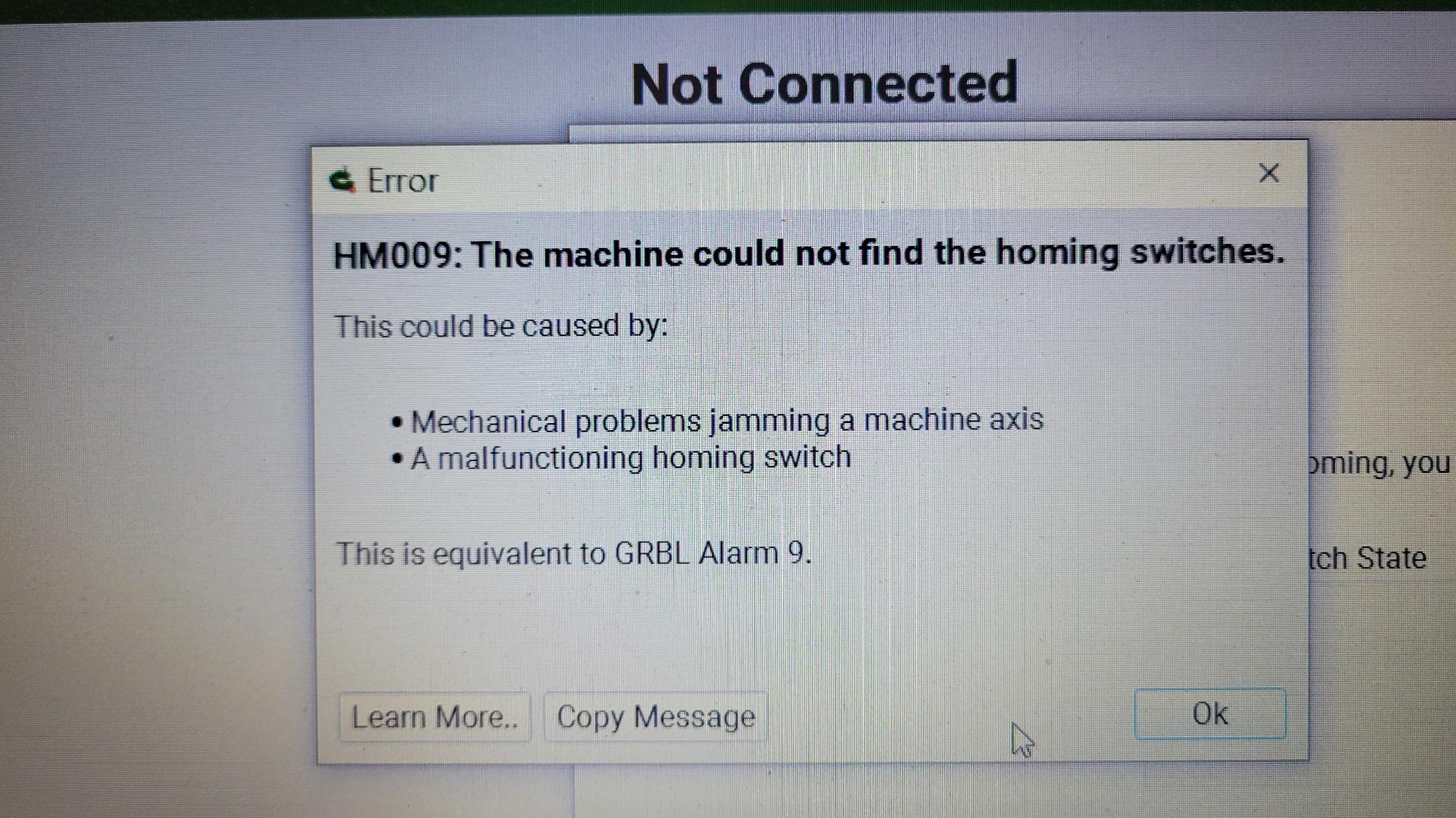

I watched video how and what to do but still same noise and repeat few time. Updated Carbide Motion to Build 667 and set up and processed but it still same problem. It only about 2 years old can’t understand why I think company seem not right design related software or wire to connection or another dunno! few message still not clear what I understand all about ummm. Puzzled so after updated Carbide Motion v6 (Build 667) also not found machine due not compeleted.

Finally found there home switch light is not on when Y moving to contact that cause noise so fixed adjustable the Home Switch moved up a little less than 1/8 inch and test few time now passed successful ! Thank you for tips.
