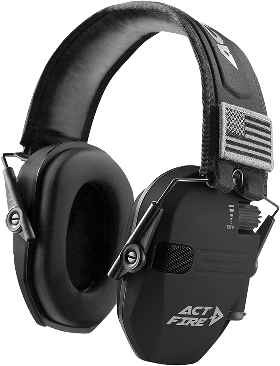

If you wanna play you gotta pay. Unfortunately you gotta pay with noise. Unless you get a perfect seal noise would escape. They make several cost effective noise reducing hear plugs and of course the head phones.
This was a fast search on Amazon.com cost was $10.00-35.00.
Protect your hearing because loss is accumulative. The router roar, the dust collection, the whining of the cutting and most important when you significant other calls you, you can blame not answering because of the hearing protection.
