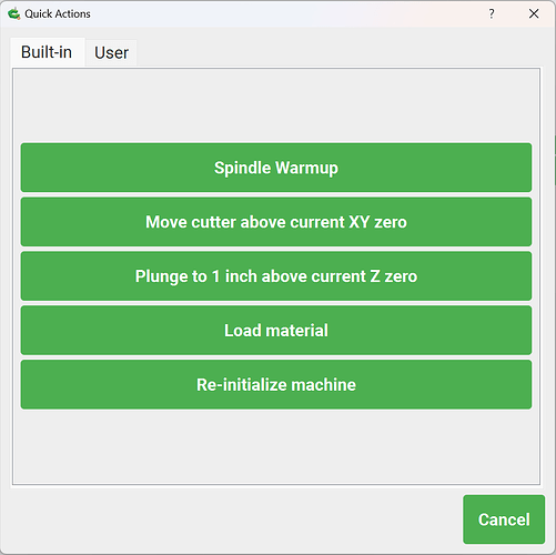

Is a warmup simply letting the spindle spin with no load at low rpm for a while?
There is a Quick Action in Carbide Motion for this:
Cheers Will, must say I didn’t even see that menu, good to know. I’ll give it a go when I get the machine back up and running.
