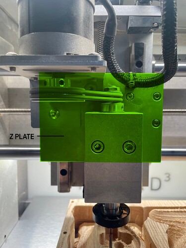

@tinkereratheart thank you. I read the post and even tho I am pretty handy I have to admit I am a little nervous about the procedure and would prefer to double-check with you guys before I do anything. I am also waiting for the official response from Carbide3d, and would love to hear from them as well.
But, in any case, if I understood it correctly, I should remove the spindle first, which I am guessing is by removing these two bolts. Also, should I set free the belts first, or just unscrew the spindle and let the belts come loose?
Next is the motor. What I am not sure is if I should remove the bolts that hold the motor at the top of the L bracket or the motor with the L bracket at once?
Lastly, remove the Z plate. I am sure after removing the L bracket for the motor there will be more bolts for the removal of the left side of the Z plate.
Before doing any of this I should put some support at the bottom of each of the two cars to prevent the thing from falling.

I received an email from Carbide3d advising to use Mobil Vactra Oil on the Z bearings. I had been using Super Lube in there, I guess that is the issue.
From Carbide3D: “You’ll want to use Mobil Vactra #2 on the Z bearings, the Z axis is the only axis on the Nomad 3 where these HG15 style bearings are used. You’ll want to remove the oil port screws from the top side of the bearing to inject a bit of oil.”

I found to work the hg15 bearings free I had to whizz them up and down a LOT and that is difficult to do with the Z leadscrew in place. Also you cannot easily flush the vactra through from the top of the bearing unless you take the z plate off. Filling from the bottom without flushing doesn’t really cut it. See how you get on, but I suspect you’ll need to take all apart to do it well.

Just make sure you support the HG15 linear blocks before you disconnect the AB nut. Make sure you support both blocks directly and not by supporting the plate else when you remove the plate both blocks will drop off the rails and all the tiny balls will fall out and that is a REAL hassle to put back together. A carefully sized support below the rail will also prevent the block dropping off while sliding them up and down when working the fresh Vactra through.
Other than that your dismantling pics/process should be fine.
