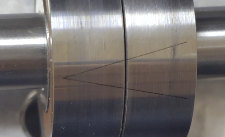

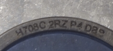

I took apart one of the previous spindles to remind myself of the bearing type.
The type is DB (Back to back)
The orientation marking on the side is for a duplex set :
The usual way to use a duplex set is with matched spacers on both the inner and outer races and the preload gap ground into the race sorts out the preload.
In the Nomad 3 spindle, they are not set up this way, there is no spacer on the spindle shaft so the preload is totally up to precision assembly and will vary due to thermal expansion differences between the ali spindle block and the steel spindle.

The lower part of the housing seems to have two double-sided contact bearings and the upper part seems to have one 708c.
They say it has 7000 series bearings, and I guess the shaft diameter has also changed from 8mm to 10mm.
