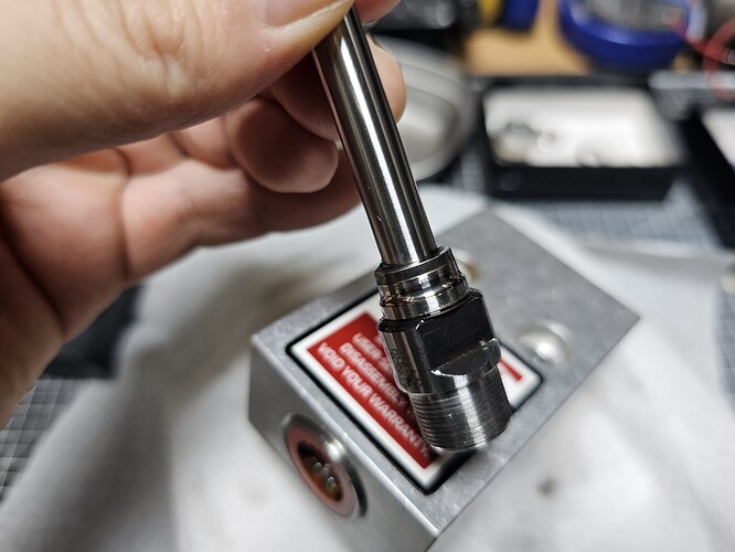

The spindle that was replaced shook little by little in the Y-axis direction as before, but it became too severe, so I took it apart to replace the bearing.

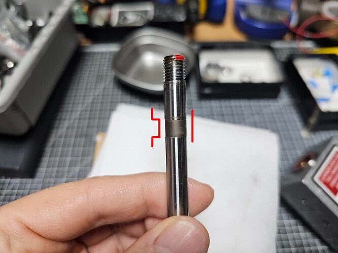

The inner part of the bearing below ER11 was stuck to the rod and separated, and all the iron beads came out outside.
The part that touches the upper bearing of the ER11 rod is tilted to one side as shown in the photo, and the groove is dug.

The ER11 bar is damaged and I don’t think I can use it, and I think I’ll have to find a different solution.
If you are using Nomad 3, please check by holding the bottom of the ER11 bar and shaking it in the Y-axis direction.

And just for the sake of brevity, it’s worth mentioning that these are fairly tight tolerance press fit bearings. But if one is sufficiently equipped, it’s almost certainly possible to carefully eject the old bearings and press in new bearings. (If your spindle is going in the bin anyway, what’s the harm in trying? Ruining a couple new bearings I suppose
Though I’m not sure if there’s anything to be done about the wear on the spindle shaft if it’s to the point where it’s no longer usable…that’s a lot trickier to deal with at home.

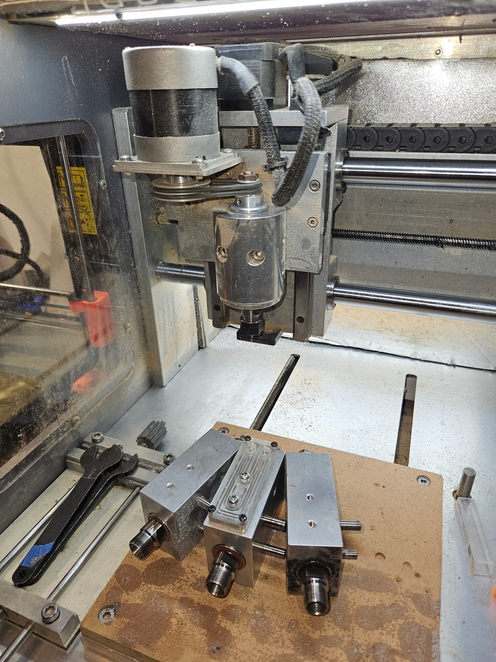

This might be a mistake on my part to share this. I have not seen any other posts, but 6 months ago I was told not to post about this for “A couple of weeks”. And I have refrained from posting while waiting on official announcements.
There are beta units going around. Or maybe I have a one-off of a new spindle design.
And from my use and testing it is now a completely different machine.
It is sad that so many have the spindle issue. These are 3 of my 5 replacements.
Maybe they felt bad for me? But I see this new spindle as a much better solution than hoping that the old one will last or that the user won’t notice.
How can I get these spindles?
I was contacted by Carbide3D - They made it. I would hope they made it as a replacement to the current design. Or they are working on a new Nomad.

@wmoy may have some answers. He sent me the beta unit and it mad my experience 100x better with the Nomad.

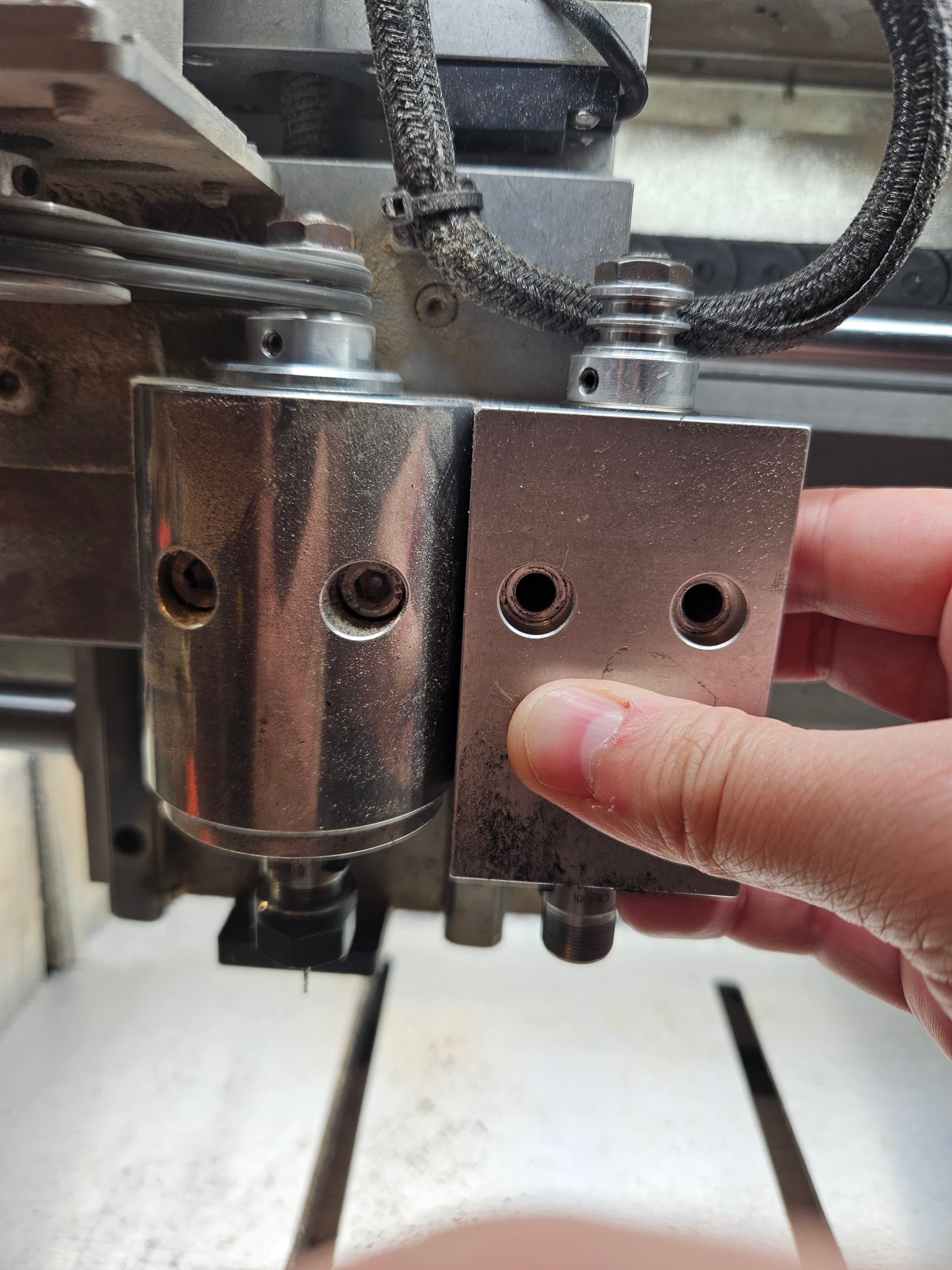

Looking at the picture, the height of the round block where the shaft is put looks shorter than the existing square block.
It looks like the shaft length of the existing 100mm is a little shorter.
I’m sorry, but can you tell me how high the circular block is?
It’s actually longer.
Thank you!

I don’t know how it is because I haven’t used the new round spindle in the picture above, but it seems that the original spindle is a misdesigned product.
But there’s no way I can appeal strongly to the manufacturer about the recall of the existing spindle.
I can be sure that most Nomad 3 users will experience the same problems as me.
I had no solution, so I asked the manufacturer if I could buy a new round spindle and received a reply asking for $75 + shipping charge.
But there is no definite answer about whether you are sending me a new spindle or an existing spindle.

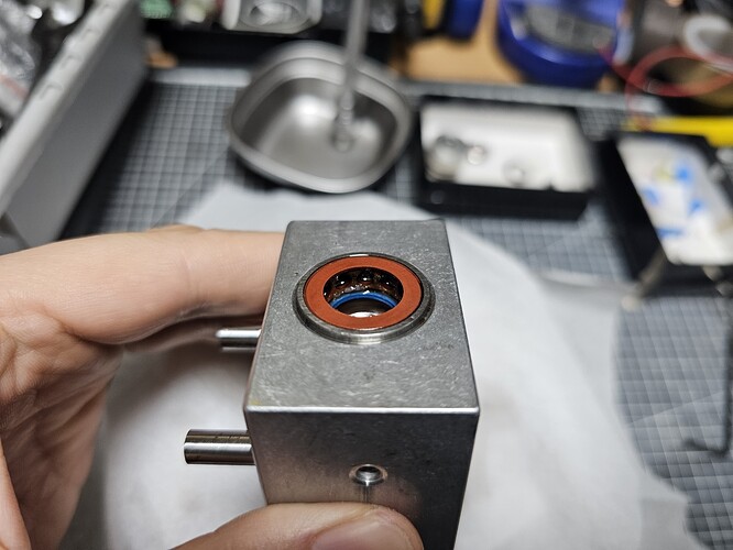

It contains OD-22mm, ID-8mm, and H-7mm bearings.
It usually comes out as a 608 bearing and is a non-contact type bearing with both sides blocked.

The top bearing on the round spindle is probably the same size. But I think there are two.
But the bottom bearing is different:
The 6000 series bearings we have at the bottom of the spindle are rated for several times more load than the ones in the prior generation
There are also new “labyrinth seals” so no more debris in the bearing hopefully.
