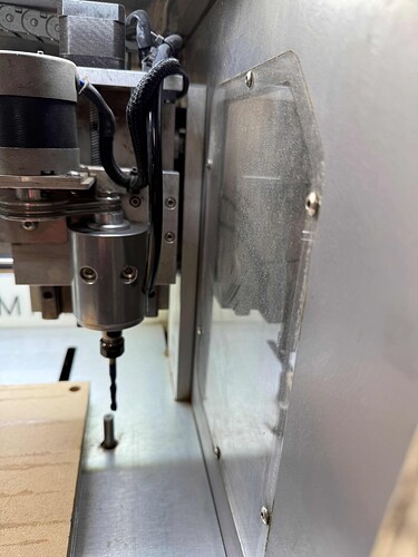

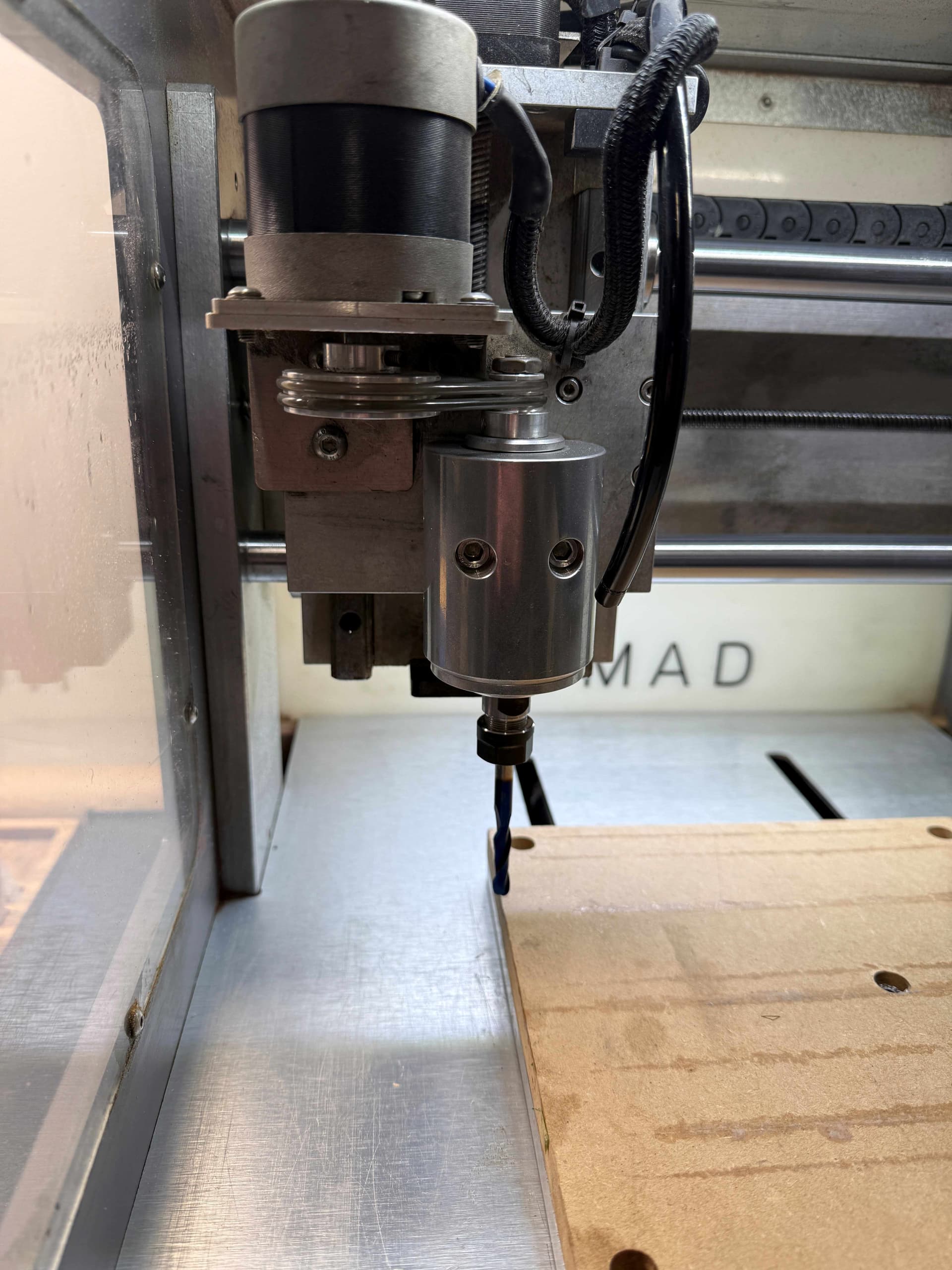

Can someone tell me if the x axis is correct as I can’t seem to go far enough left to clear the stock/spoilboard 8".

That’s like my Nomad 883 Pro, and they have the same working area — are you having difficulty with a cut?
I have never run into this issue before. The 1/4 inch end mill won’t go far enough left to zero, see pic. I’m just wondering if I’m missing something. I guess I could set the job origin tnero the right corner side, I just always use the left bottom corner.
Zero is to the center of the tool — how is that not far enough?
All good, thanks for the help.
To be fair, one may need to touch off on the left with a 1/4" probe and then add 1/8" to set zero X.
And my N3 does have enough travel to be able to do that which also just enough to allow tools to make a small lead in/out.
@68camino, has something changed on your machine to cause this? Is this a hard stop when moving the machine by hand (unpowered) or is it a changed limit as to how far the machine will move under power?
