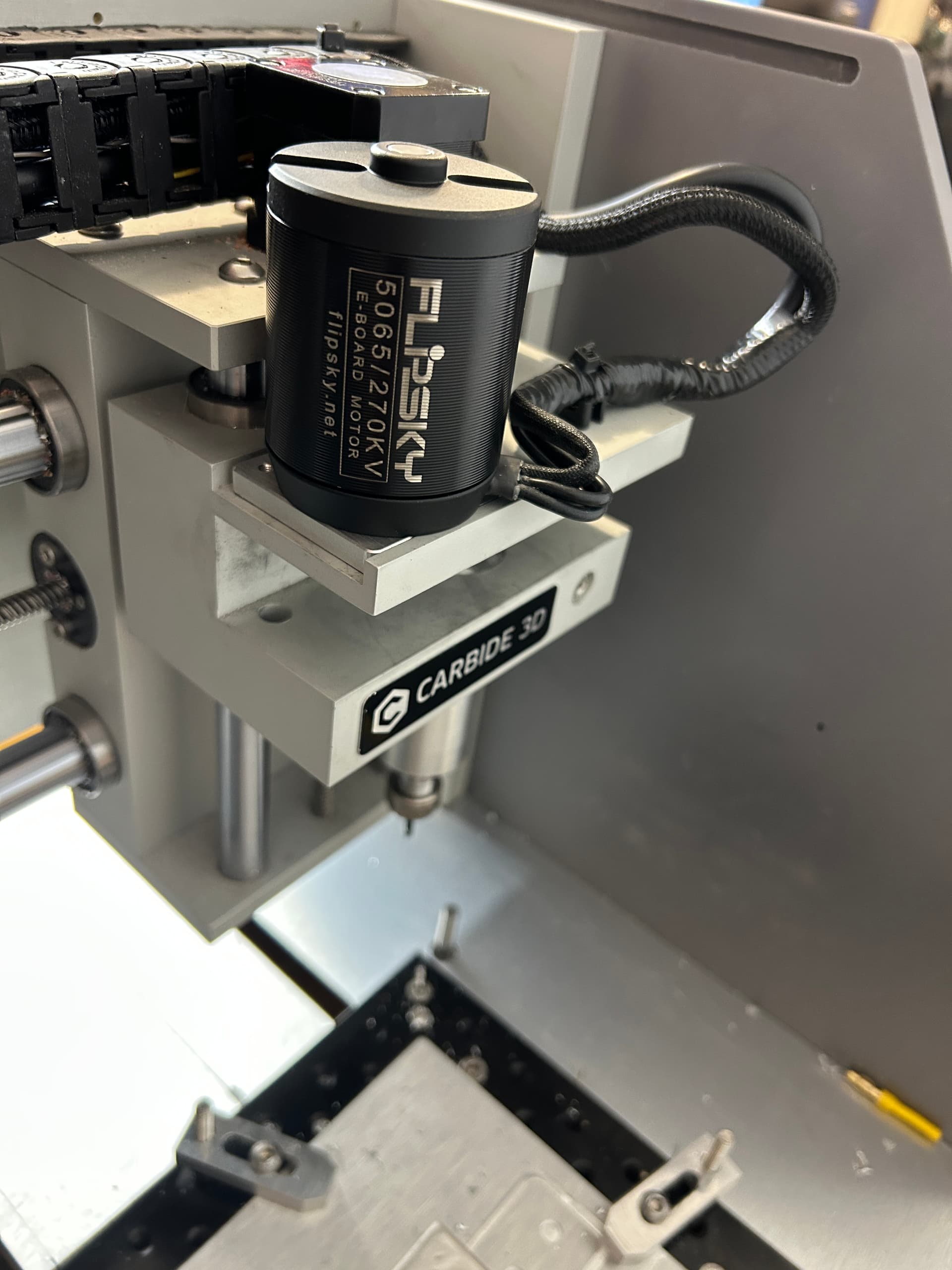

I think this might be the secret sauce the Nomad always needed to be a real CNC monster. Ditch the wimpy Nema 17 BLCD and put a REAL motor on it. I had a spike of 697 Watts measured at the outlet. Mind you that the power supply here only powers the spindle. 16,000 RPM measured with a laser tach.
Next upgrades are a 10mm spindle shaft and better motor driver. I think with a new set of pulleys and a belt, a c10-er11-150l collet chuck holder, 10.2mm ID x .8mm thick Bellevue washers, and some 62900zz bearings will be a drop in replacement for the 8mm spindle shaft. Hopefully it will allow for larger endmills to be used with less stickout too. These parts I believe will install into an unmodified stock spindle barrel, making it a drop in replacement.
I’m needing to replace the BLDC driver as well. Its currently got a BLCD-8015C driver that is interfaced directly to the original Carbide3d motion board through the original spindle driver socket. I have also added an external power supply dedicated to the spindle that has an adjustable voltage. Right now I’m limited to 36v due to the motor driver. I will be putting a either an Odrive or a VESC in its place, probably the VESC 6.7. This will require an Arduino/esp32 to convert the PWM duty cycle spindle speed signal to a PMM signal for the VESC to have accurate speed control.

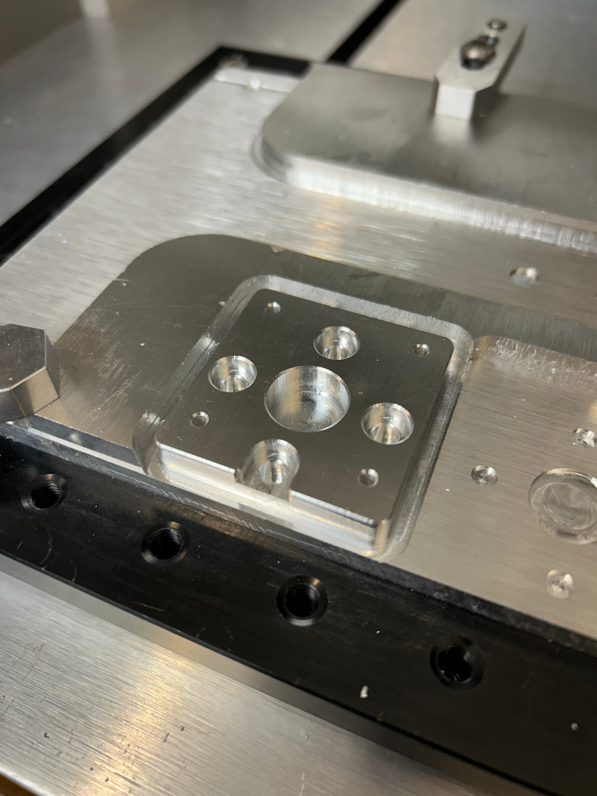

The motor is a Flipsky 5065 sensored outrunner. It has an 8mm shaft and I used the stock Nomad to mill out an adapter from 6mm aluminum plate. It currently has a 40t pulley on the motor and the stock 20t pulley on the spindle with a 150-2GT belt. The current setup is great if anyone chooses to use it. Overall, just with the motor upgrade the machine has been transformed. It does small intricate cuts better because of the higher RPM, and it has the power to really hog out material like no other desktop machine I’ve seen. It does require proper tool engagement and some adjustment of speeds and feeds to get a good cut, but once that stuff is figured out then its a solid upgrade.

Now, I do want to add that the BLDC-8015 driver is not working as expected, once I solve this part I’ll probably do a full writeup on how to perform the modifications with a complete parts list. I strongly discourage anyone from using that driver for now. Even though the PWM signal from the Carbide3d motion board is outputting the exact signal the motor driver expects, the driver seems to be limited by the pole count on the motor. There is a potentiometer that I messed with blindly to see what it did as a hail mary, and I did manage to get full speed, but that’s basically all it has right now. Leaving the factory GRBL parameters with $30=10000, that makes it easy to estimate the pwm duty cycle. Playing with that, I had the full 16000 rpm down to 90% duty cycle, then it suddenly dropped to 6000 rpm at 85%. 70% was something like 2000rpm. After doing some digging, its because the BLCD-8015C that I utilized is designed for a max of 6 poles, and I have a 14 pole motor. So I believe the better way to approach this is to use an Odrive. They also have an external power resistor that is used for braking that would help immensely. I believe this will get more RPM, more low speed torque, and a less noisy motor.
I did cut a part with the new motor though. If the tool loading is correct, it cuts like a champ. If its not, It has enough horsepower to chatter like never before :laughing:. I could visibly watch the 5mm endmill deflect enough that I know its a spindle rigidity issue. The 10mm upgrade will likely solve this. I also found the Z axis needs a different antilash lead screw nut. I’m working on finding a suitable replacement. If I can find one, it will be a solid upgrade for all 3 axis.
