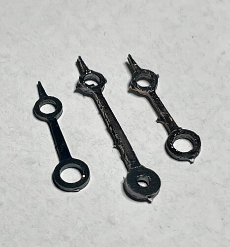

Hi All. Im a watchmaker using the Nomad Pro to make small watch parts. At the moment I am cutting watch hands out of CS95 carbon steel. The problem I’m facing is how quickly the quality of the finish degrades whilst machining multiple parts. The image below shows 3 hands that I have cut at once. The hand on the left is the first part to be machined and is beautifully sharp with minimal burrs/ imperfections and accurate dimensions. The other 2 hands have been cut afterwards.
The parts have been cut from 0.5mm CS95 steel that is spring hard. Im using a 0.7mm TiAlN coated carbide end mill. The steel sheet is 50 x 50mm and is superglued to a 6061 aluminium board that has been milled flat and checked with a dial test indicator for flatness. Once the steel sheet is superglued to the fixture I check for flatness again with the DTI. Each watch hand is 3mm by 10-15mm and takes approximately 10 mins to machine. All work is done using simple tool paths in carbide create. I run a pocket tool path for the holes and a contour tool path to cut out the hands. S&Fs are 0.05mm depth of cut, 75 mm/pm feedrate, 25mm/pm plunge, and spindle at 10k rpm. I use WD40 cutting fluid to aid the end mill, I usually do this by creating a dam out of putty around the parts, which gets filled with the cutting fluid.
It almost appears as if the end mill is wearing out after whilst cutting the first hand. Is there anything I can do to prolong the life of the end mill, and improve quality of subsequent cuts? I pay approx £10 per end mill, so that works out to £1 per minute in end mills!
I think the easiest solution would be to use a more machinable steel. CS95 is hardened spring steel. It’s going to eat cutters. Watch hands shouldn’t be subjected to any opposing force or wear, so hard spring steel isn’t necessary.

You’re exponentially making it harder (pun intended) by machining it in its hardened state. Specialty carbide cutters could be used to make it more bang for your buck but you’re going to be fighting a losing battle financially machining it in that state mostly due to rigidity. This rigidity can cause deflection which with other minor issues pile into chatter which is never great for cutters. Coatings can get you more life but TiAln is actually a bit of a special coating as it requires heat and force in order to perform it’s intended purpose. Coolant actually works against that and so you are actually working against it in a secondary factor. Personally I think TiAln just isn’t a very suitable coating for hobby grade machines.
If I were you I’d do several runs if you can afford it comparing with your coolant run and pushing your feeds and speeds to their limits as well just to see how much time you can get out of each cutter. If you plan on exclusively using these cutters for a long time it may be worth your while. Try it hardened vs annealed as well and see where you end up in terms of how long it lasts. Remember to keep your variables at a minimum so you’re only testing what you want to test.
Edit: I also see you’re using CC for this so you will want to make sure you’re using every trick you can to trochoidal mill, climb mill, ramp in, and avoid engaging 100% of your cutters diameter when possible. Climb milling usually when you want to put more heat into the tool would be minorly problematic but in the case of a hobby mill I’d guess it’s going to save you more tool life.

silver is gummy in general even when hardened imo and is more likely to gall and embed itself and chipweld etc. Steel is more likely to just beat the everloving hell out of the cutter. What specific cutters are you using?
Airblast is very important for running AlTin as recutting of any kind is always bad. That without the cutting fluid should improve things quite a bit.
The way you are running coolant with AlTin is rough because in order for it to get up to temperature it needs a way to build heat and the coolant is taking all of that heat. So essentially what you’re left with is a cutter that is less sharp than an uncoated cutter and performing quite a bit worse which explains the 10 minute tool life.

Hey after some experimenting in A36 I wanted to come back and say get 4 flute endmills for this, I had great success with just airblast on AlTin 1/4" endmill (the harder slicker brother of TiAln) at .0007 IPT at 12000 RPM 32ipm ran for 6 minutes and the wear seems very light. No coolant no mist still has AlTin on the cutting edges that weren’t already wrecked.
Given that this is around 700 SFM and steel desires far far less the tool wear should be much more but isn’t so who can complain.

You were running a .0001 IPT I’d bump that up to .0005 and your IPM to 12 or about 312mm/m ramp entry should be 2 degrees I like to plunge at about feedrate/2.5
If you pick up the tool I reccomended change to 24IPM or 624mm/m
The depth of cut you could mess with but I was doing .003" you are doing .0197" and I suspect that might be part of your issue as we are only so rigid. I would half what you’re doing now as a starting point given that you have a more rigid machine than I.
These settings should give you about 100sfm which is a good starting point to try different options with.
