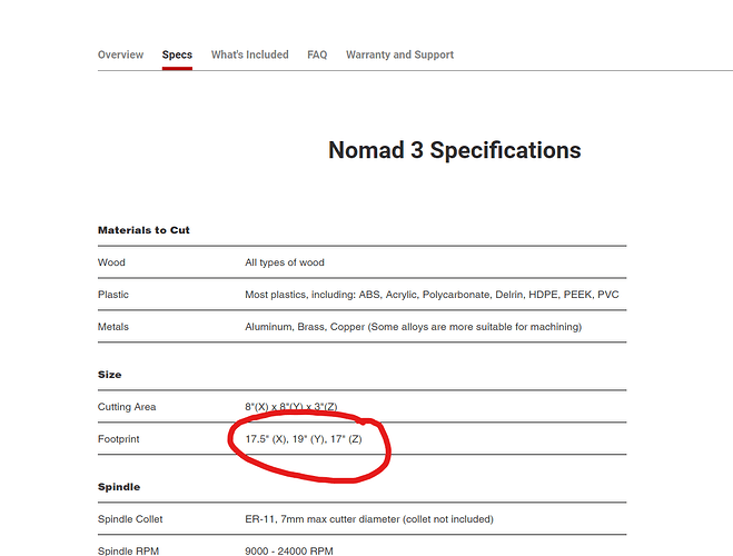

I’m buying a enclosure for my nomad 3, what are the dimensions of the nomad 3 so I can know if it fits for my machine
The specs on the page are safe to reference. The machine is actually a couple mm smaller in all dimensions, we rounded up.
Do note however that you’re gonna need room on the right side for USB/Power cables to come out of the machine, and you’ll need space above for the machine’s door to open.
