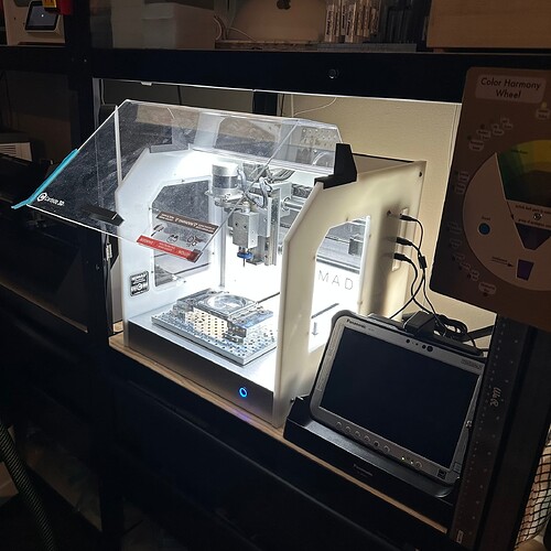

First, the Nomad’s footprint is is quite adequate, this is all the space I have for it:
I simply can’t afford to have a shop space. Don’t take me wrong, I’d love to and I enjoy looking at some of your amazing shop spaces in your Garages or anywhere else, I simply can’t have that luxury, at least not for now, so the only real candidate I have, is the Nomad, so I had to make it work.
