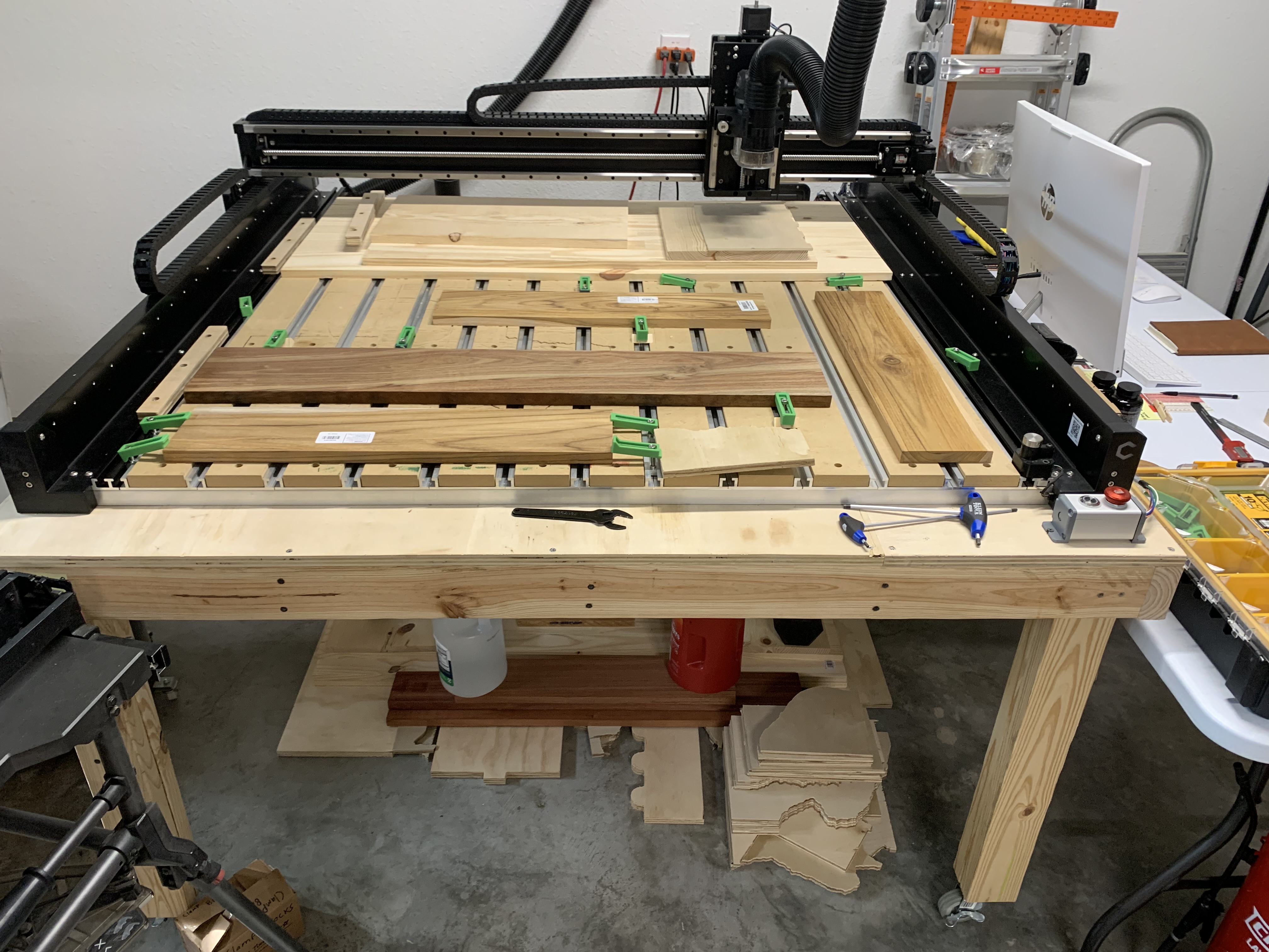

Those plastic top tables will not work for such a heavy machine as the SO5. Some people have built their own out of 2x4 or 2x6 and others have bought the Rockler and Kreg ones that bolt together. As @WillAdams indicated those just are too unstable for such a heavy machine with a lot of momentum moving around on top. Another source is openbuilds.com if you want to build a custom table and/or enclosure out of extruded aluminum .
You need a rock solid table for success. It does not matter if you buy or build your table it is a good idea to have 2 way locking casters. The reason for the casters is to make the machine portable for cleaning and maintenance or if you decide to do tiling. Once your machine is planted on a substantial table without casters it will never be moved. That can be a real problem for maintenance and for tiling options.

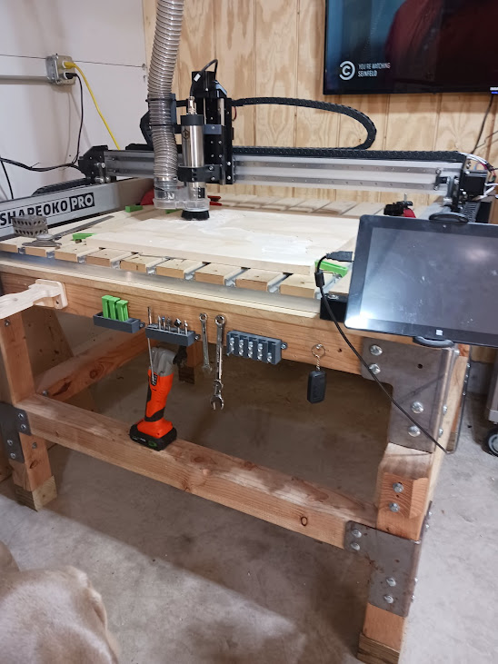

i use 4 x 4 from lumber yard and premade brackets 3/16 thick, amazon. SUPER SOLID

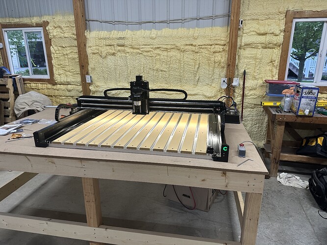

am fortunate enough to have space in my shop to do an 8 foot table. I did 4 x 4 legs and 2 x 6 joining braces. The top is three-quarter inch MDF.
Tables very solid. No vibration. I like having the space on each side of the CNC for my computer in bits.
