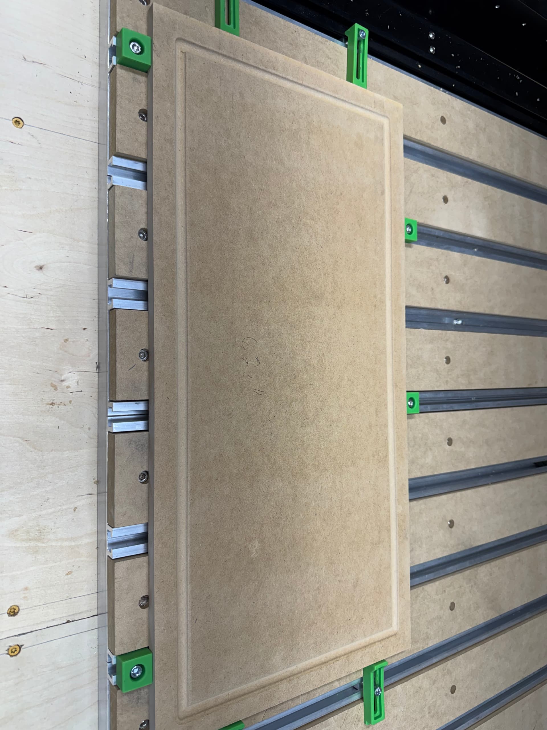

Not sure where I'm going wrong here - Juice groove

Both of the pictures you posted look like the groove is square / aligned with the workpiece.
It’s possible the axes are not calibrated to actual size. That’s why I asked to measure the groove rather than the distance from the edge. Your vector is 11.25 x 15.75. If you’re cutting on the vector with a 1/4" tool, the outside dimension of the groove should be 11.5 x 16.
Be careful with the files/dimensions. OP has posted a file with the same name twice but the files differ by dimensions/tools, etc. This is when I open them in V7.
I agree with Tod1d that the issue is not related to squareness. However, I doubt it is some type of machine calibration issue. If it were, both of the juice grooves would be offset by the same dimension (unless the machine calibration was tweaked between cuts :cry:).

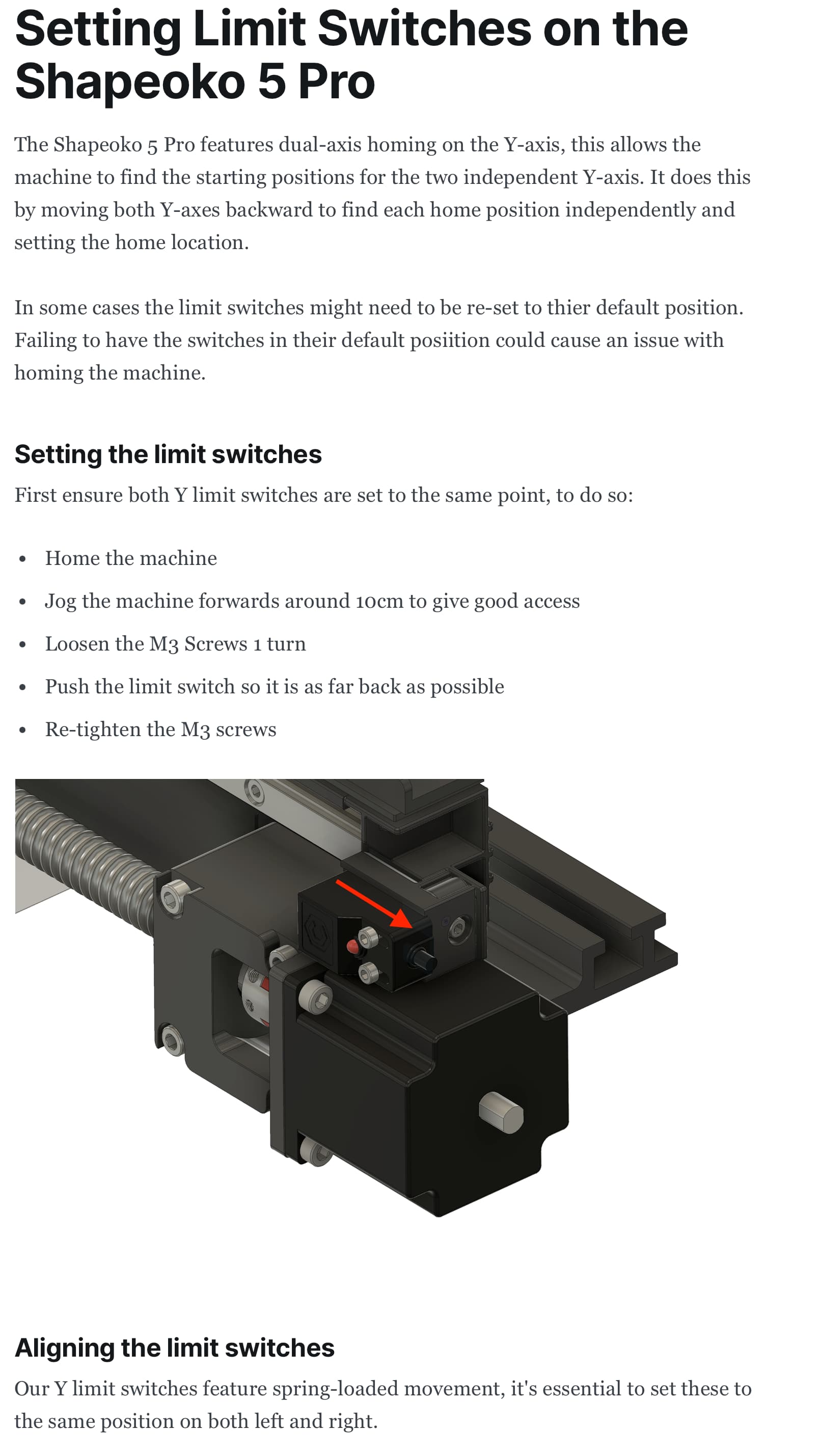

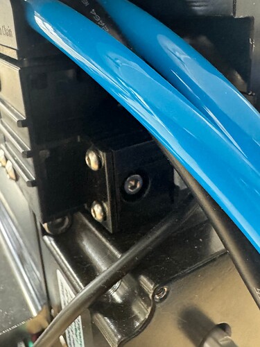

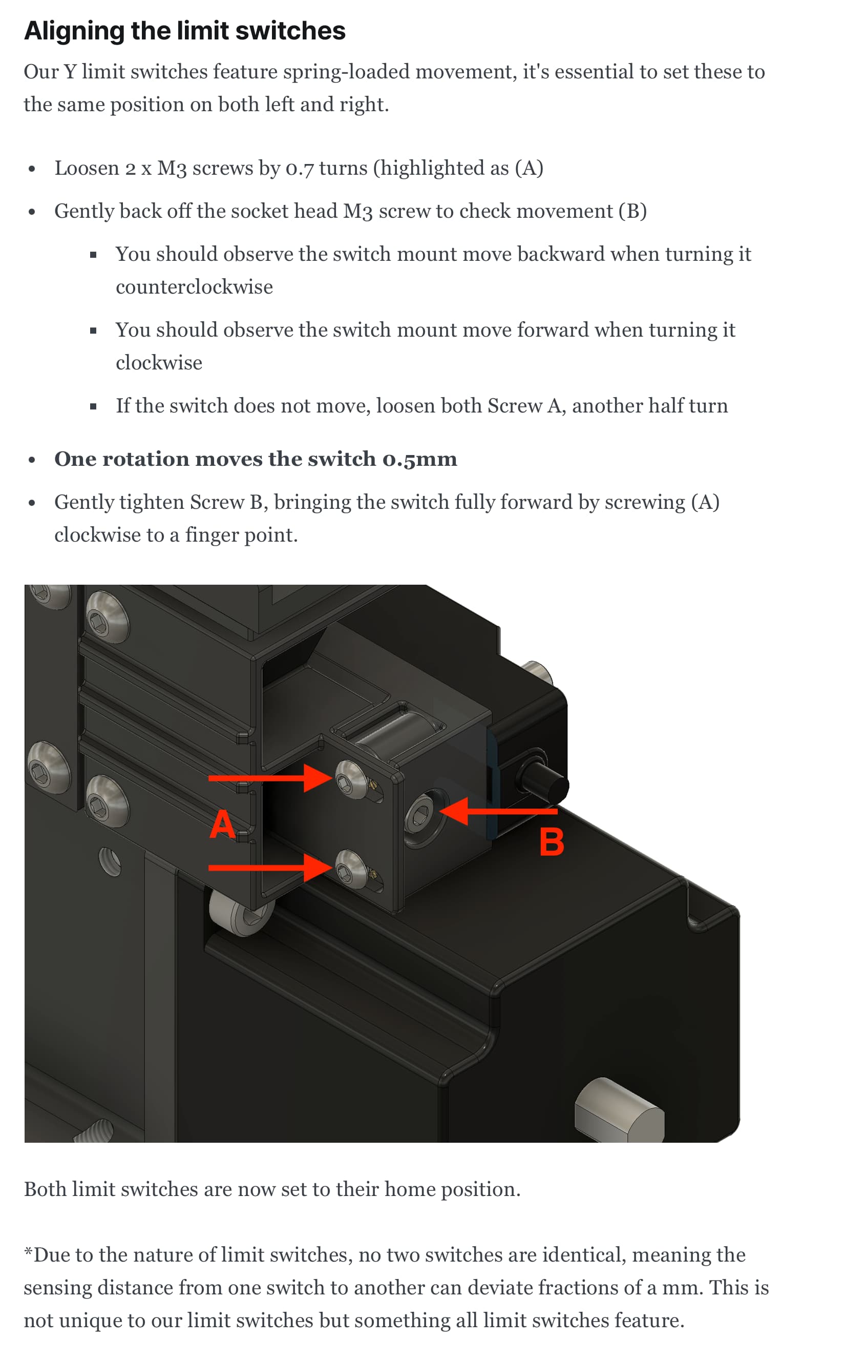

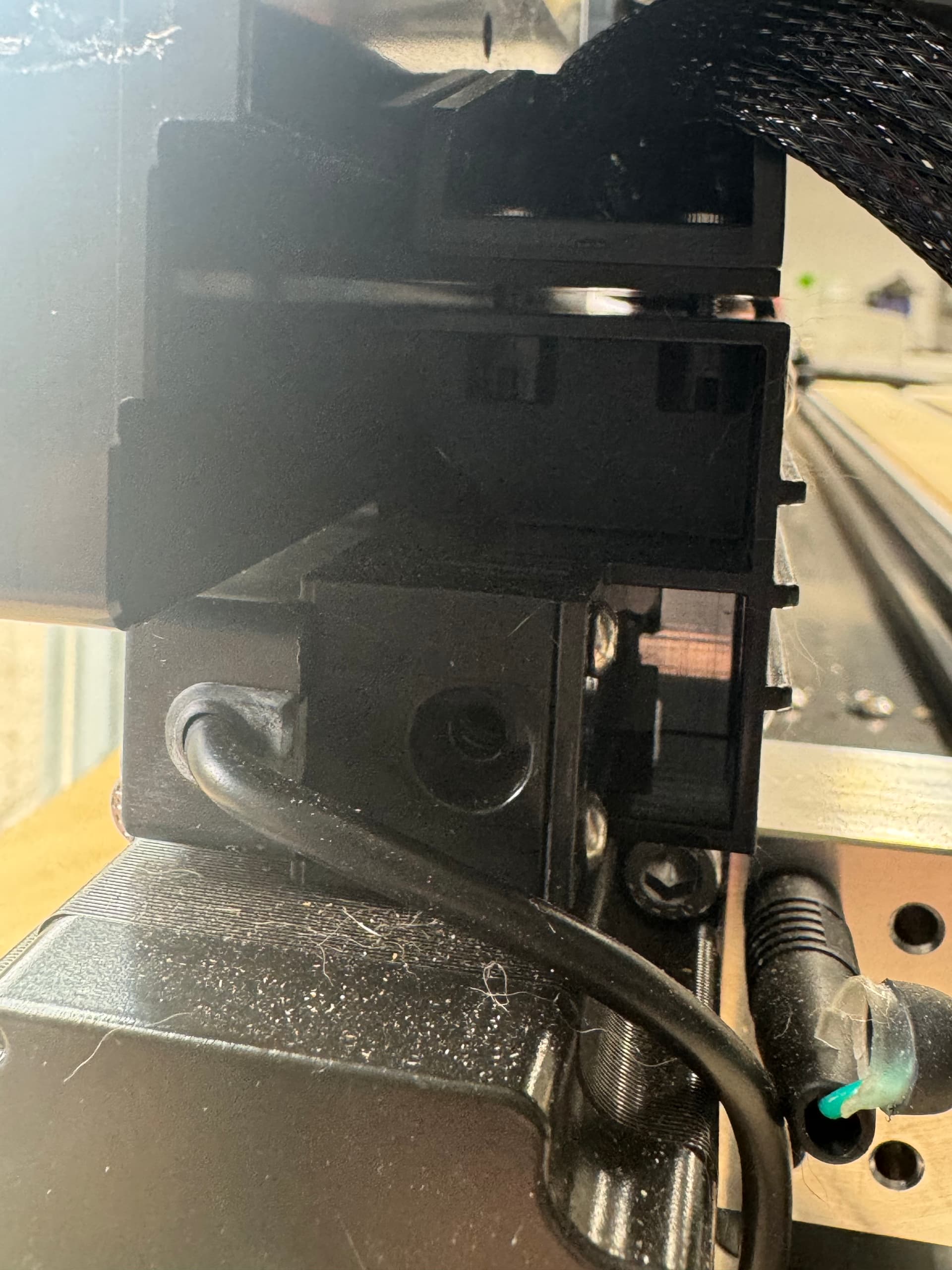

ok I think I have figured out what happened here. I was working with Fleming over @ support. I have to say, I know they are very busy over there but Carbide support is awesome and while recently it is taking time to respond, they do respond and are very helpful. It appears my issue is that the right side of the machine, the Y-axis limiter maybe faulty or a screw popped out. see picture attached comparing left and righ y-axis limiter. Luckily, last year during unboxing, I came upon a long screw that I couldn’t figure out where it fell from. I saved it and it just so happens this is the spot where it fell out from. I adjusted the y-axis limiter based on the instructions that Fleming sent to me (attaching it here too in case someone will have the same issue in the future).
I ran another cut while not completely perfect it is acceptable for my needs. all 3 sides where very close to one another with the left side of the cut slighty larger (I could attribute that to my measurement of the stock not being entirely precise during my test cut) It does pass my eye test however…
