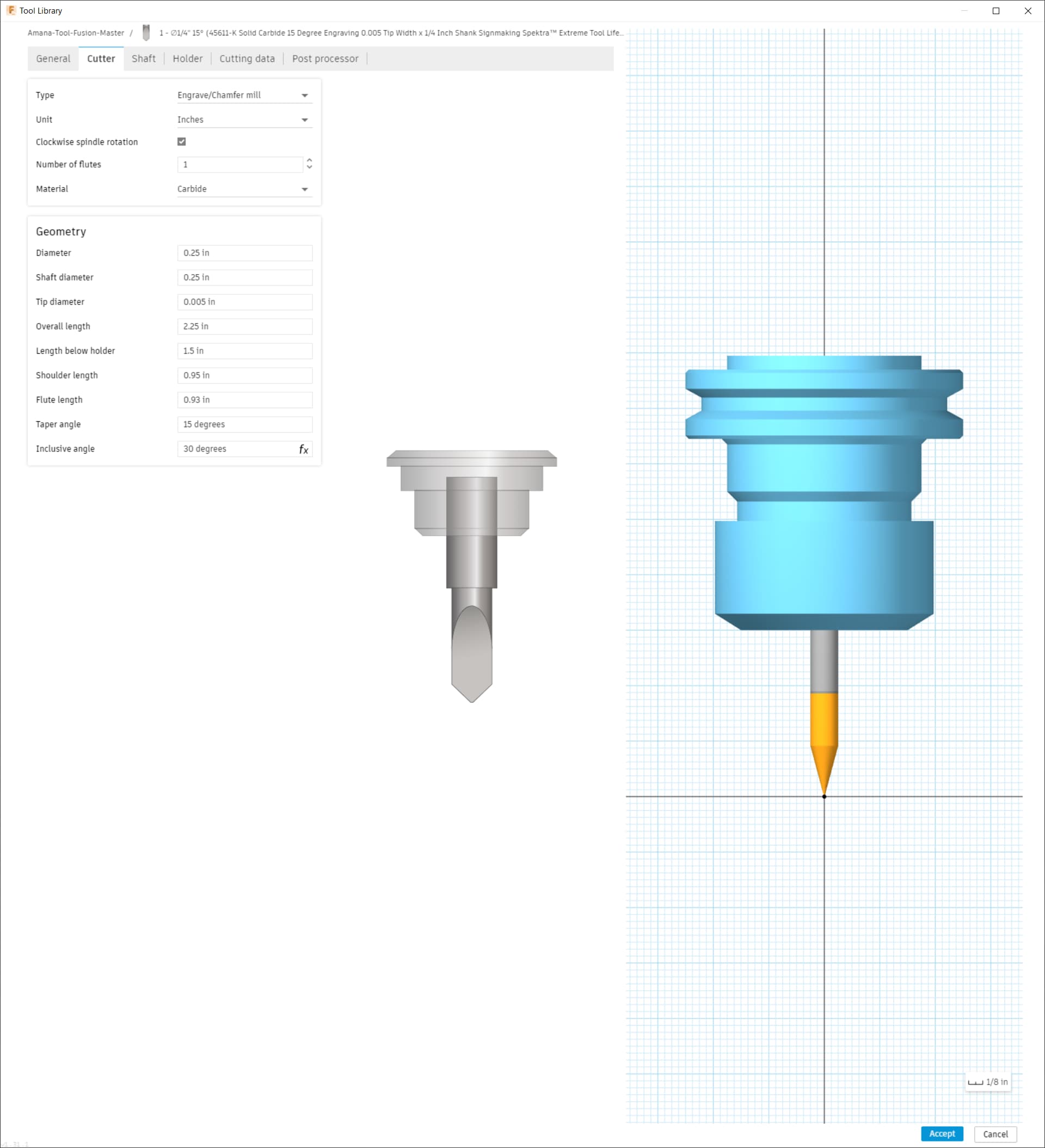

Hello, I’m hoping to attempt my first inlay tomorrow. First though, I need to add this 15degree v-bit. I’ve gotten to the point of entering the numbers.
Can anybody tell me the numbers - or where to find them - for:
Plungerate
Feedrate
RPM
Depth
I’ve downloaded the Amana PDF, but I’m not experienced enough to know what to do with the info there.

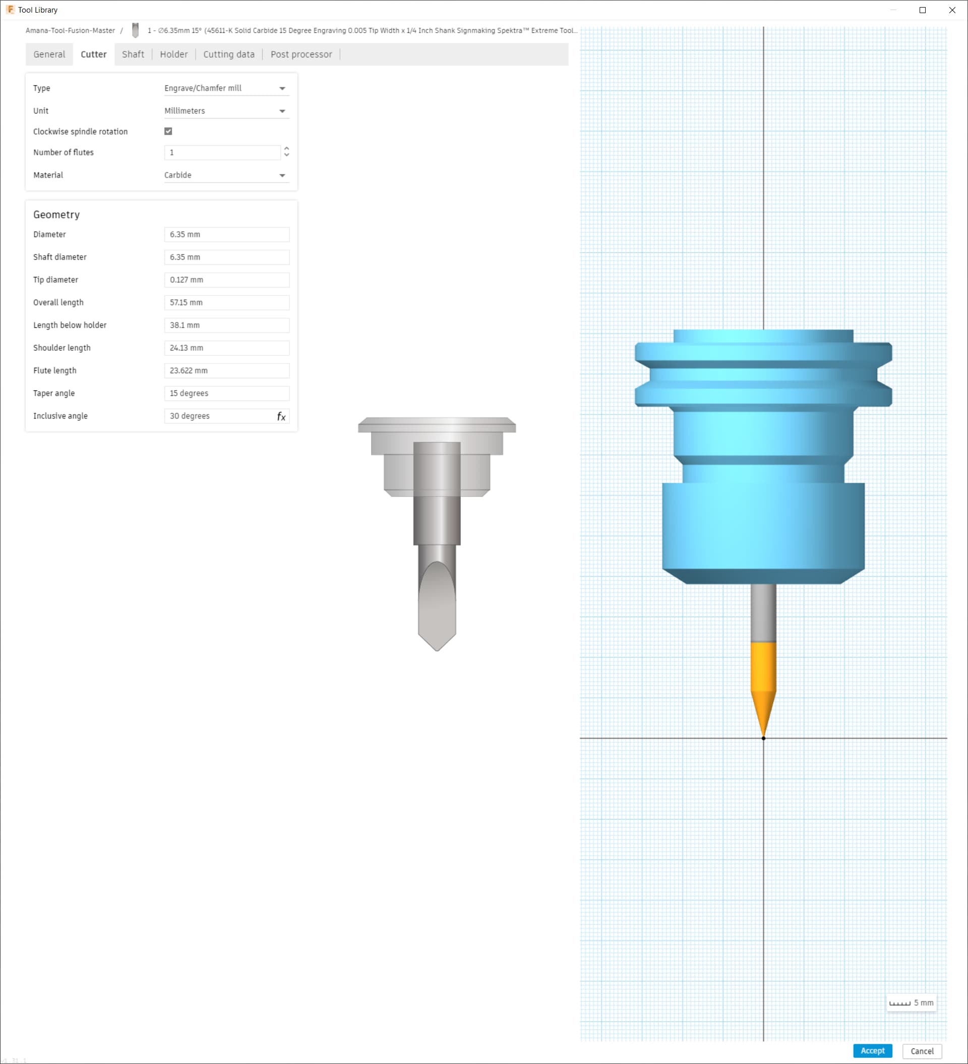

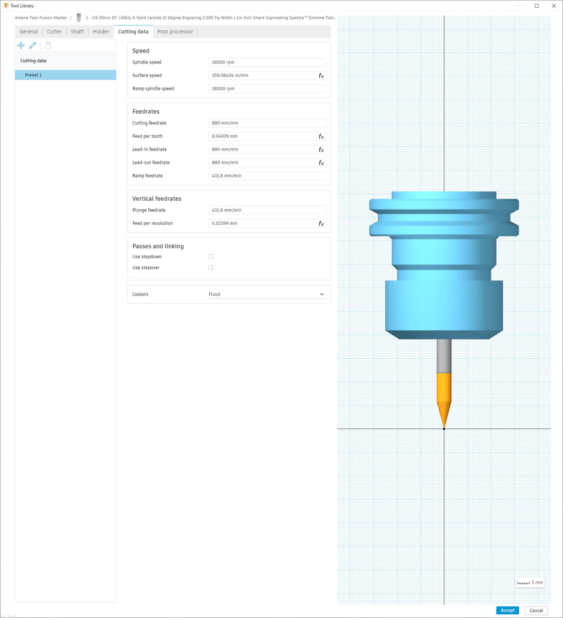

Downloaded the .tool file from the Amana website for Fusion 360 and this is the info they have for this tool (Imperial and Metric)
IMPERIAL
METRIC

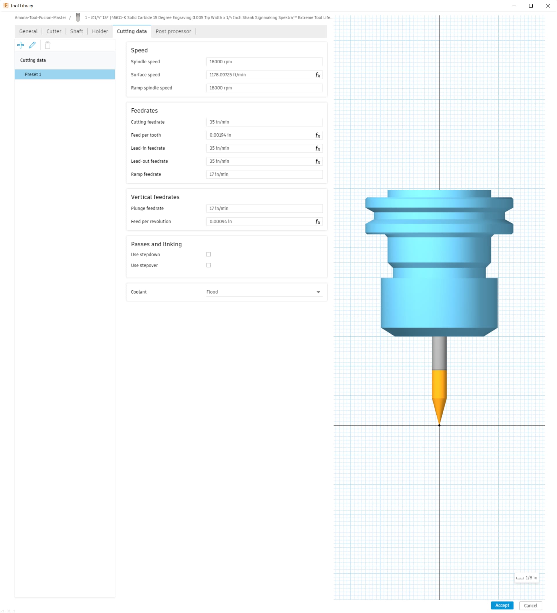

I’m using Carbide3D. Based on the info you shared, it looks like:
PlungeRate = 17 in/min
FeedRate = 35 in/min
RPM = 18000
Depth = ? (can’t seem to find a correlating number in the info)
