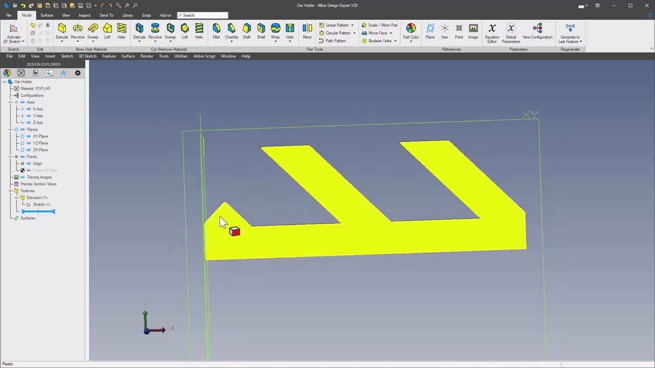

You have to be careful with pockets and In/outside line selection. If you have pocket in a pocket area it will reverse the in/out convention you select. I had a time with this and the realized I had to ungroup several different vectors to set the tool path to the needed in/outside and regroup them.
I did the ungroup and the inside/outside worked as anticipated. Strange it would do that. Is that an issue with the software?
Groups are considered as a whole for toolpaths.
Another lesson learned. thanks.
Glad you got it straightened out.
